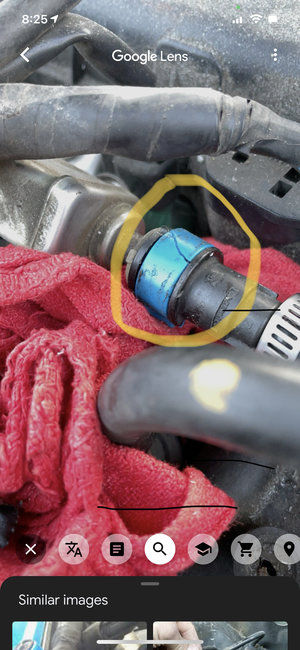

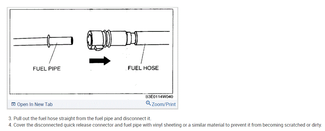

Broken injector rail fuel line clip
2004 MAZDA 3
194,000 MILES • 2.3L • 4 CYL • 2WD • AUTOMATIC
METOOSSTTOO
What is this clip referred to as?
Mar 22, 2021 at 8:55 PM
  • 110,194 POSTS

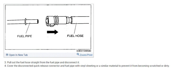

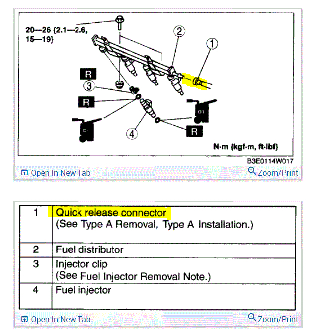

I believe that is a pic of the quick release. Do me a favor. Take a look at the pic below and let me know if that is where the part is located.

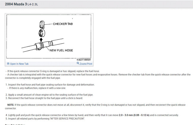

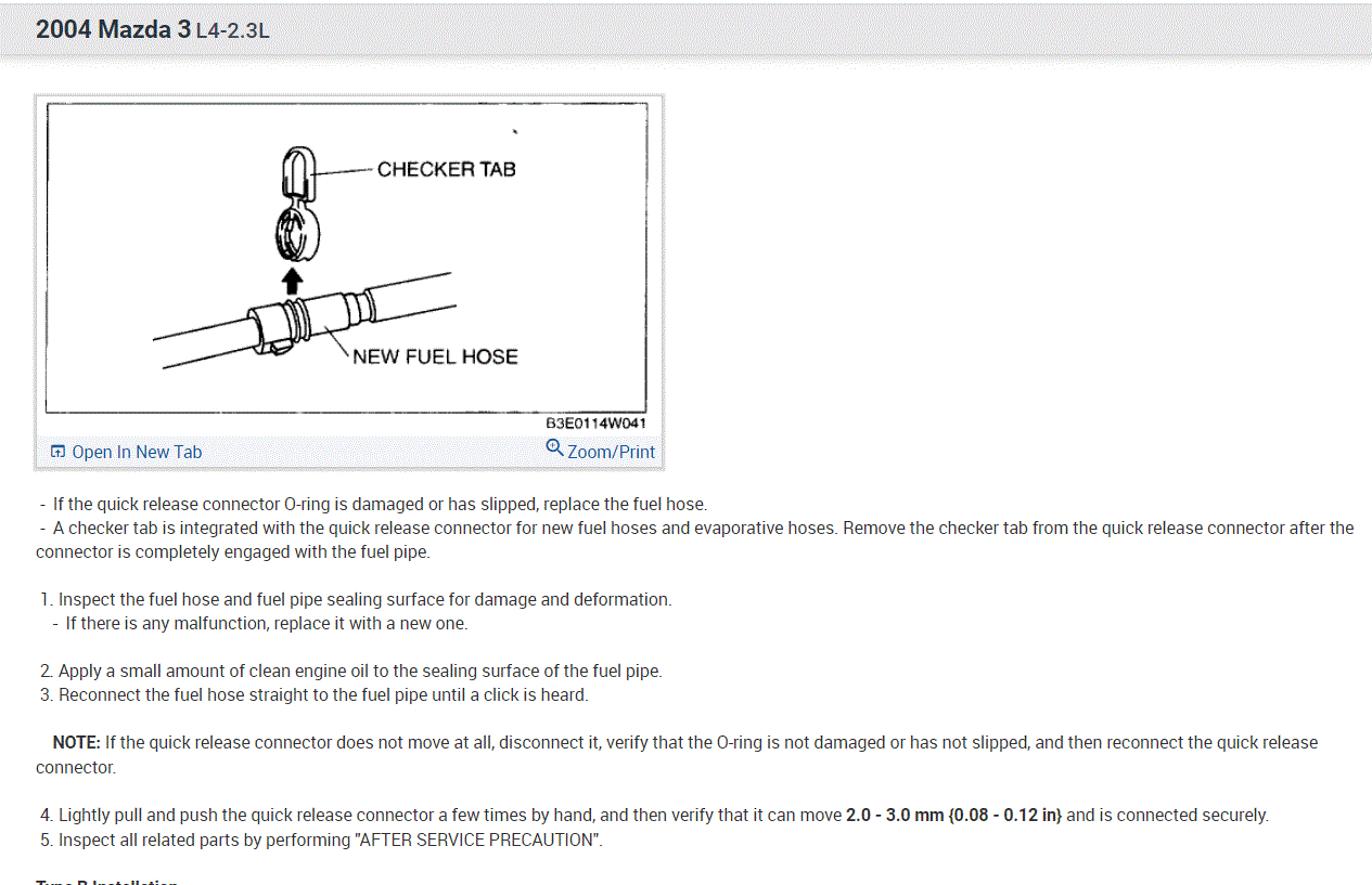

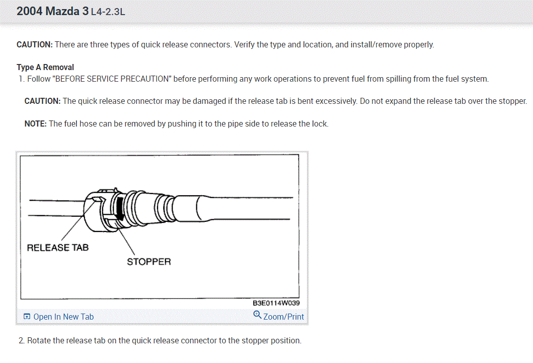

If you look at pics 2, 3, and 4, they show how the connector is disconnected and then reconnected.
I have to be honest, I have a feeling you will need to purchase a new fuel line and replace it. I don't think that connector can be replaced by itself.
