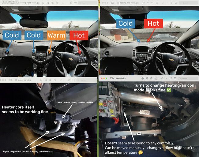

I changed the thermostat again and repaired the thermostat gasket properly but that didn't seem to achieve anything.
I also changed the heater matrix / heater core for a brand new one and this has definitely made an improvement. :)
Hot coolant is definitely getting into the heater core, and I am getting some hot air coming through into the cabin (which is good!) but the car's heating is still acting a bit strange...
The heating still takes quite a while to get going and is only warm (rather than hot).
Additionally, this warm air only comes out on the driver's side!
The air coming out of the passenger's side is cold.
I also have to drive the car pretty hard for the warm air that does come out to increase in temperature.
Driving more slowly will usually see a reduction in temperature again.
So, I think there are 2 or 3 issues:
1. The passenger's side still blows cold air with the heating on.

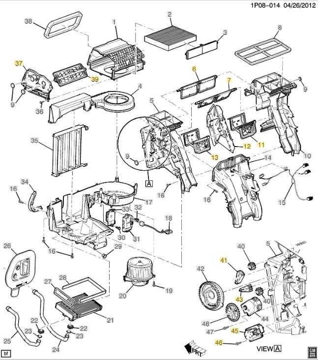

I wonder if this could be a broken blend door. When removing interior panels to gain access to the heater core, I did see a couple of loose pieces of broken plastic so that could be the issue?
2. The warm/hot air that does come out the driver's side is still pretty weak and very dependent on driving style.
3. I'm still not sure that the thermostat is completely fixed as the coolant takes quite a while to warm up.

So, it does sound like either a broken blend door or an actuator. Could be both.
It depends too on the heating controls. Some are automatic, some are manual. Automatic could indicate an issue with the control unit itself. Manual controls and the fact that you saw some broken pieces of plastic, I would bet more on the doors. I would replace the actuator and the door at the same time. Dorman isn't a bad brand to use.

The heating control is manual - so this also points towards the doors being broken. Now I think about it, when I first purchased the car, the central left cabin-facing air vent was stuck hard in a fixed position. I had to force this out of position to get it to move and this could have broken blend doors further down inside the HVAC plastic routing???
The car still seems to be acting as if the thermostat is stuck open...
1) Coolant takes a very long time to warm up.
2) Hot air in the cabin is warm more than hot.
3) Heating only gets hotter when driving fast for long durations.
4) Heating cools down again if stuck in traffic or driving slower.
However, the thermostat has been changed twice and it still behaves in the same way.
Is it possible that there could be an issue with the thermostat housing and surrounding pipes rather than the thermostat itself which could still make the car behave in the same way as if the thermostat was open/defective?
Even though the coolant temperature takes a long time to rise, it does get to the correct level (just below halfway on the gauge) and it does manage to stay at exactly that point - even if the cabin heating starts to cool again.
So, the engine itself is probably operating at the right temperature - it's just the internal cabin heating that suffers.
The original thermostat I removed was rated at 89 degrees.
The replacements I have tried are also all rated to 89 degrees, but they are all slightly different shapes and lengths - but they were all advertised as able to fit the vehicle.
I also checked the air conditioning on cold and that works absolutely fine across all vents - gets very cold so no problems there - the only problem is the heating.
When the coolant temperature warms up, the main engine fan does come on without any problems. A couple of times recently, the fan has continued running once the car is turned off - as if it's overheated - even though the cabin heating is weak - but it's only done that a couple of times.
I've also plugged in a pretty basic OBD2 scanner but it's not reporting any codes.
I've also attached some photos if that helps.
Thanks again.
Chris

As far as the HVAC system there is many valves and doors because of the dual climate control. There is a separate blend door for each side. I added a picture, but this is from a 1.8L GAS. The system should be fairly close though.
I noticed your vehicle is a right-hand drive in your pictures. Is this vehicle from the U.S.?

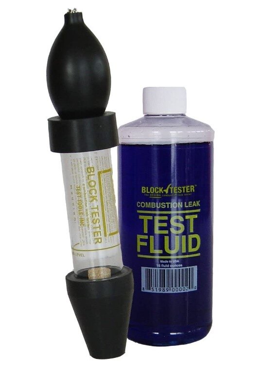

To use the block check liquid put it on the top of the coolant reservoir after filling it to the line with the fluid. Squeeze the ball over and over while the engine heats up. Makes sure the coolant doesn't go into the test kit, you may have to remove some coolant to perform this test. If there are nitrogen oxides present it will change color to either yellow or green. If it changes color, I would say it is the head being cracked or a blown head gasket.
