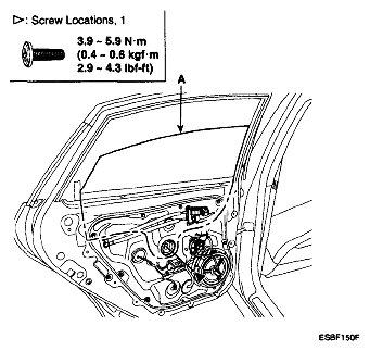

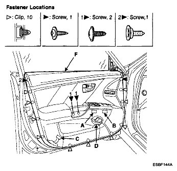

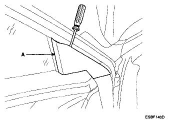

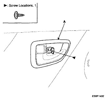

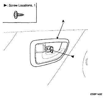

Sounds like the latch trip spring has broken.
Not that hard. Remove the upper trim, remove the screws, disconnect the wiring and pull to disengage the clips. Screw and clip locations in the pictures. Remove the vapor barrier by gently pulling on it and using a razor to cut the sealant.
Release the clips on the rods to the latch and pull the rods loose. Unbolt the latch, reverse to reinstall.
I have repaired latches broken this way by stripping them down, cleaning and replacing the broken spring(s). Not as easy as it sounds but it works.

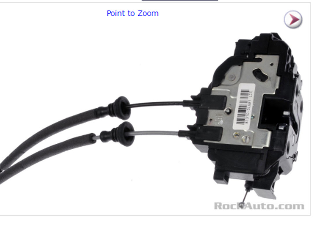

The part that is broken is the actual latch. The actuator is part of it so they may sell the replacement as the actuator as that may be the most common failure part. (Yep, just looked and they sell the complete latch as an actuator) Just be sure to get the one you need. Looks like there is a build date item in the notes.

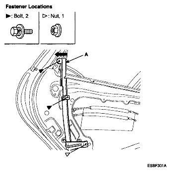

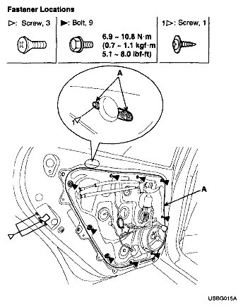

Steve you have been very helpful. I took the door panel off. Once I got the panel off there is a metal plate with like 8 or 10 bolts. After removing those bolts the metal panel still will not come off. I Googled the process and they said there was a rubber plug where you had to take a Phillips head screw out of the rail where the window mounts. I took out the screw but couldn't lift the window out of the track. The site said to stick a screwdriver in the hole where the Phillips group came out right away from the window while also lifting on the window. I got pretty scared that I was going to break something. Anyway I still haven't gotten it apart. Do you know if a Haynes manual would go through this procedure

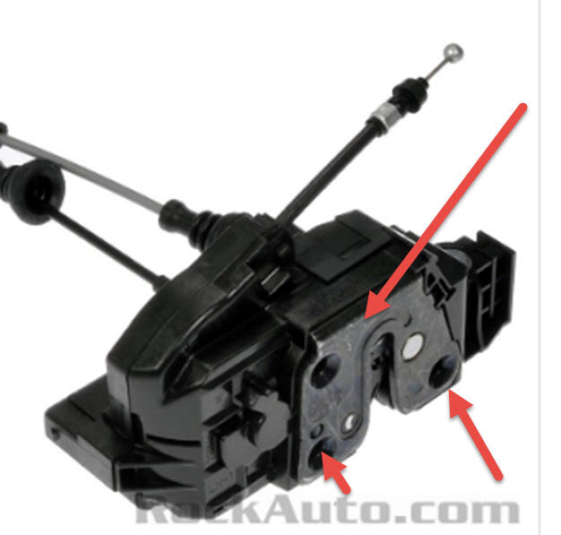

pictured is the door latch actuator made by dorman which is whole assembly it's around $90 from rock auto .com.see pics for 3 screws to remove actuator door has to be open for access.

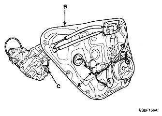

You have the correct info. You remove the plastic door panel. Then the inner module comes off with a bit of "fiddling" to release the positioning tabs. Then you remove the glass (1 screw secures the glass to the regulator, access is in the middle of the module. to get to the outer handle to disengage it. Then unbolt the latch from the door and pull the entire panel out with the window regulator and latch all attached. Sort of like some of the Fords with the integrated units. Then you can replace the actual part. Then reverse the process to put it back.
