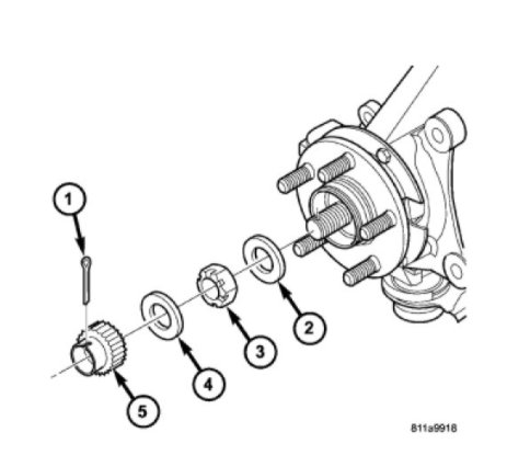

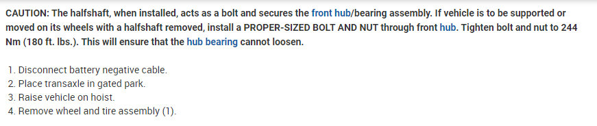

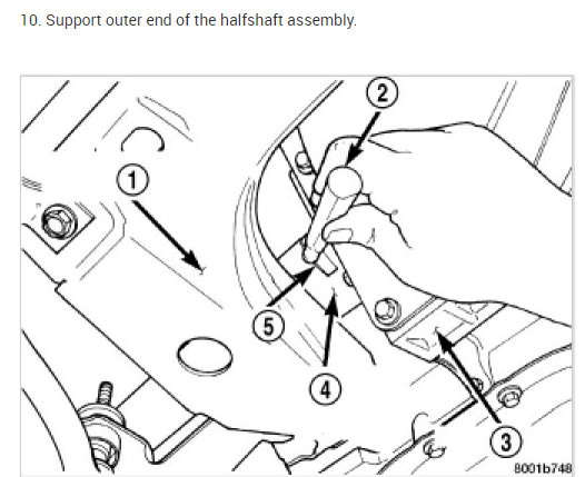

DANNY L
  • 5,648 POSTS

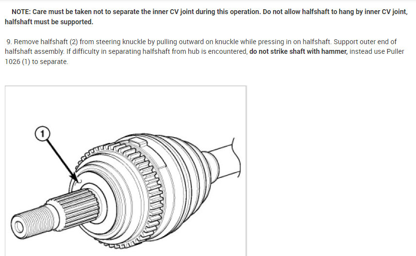

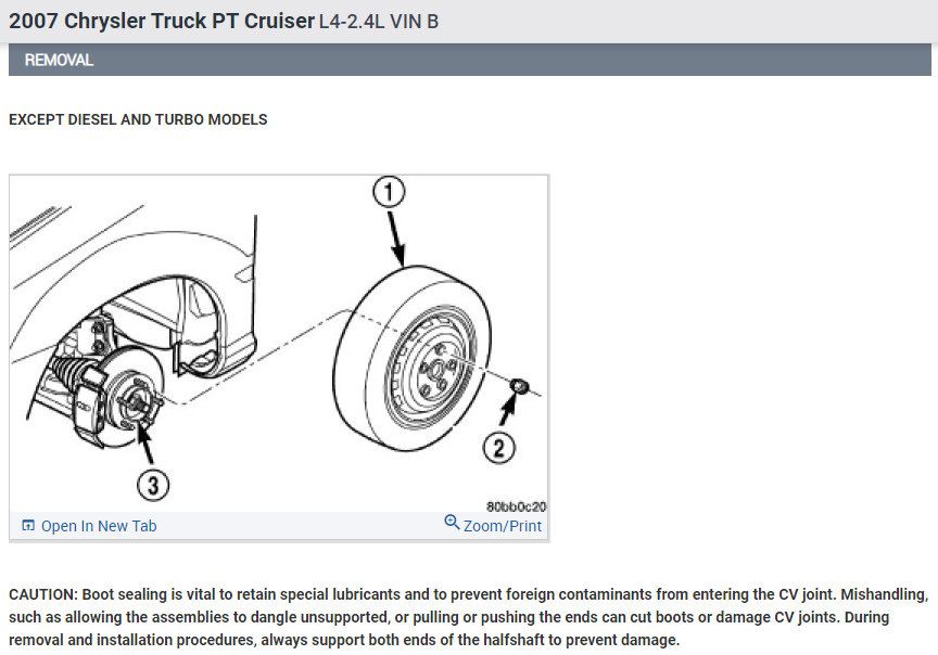

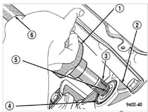

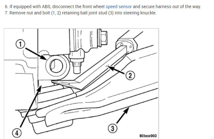

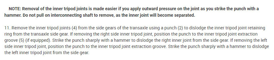

Hello, I'm Danny.

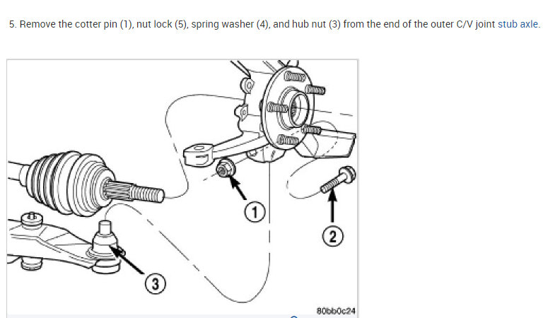

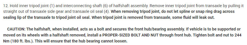

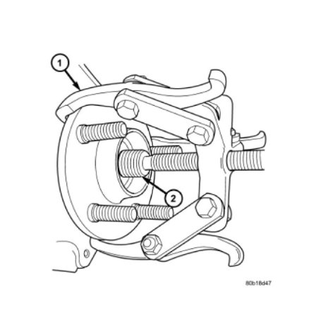

Here is the information you requested. Here is a tutorial showing how to change a cv-drive axle:
https://www.2carpros.com/articles/replace-cv-axle
I've attached picture steps below ion how to change the ccv-axle drive axle on your car. Hope this helps and thanks for using 2CarPros.

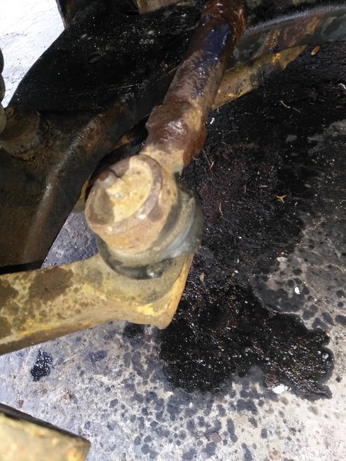

WILLIE26
  • 26 POSTS

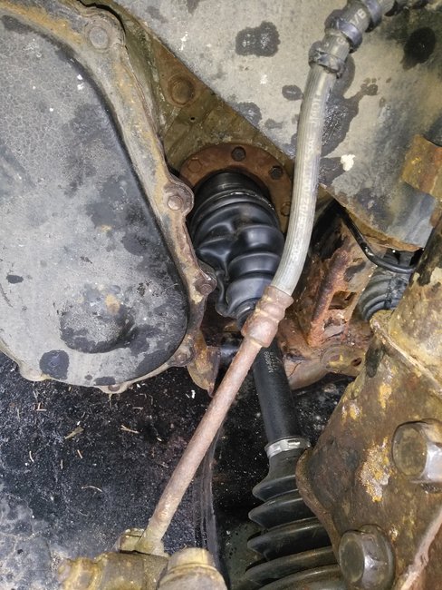

Hello thanks a lot sir. I do appreciate it. i have installed the new shaft. Took me forever getting the other one out. I had to build a tool along with using a slide hammer. And i do not have access to a hoist. I am pretty nervous to test vehicle and see at this point lbs. Because i called and searched high and low and no one was able to give me answers as to why CV axle broke in the first place. So i figured to check everything carefully as far as my whole suspension. Turns out i need to change tie rod end, lower ball joint could use a new one, and have to do an alignment. I knew i needed a alignment because my steering wheel was pretty crooked. But will post a a few pictures.

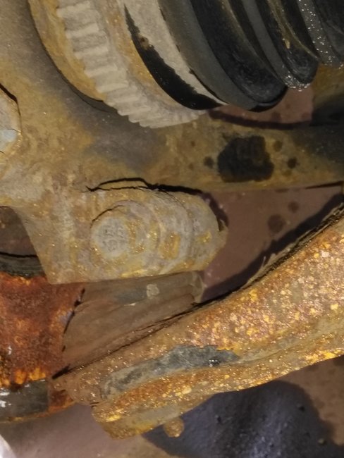

WILLIE26
  • 26 POSTS
Picture of new CV axle installed as of now, picture of old tie rod end. I have replaced since this photo as of yesterday, and last picture is of lower ball joint screw that seems to be stripped and kind of rounding off. Not allowing me to remove ball joint to replace it. Any help on stripped or rounded off nut removal? Or alignment to at least get it safe enough to go get alignment done professionally?

WILLIE26
  • 26 POSTS
Outer tie rod castle nut (original nut) or new nut that came with new tie rod end is just spinning screw and nut while i try to tighten nut to tie rod end. Any suggestions?

MHPAUTOS
  • 31,937 POSTS
Put a little weight on the tie rod end with a jack not enough to lift the car just enough to seat the tapered bolt and lock it while you do it up.

WILLIE26
  • 26 POSTS
MHPAUTOS hello sir, my tie rod end is actually on top off knuckle. So the stem from tie rod is on the bottom facing the ground. I cannot place a jack on tie rod end because it would only hit the stem!

MHPAUTOS
  • 31,937 POSTS
You will be bettor of replacing the tie rod with a new one, sounds as if the one fitted may be a problem. see picture regards alignment information.
