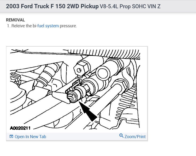

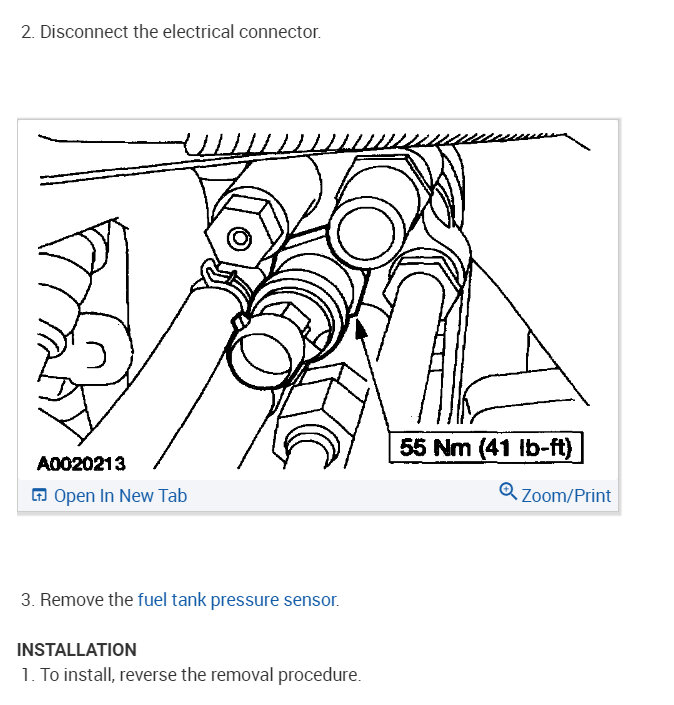

Can my truck crank up without the fuel tank pressure sensor?
Oct 6, 2022 at 12:35 AM
  • 55,808 POSTS
Yep, it will run without the fuel tank pressure sensor. if you want to replace it, here is how in the images below. Please let us know if you need anything else to get the problem fixed.

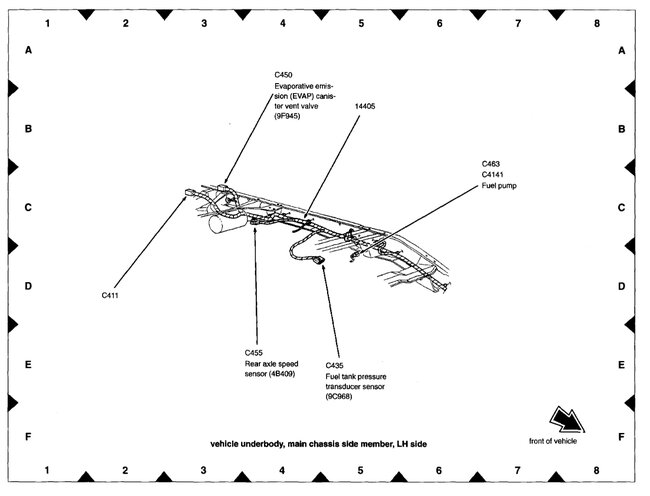

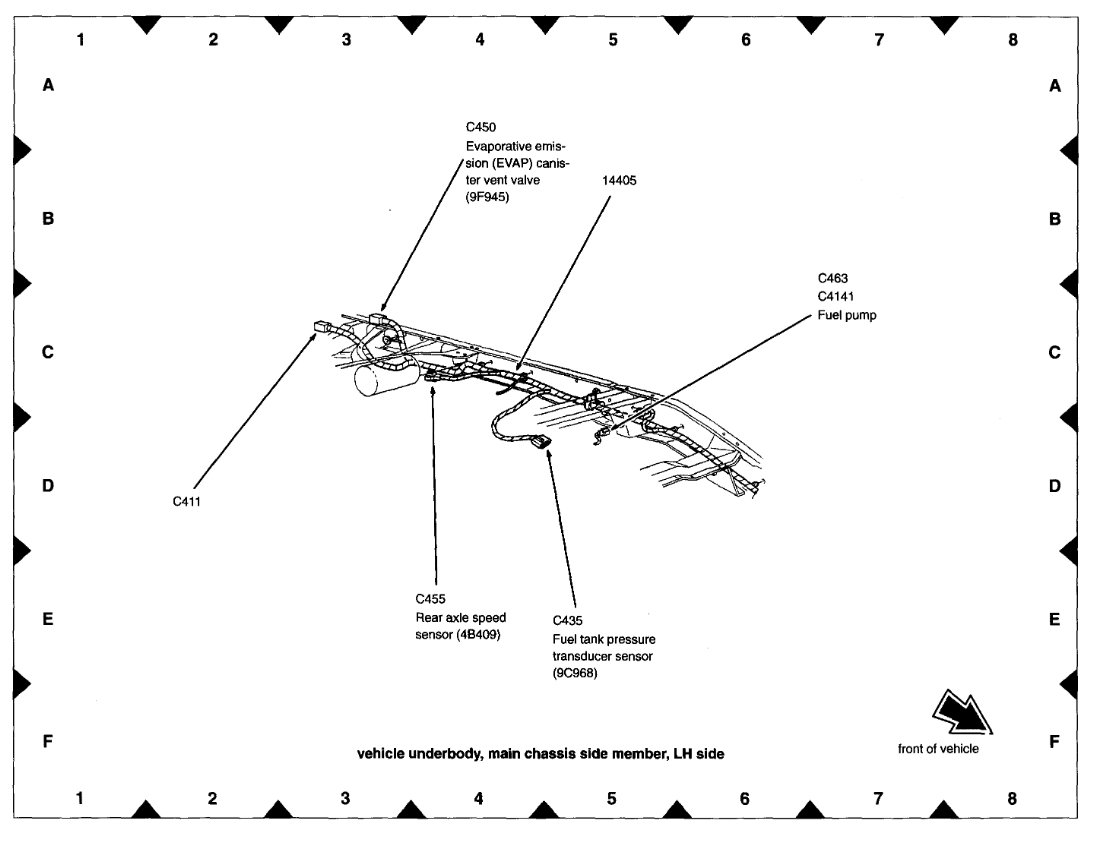

If it's not a v8 it's a v6 Ford F150.
Oct 10, 2022 at 5:09 AM
  • 55,808 POSTS
My bad, here is the location of the sensor. Check out the images (below). Please let us know if you need anything else to get the problem fixed.
