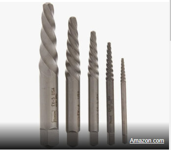

As far as the broken bolt is concerned, it needs fixed. If you only use two of the three bolts to secure the housing, it will likely leak. You need to get a bolt extractor to remove the broken bolt. Using a drill, carefully drill into the center of the broken bolt. Then, insert an extractor tool to remove the broken portion. I attached a pic from Amazon below showing what I'm referring to.
