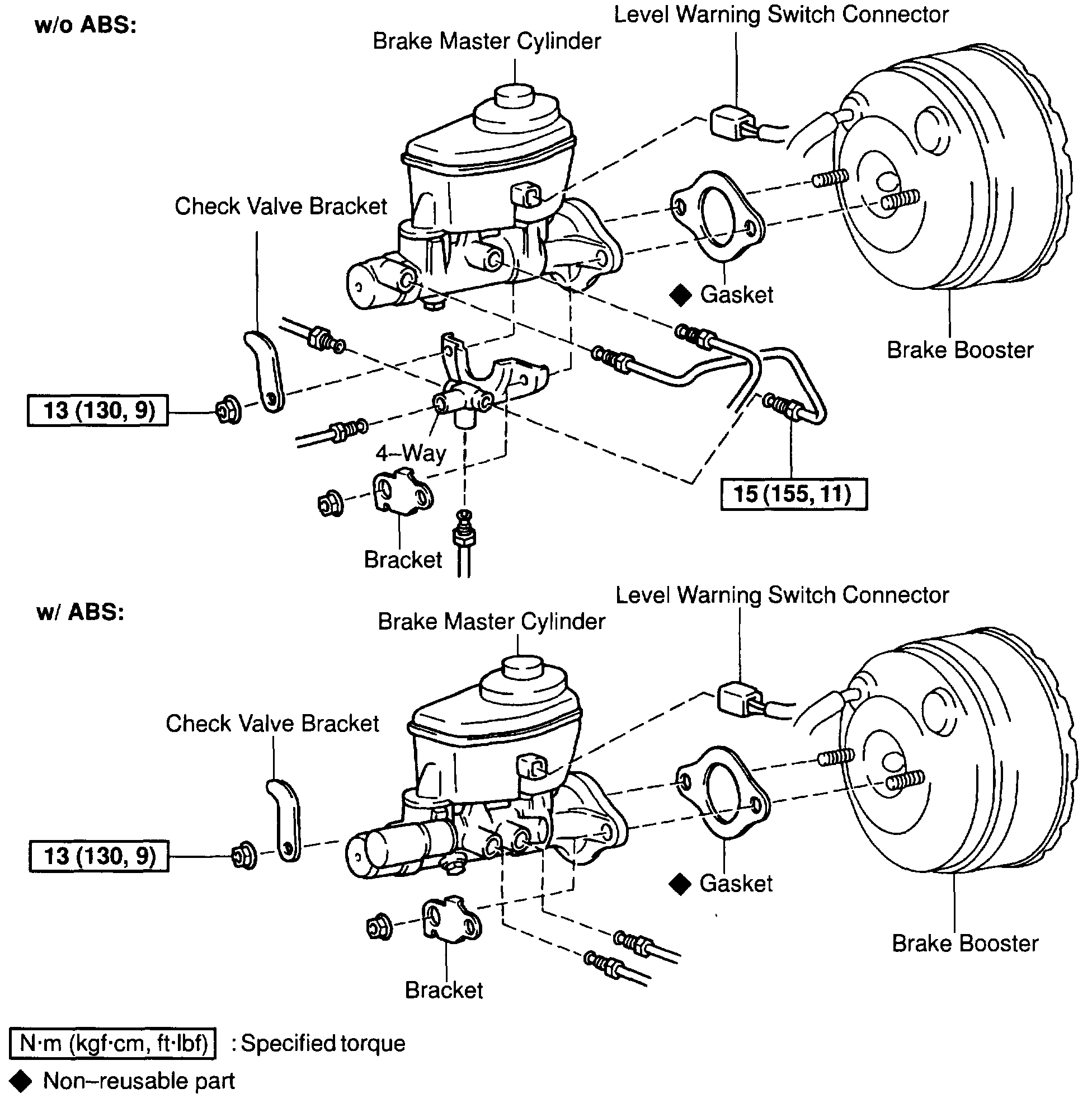

If you determine the master cylinder is bad, here are the directions for replacement. The attached pictures correlate with these directions.
__________________________
REMOVAL
1. Disconnect level warning switch connector.
2. Take out fluid with syringe.
NOTICE: Do not let brake fluid remain on a painted surface. Wash it off immediately.

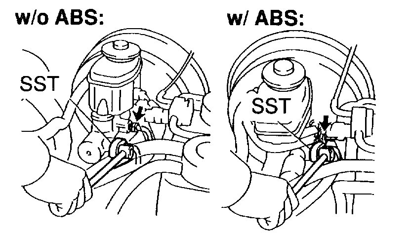

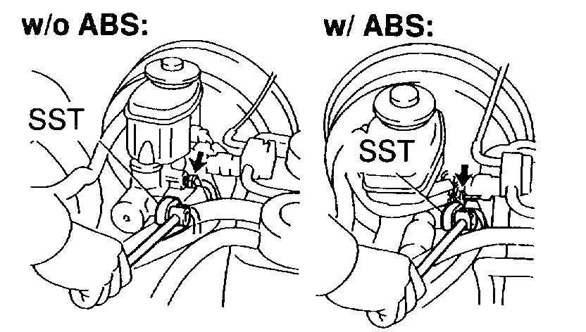

3. Disconnect brake lines.
Using Special Service Tool (SST) 09023-00100 or equivalent, disconnect the 6 (w/o ABS) or 2 (w/ ABS) brake lines.
Torque: 15 Nm (11 ft. lbs.)

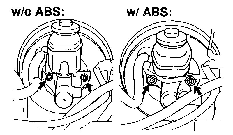

4. Remove master cylinder.
Remove the 2 nuts, 4-way (w/o ABS), check valve bracket, bracket and pull out the master cylinder and gasket.
Torque: 13 Nm (9 ft. lbs.)
INSTALLATION
Installation is in the reverse order of removal.

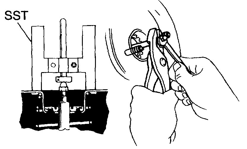

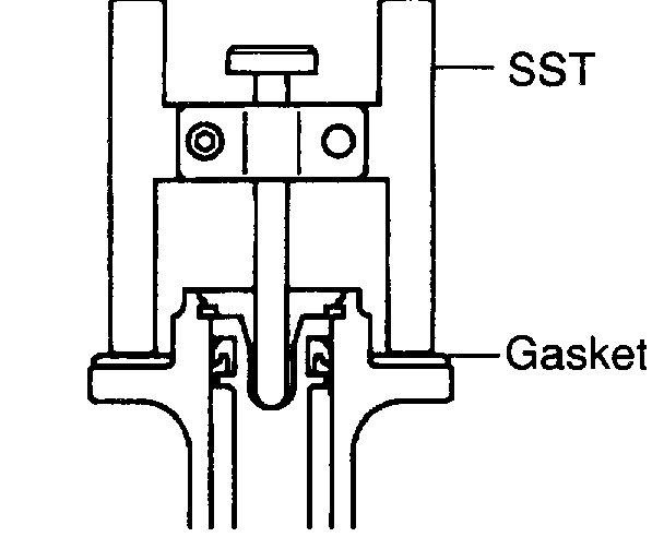

1. Before installation, adjust length of brake booster push rod.
a. Install a new gasket on the master cylinder.
b. Set the (SST) 09737-00010 on the gasket, and lower the pin until its tip slightly touches the piston.
c. Turn the (SST) upside down, and set it on the booster.
d. Measure the clearance between the booster push rod and pin head (SST).
Clearance: 0 mm (0 inch)
e. Adjust the booster push rod length until the push rod lightly touches the pin head.
2. After installation, fill brake reservoir with brake fluid, bleed brake system, check for leaks, check and adjust brake pedal.
