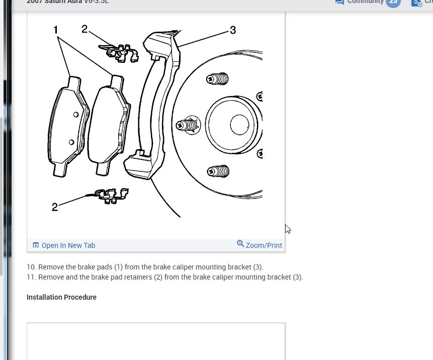

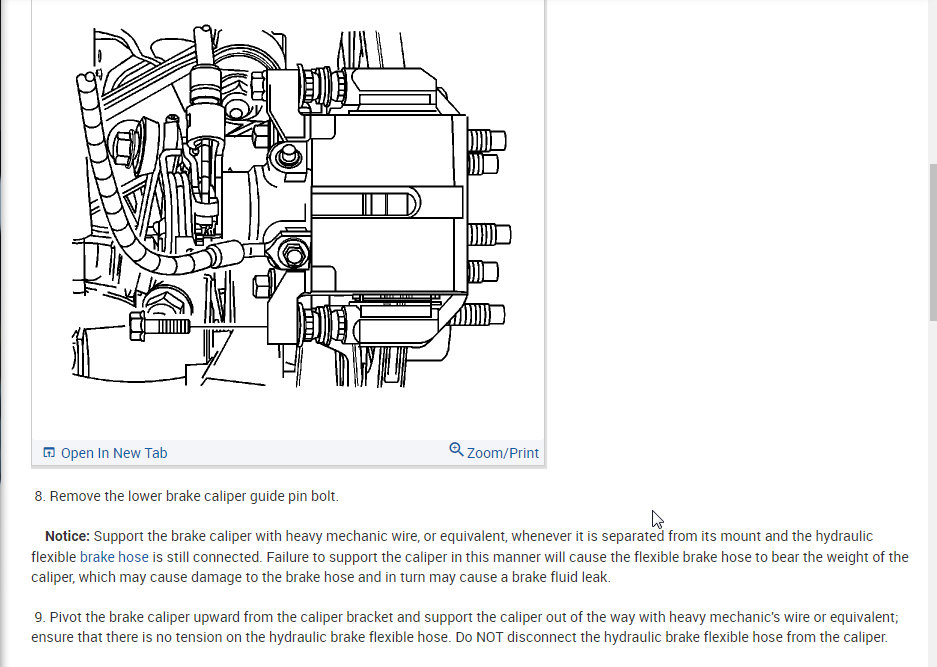

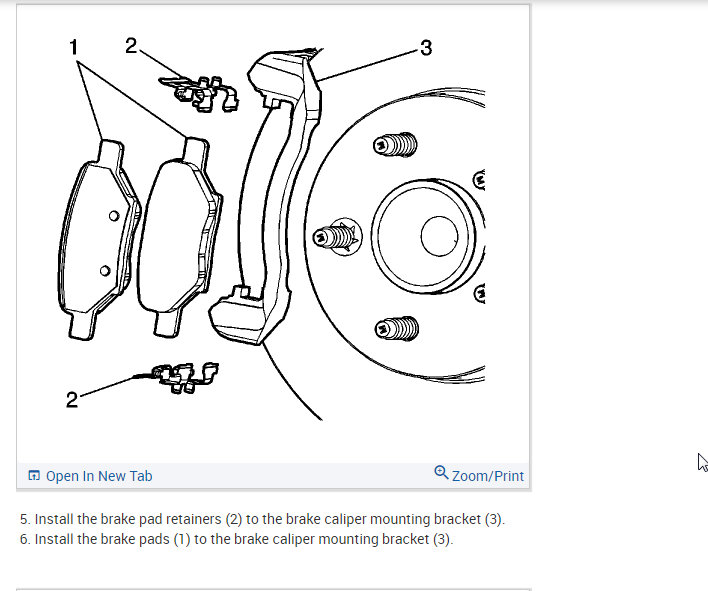

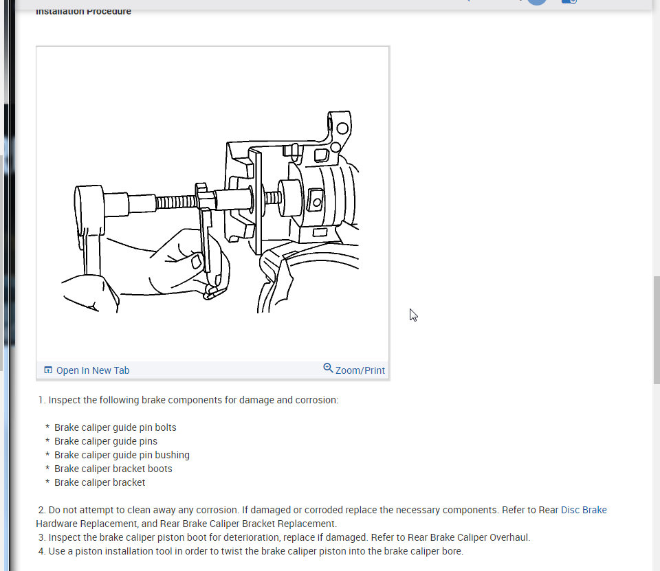

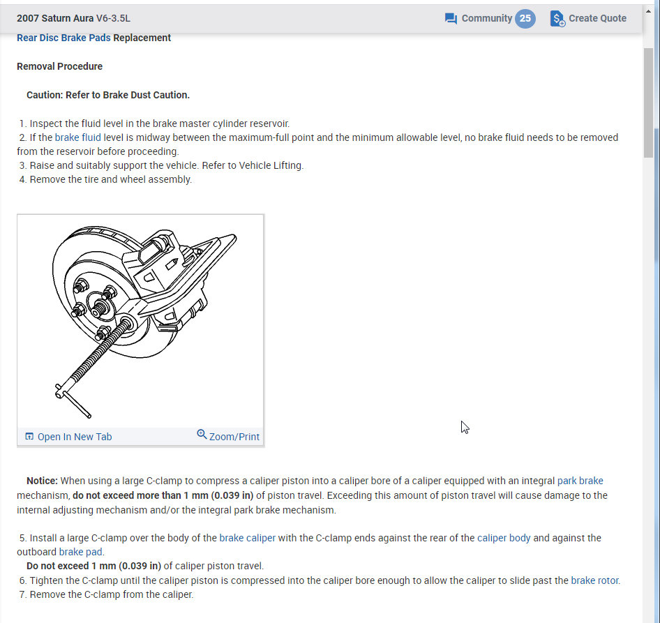

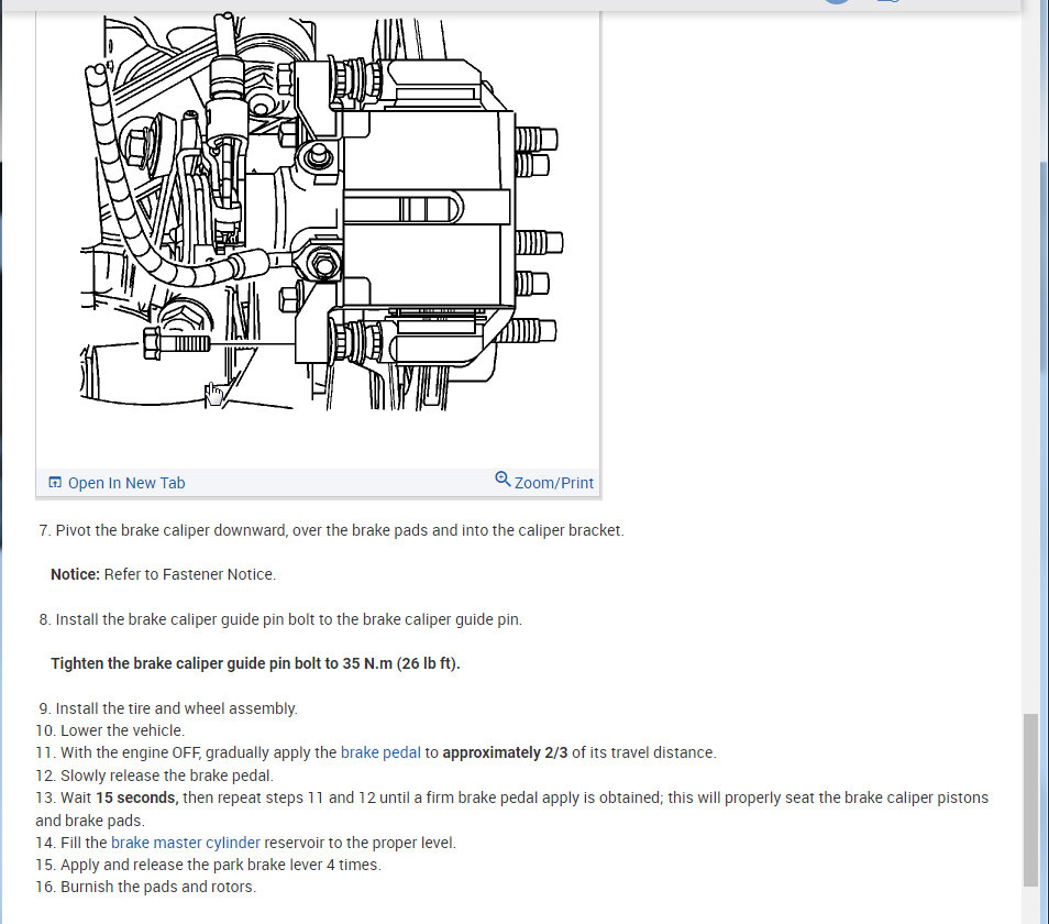

When I drive I hear like a grinding/squeaky noise and when I hit my brakes it kind of shakes. So I looked up how to do the rear brakes but can find anything on google.
Oct 8, 2018 at 11:37 AM
Here are a few guides that will help with this:
https://www.2carpros.com/articles/how-to-replace-rear-brake-pads-and-rotors
https://www.2carpros.com/articles/how-to-bleed-or-flush-a-car-brake-system
Below you will find the process from the manual that will help with this as well. Please let us know what questions you have with this. Thanks
