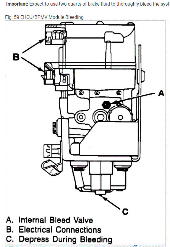

Everything has been replaced from all the brake lines, pressure hoses and master cylinder. Brake power booster front and back brakes wheel cylinders in the back and hardware the brake valve as well and still no brake and ABS light is on. The brakes still hit the floor i have to pump them a lot to build pressure to get the brakes to catch. what else can i do?
May 21, 2021 at 12:24 PM
  • 110,248 POSTS

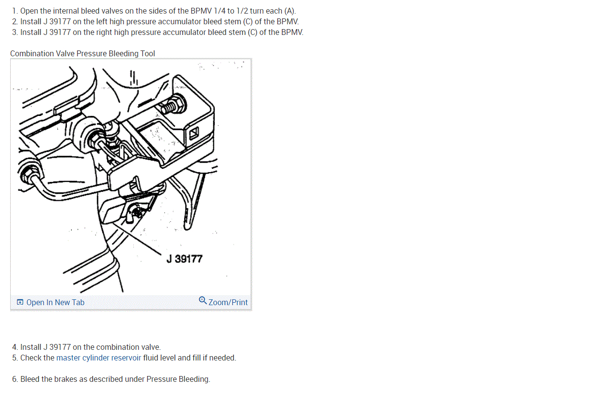

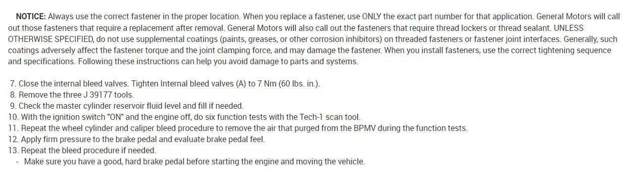

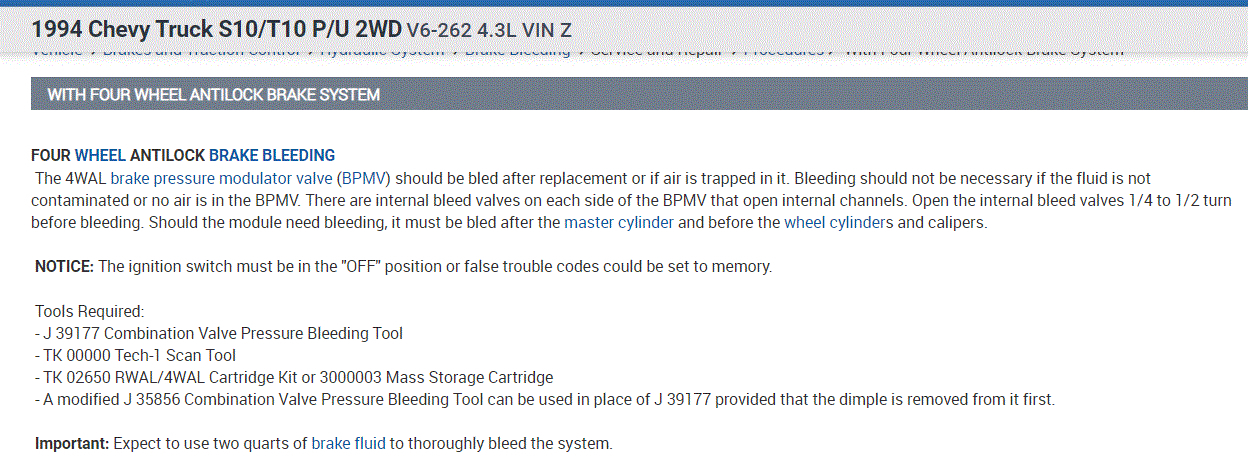

Does the vehicle have 4 wheel anti-lock brakes? If so, chances are the brake modulator valve needs to be bled. It's likely air is trapped in it.
Take a look at the attachments below. They explain the procedure.
