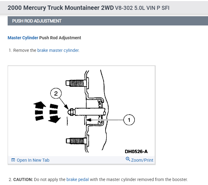

Brakes with slack replace brake booster and master cylinder bled the lines still have no brake pedal cannot figure out why.
Jan 6, 2023 at 1:16 AM
  • 110,244 POSTS

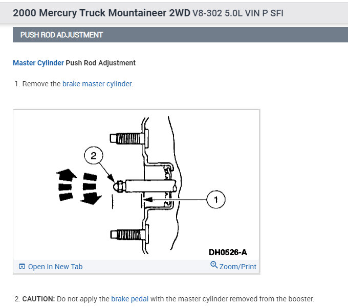

Are you certain there are no leaks? Did you check the pushrod adjustment? See pics 1 and 2 below. Also, when you bleed the brakes, are you starting at the right rear, left rear, right front, and left front order? Are you getting a good stream of fluid?
