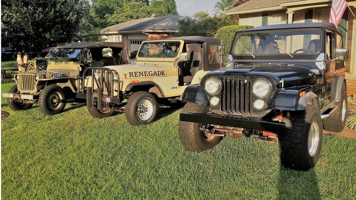

I've had nothing but CJs since I started driving in 1981. in 1991 I obtained and restored my sixth CJ-5 ('77) and my 1946 Willys (He's now 73 years old!)
