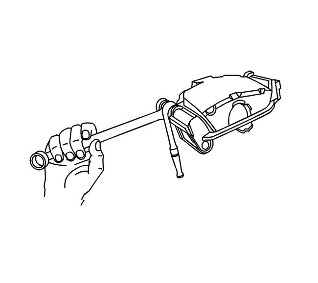

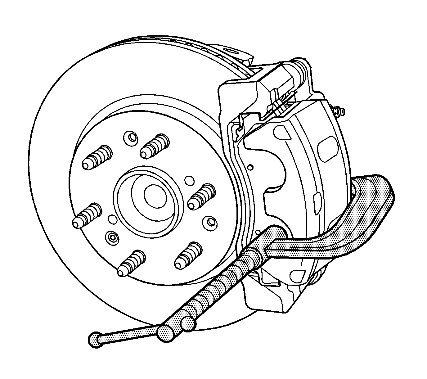

6. Compress the brake caliper pistons.
1. Install 2 large C-clamps over the top of the caliper housing and against the back of the outboard pad.
2. Slowly tighten the C-clamps until the pistons are pushed completely into the caliper bores.
3. Remove the C-clamps from the caliper.

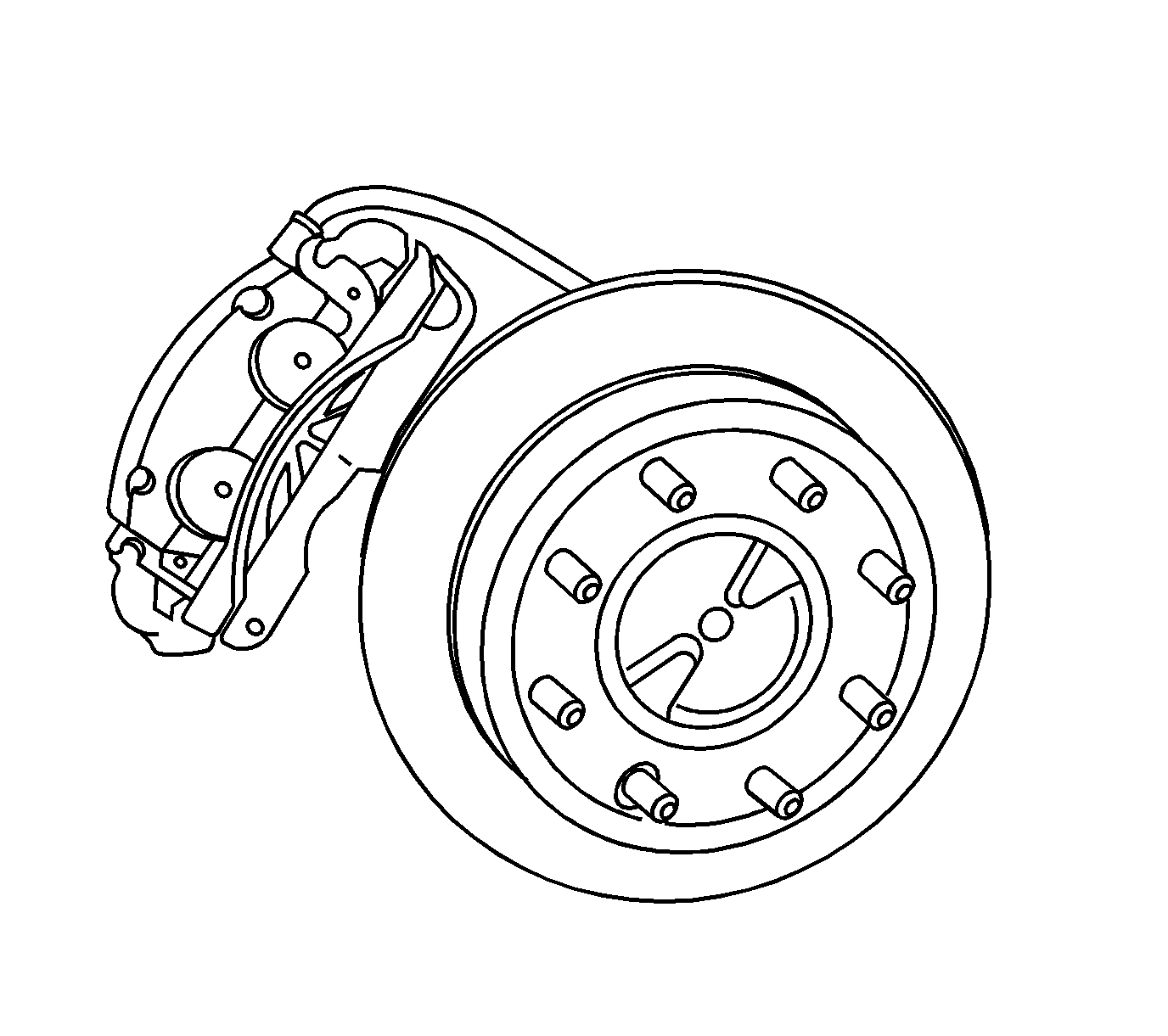

Note:
* DO NOT use any air tools to remove the guide pin bolts. Use hand tools ONLY.
* Install an open end wrench to hold the caliper guide pin in line with the brake caliper while removing or installing the caliper guide pin bolt. DO NOT allow the open end wrench to come in contact with the brake caliper. Allowing the open end wrench to come in contact with the brake caliper will cause a pulsation when the brakes are applied.
7. Using an open end wrench to hold the guide pin, loosen the brake caliper guide pin bolt.
pic 3
8. Remove the lower brake caliper guide pin bolt (1).

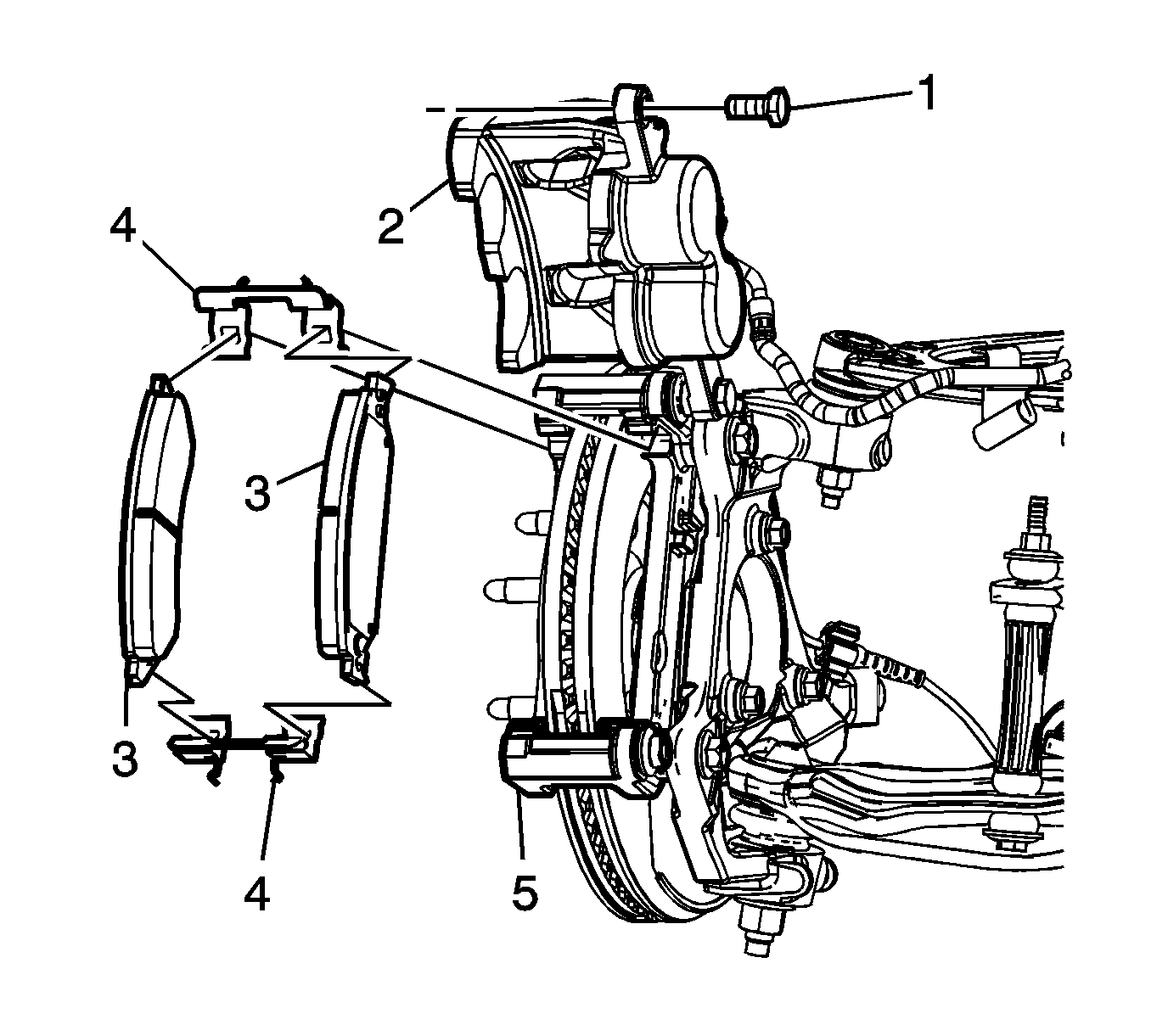

10. Remove the brake pads (3).
Note:
* If installing the original brake pads and spring clips, mark the position of the pads and spring clips for proper installation.
* If installing new brake pads, install new pad spring clips. Do not reuse the old brake pad spring clips with new brake pads.
11. Remove the brake pad spring clips (4) from the mounting bracket (5).

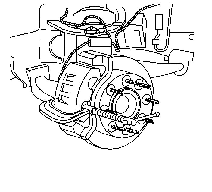

Installation Procedure
pic 4
1. Apply a very thin coating of high temperature silicone brake lubricant to the pad mating surfaces of the caliper bracket only.
2. Install the spring clips (4) to the mounting bracket.
* Install the NEW spring clips if replacing the brake pads.
* Install the original spring clips in their original position if installing the original brake pads.
3. If installing new brake pads, remove the adhesive backing paper from the brake pad insulators.
Note: If installing the original brake pads, position the brake pads as marked during the removal procedure.
4. Install the brake pads (3).

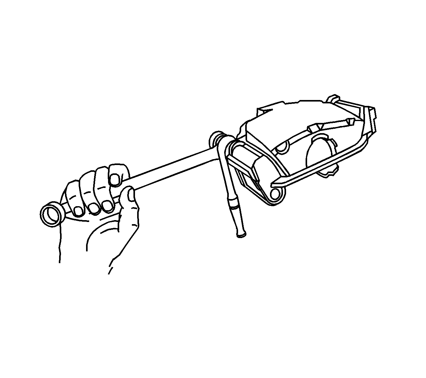

Caution: Refer to Fastener Caution See: Vehicle > Vehicle Damage Warnings > Fastener Caution.
Note:
* DO NOT use any air tools to remove or tighten the guide pin bolts. Use hand tools ONLY.
* Install an open end wrench to hold the caliper guide pin in line with the caliper while removing or installing the caliper. DO NOT allow the wrench to come in contact with the brake caliper. Allowing the wrench to come in contact with the brake caliper will cause a pulsation when the brakes are applied.
6. Use an open end wrench to hold the caliper guide pin while tightening the brake caliper guide pin bolt to 100 Nm (74 lb ft).

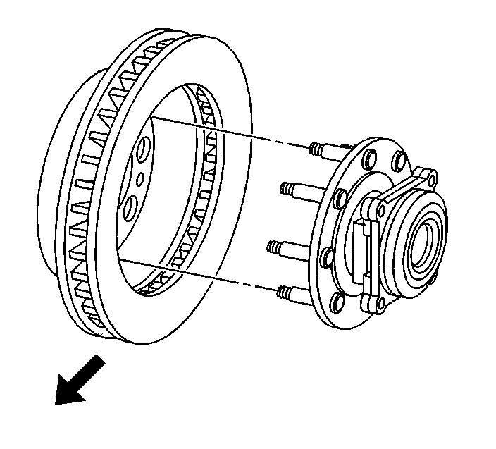

9. Remove the caliper and bracket assembly and support with heavy mechanics wire or equivalent.
10. Remove the rotor retaining push nuts from the wheel studs, if applicable.
11. It may be necessary to strike the end of the hub or the rotor with a deadblow hammer to separate the rotor from the hub.
1. Install the wheel nuts on the wheel studs to protect the ends of the wheel studs.
2. Strike the brake rotor between the wheel studs to separate the brake rotor from the wheel hub.
3. Remove the wheel nuts.
pic 8
12. Remove the brake rotor.
