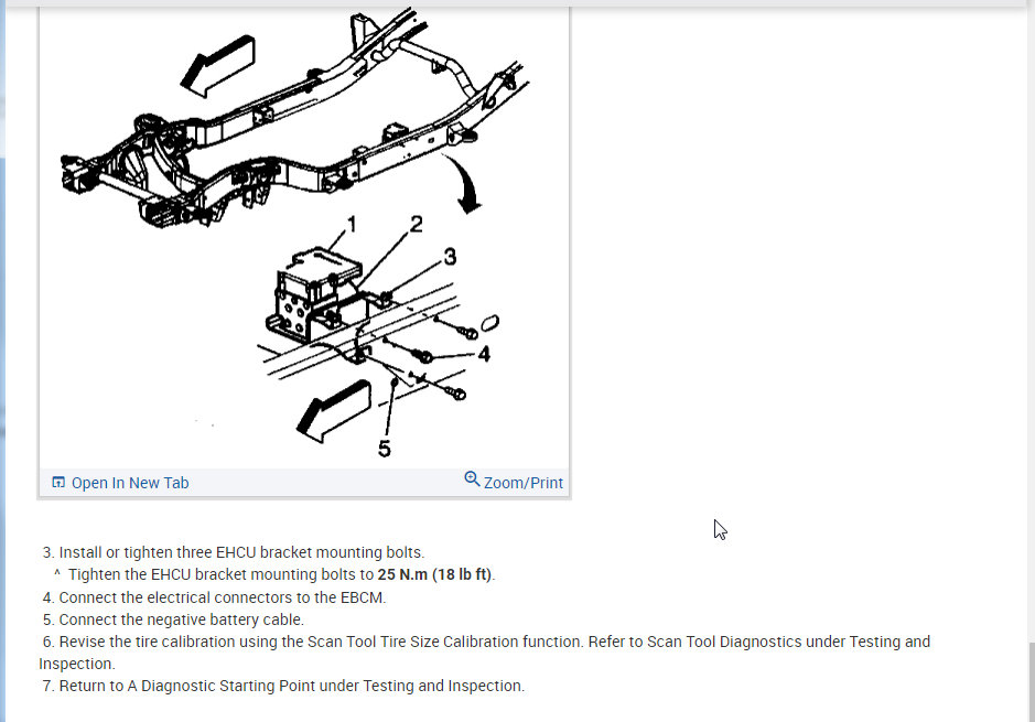

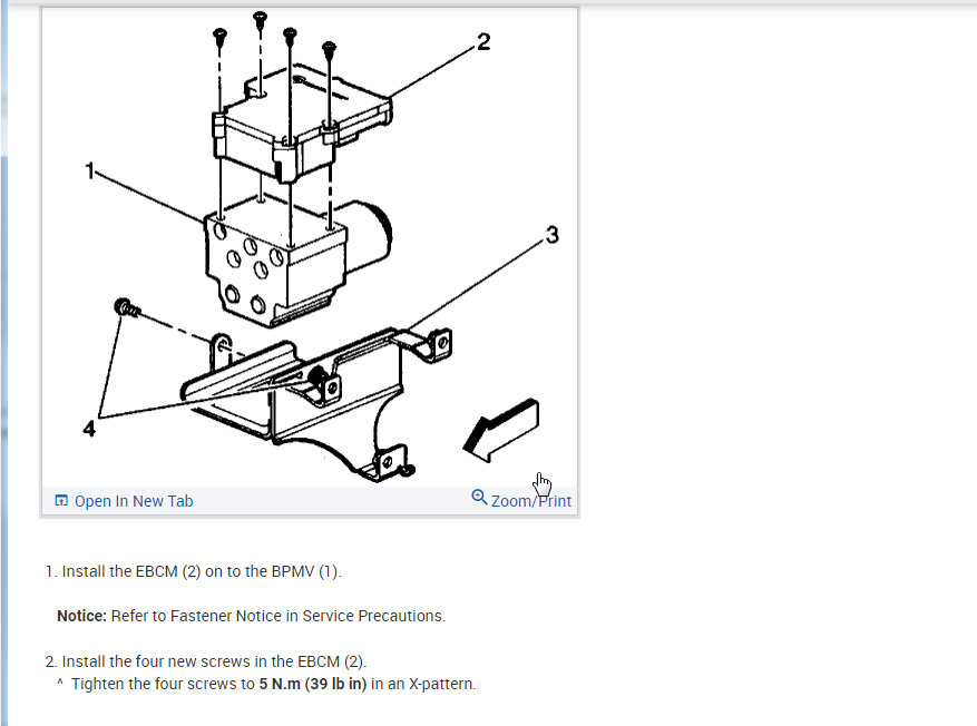

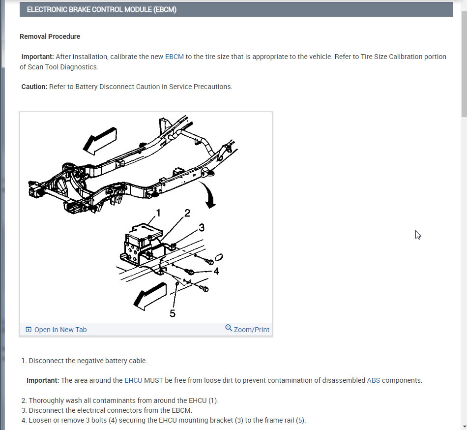

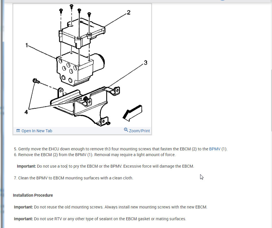

I have replaced my brake lines to my truck listed above (Silverado). I was starting to bleed my brakes noticed on the rear passenger side another leak occur I fixed that but the the ABS module is bad can you help me replace it, it just runs?
Jun 5, 2019 at 9:40 AM
Sure. Here is a guide that will help with this:
https://www.2carpros.com/articles/how-to-replace-a-abs-controller
Below you will find the process from the manual on how to replace this as well. Please let us know if you have other questions on this. Thanks
