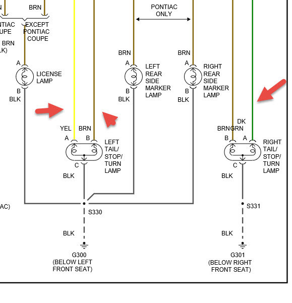

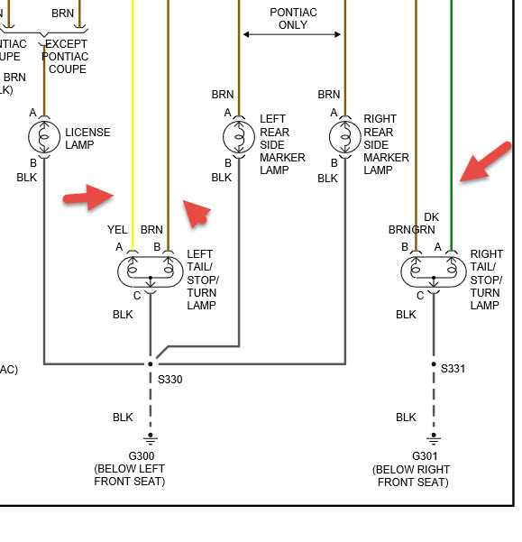

The back blinkers and break lights quit working. The font lights are good when I turn on blinkers it doesn't work in the front either. Changed the fuses and bulbs still don't work. What could be the problem?

check for power where arrows are marked if no power then check for a bad turn/signal switch. brown wire is for taillights. also check for ground which is black wire any of these can be broken and not sending power to taillight or sockets bad.
