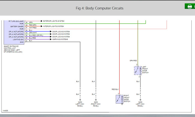

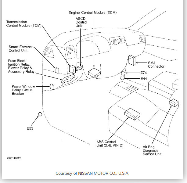

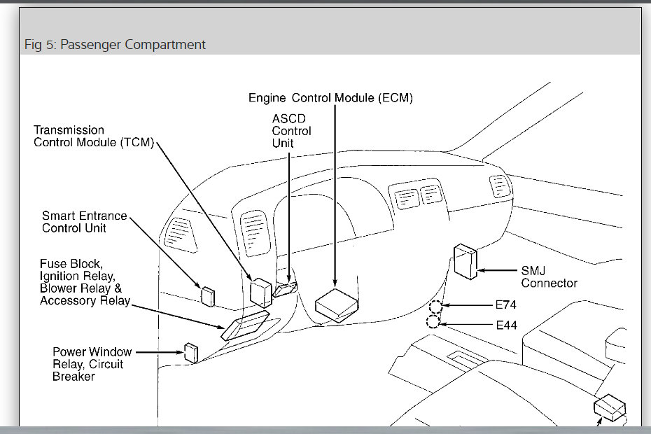

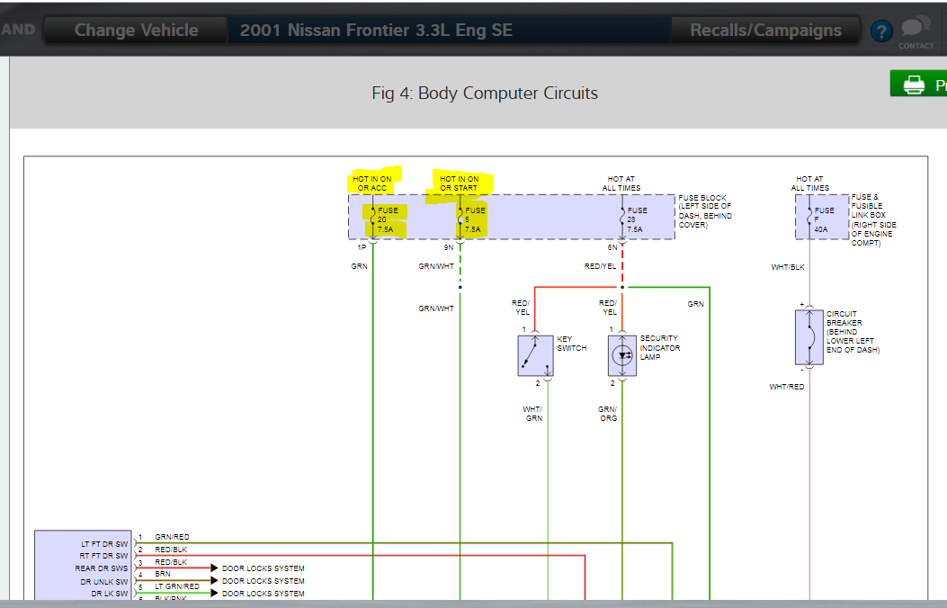

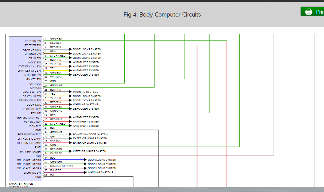

First let me thank you for your response to my earlier question.It was very informative.I can't seem to find a BCM fuse on my truck. Could it be called something else?the other fuses are good. Thank you.
Apr 21, 2019 at 9:02 AM
SCGRANTURISMO
  • 4,897 POSTS
Hello again,
I have included the information that you have requested in the diagrams down below. Please, if you have any other questions feel free to ask. That is what we are here for.
Thanks,
Alex
