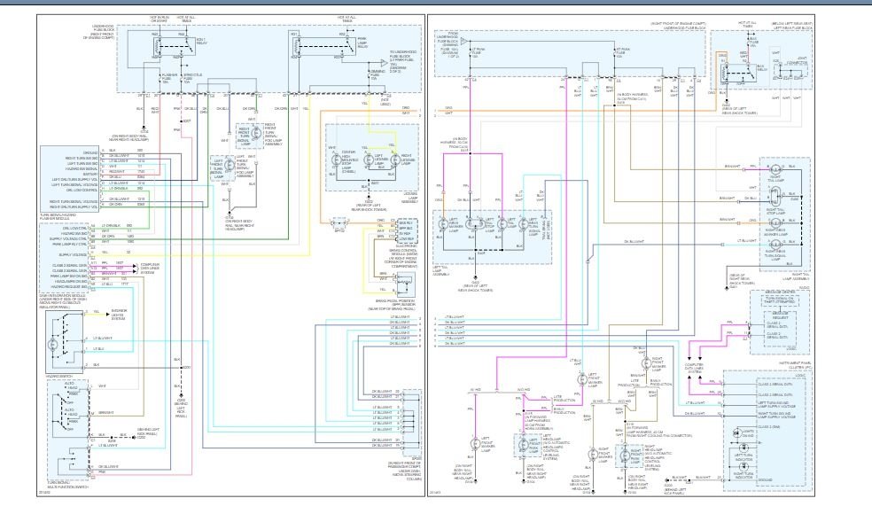

Brake lights not working
2005 CADILLAC CTS
169,000 MILES • 3.6L • V6 • 2WD • AUTOMATIC
SEMAJ BERRYMAN
My brake lights won't light up on my car, but the tail lights work. put a new brake light switch in and i changed the BAS fuse under the back seat and still no results.
Mar 10, 2019 at 8:01 PM
Good morning,

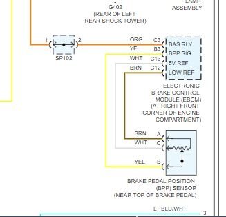

I attached a diagram for you to view. You need to check the voltage to the stop light switch. It uses a 5 volt reference voltage to send a signal to a module which controls the brake lights.
Mar 10, 2019 at 8:39 PM
