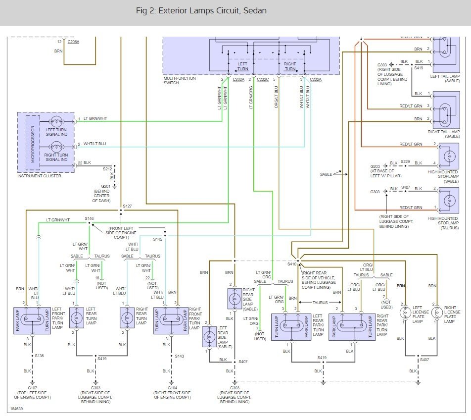

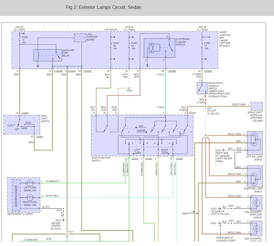

I would start by pulling each of the brake light bulbs out to see if there is any damage from heat melted sockets etc.
Here is a wiring diagram of the circuit so you can do some testing as well.
Please let us know what happens, we are interested to see what it is.
