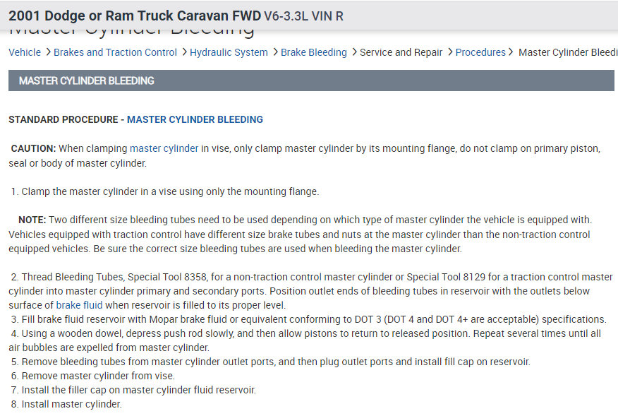

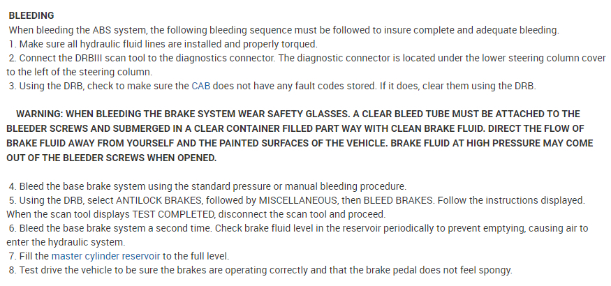

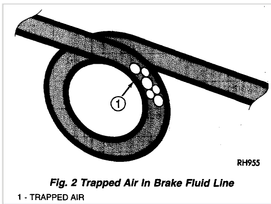

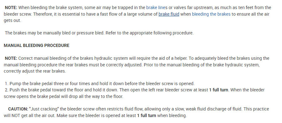

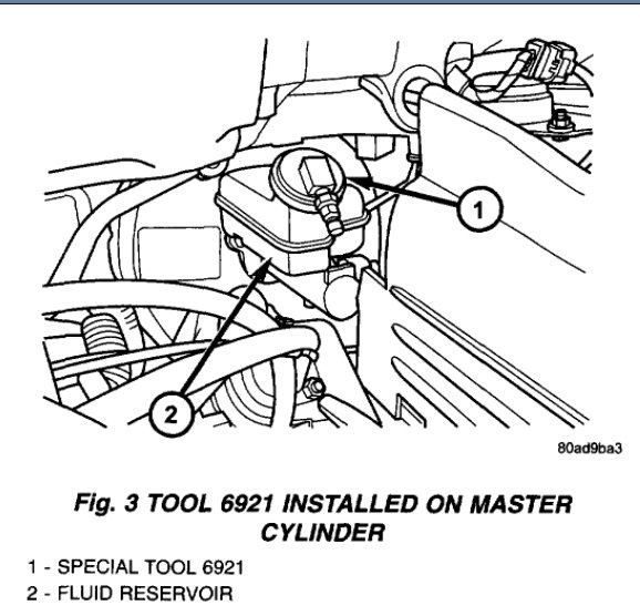

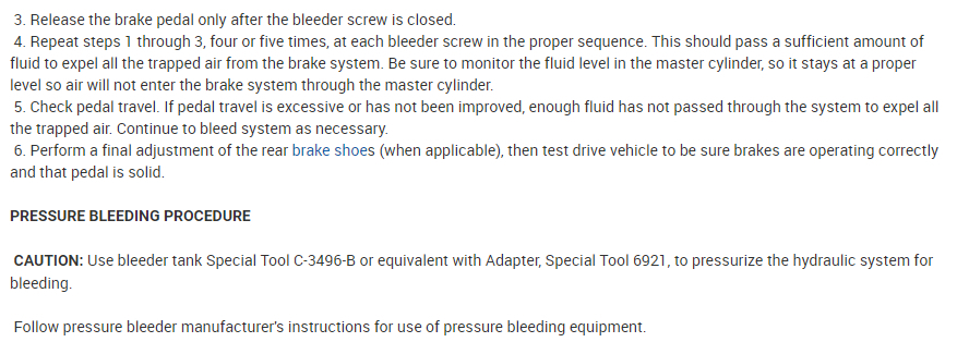

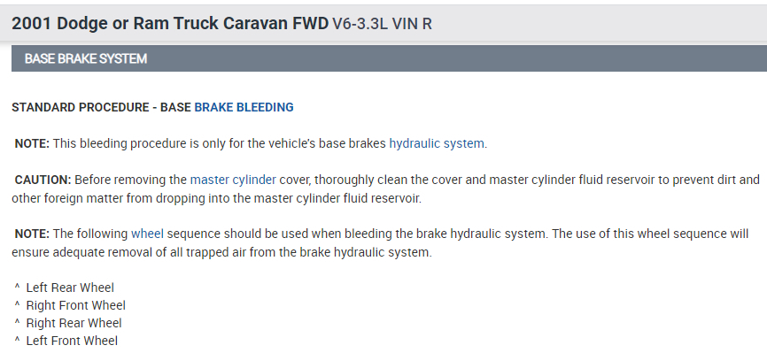

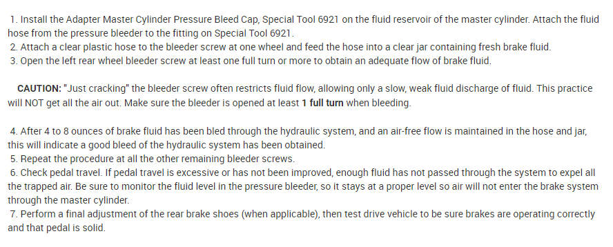

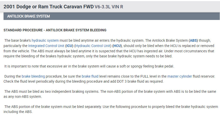

I am trying to bleed the brakes. I have good pressure and fluid coming from passenger side back bleeder and driver side front bleeder, but no fluid coming from driver side back or passenger front. what am I doing wrong or what could it be ?

Here is the information you requested. You didn't specify what type of brake work you performed to require brake bleeding but I'm guessing you had an open in the brake line system to require bleeding. Here is a brake bleeding tutorial for you to view first:
https://www.2carpros.com/articles/how-to-bleed-or-flush-a-car-brake-system

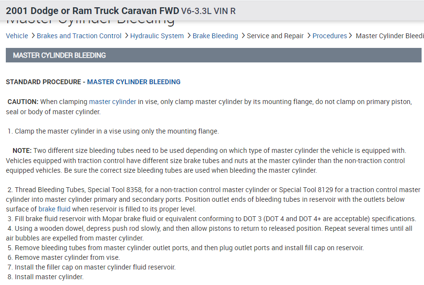

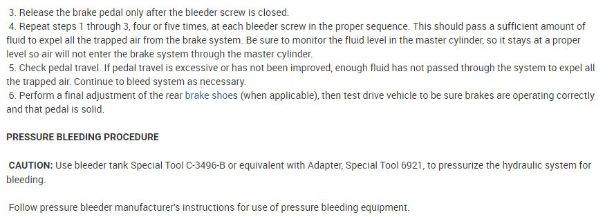

I've attached picture steps below on how to bleed the individual brake calipers, the master cylinder, and the anti-lock system for your van. Hope this helps and thanks for using 2CarPros.
