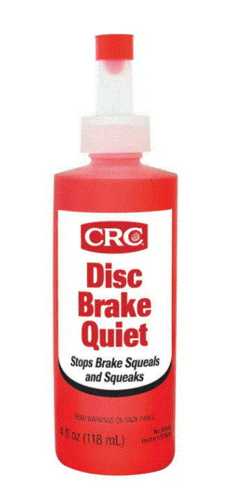

Why do my breaks squeak after pad replacement?
Apr 22, 2022 at 1:20 PM
  • 110,248 POSTS
Brake noise/squeak can be the result of a few things. First, were the brake rotors also replaced? What type of pad was used as a replacement?
What I have experienced over the years is this. If rotors are not replaced, they can cause noise. There is a glaze that will build up on them and sometimes the new pads when applied, squeak.
Now, this is funny, but I have experienced squeak when I went to the extreme on either end of the spectrum. For example, a ceramic hi priced pad can make noise and a cheap pad can do the same based on design.
If you did replace the rotors, what you can do is purchase a brake squeal eliminator. Basically, it is placed on the back of the disc pads. It absorbs the vibrations causing the noise. I attached an example below of the type of product I'm referring to.
See pic below.
