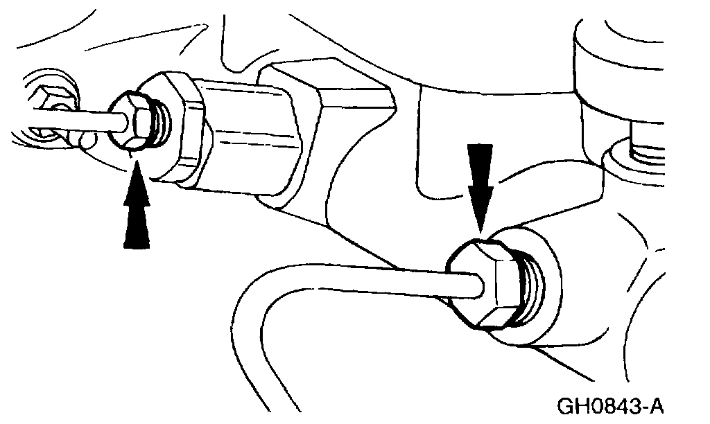

I put new brakes on bled them off and I still get no pedal. it goes all way to the floor when I press it.

It sounds like a bad master cylinder. Have you checked that? If there are no leaks, that's my first suspect. take a look through this link.

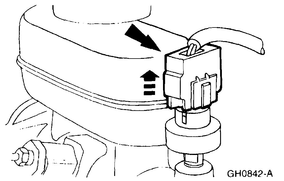

1. Disconnect the brake fluid level warning switch.

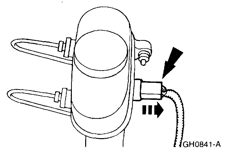

2. If equipped with speed control, disconnect the brake pressure switch electrical connector.

3. Disconnect the two brake lines and plug the lines and the brake master cylinder ports.

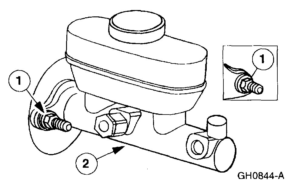

5. Remove the brake master cylinder
1 Remove the two brake master cylinder nuts
2 Remove the brake master cylinder

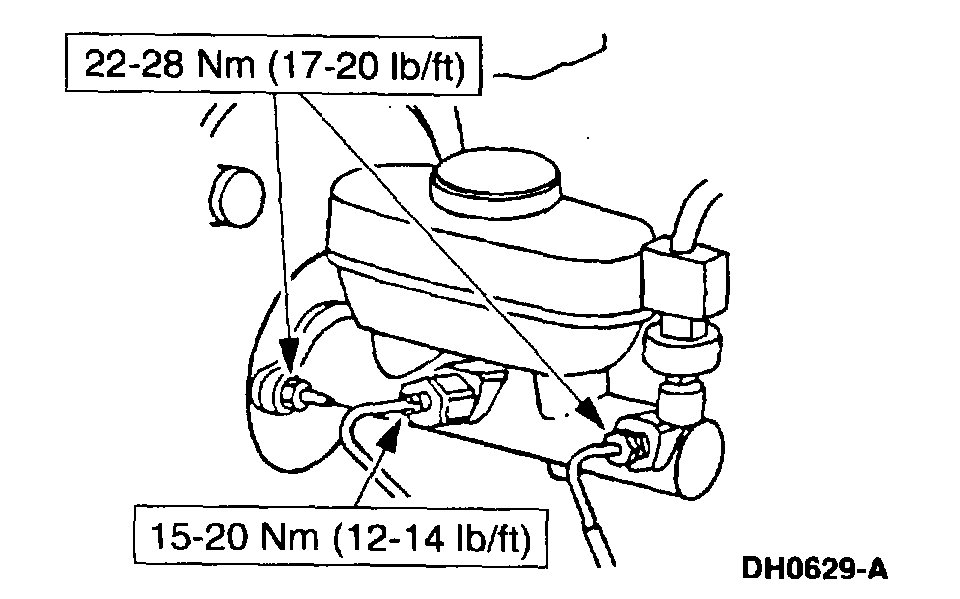

1. Follow the removal procedure in reverse orders
- Bleed the brake system.
