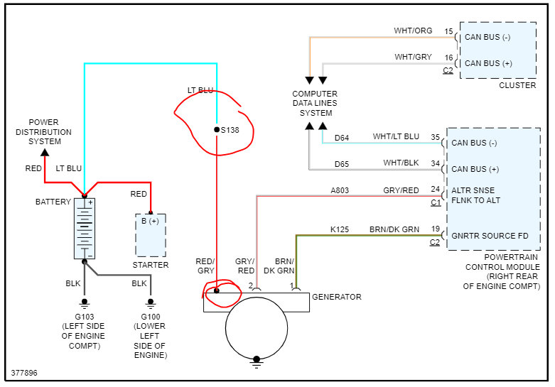

No charge to the battery?
2010 JEEP LIBERTY
100,000 MILES • 3.7L • 6 CYL • 4WD • AUTOMATIC
NATE41
New alternator, still have no charge to battery.

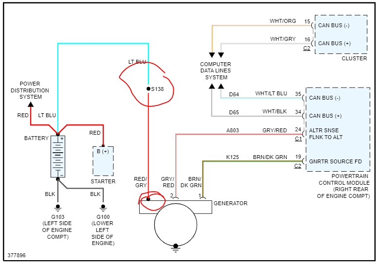

The idea that it isn't charging is likely not the cause of the alternator. The Electronic Voltage Regulator (EVR) is not a separate component. It is actually a voltage regulating circuit located within the Powertrain Control Module (PCM). The EVR is not serviced separately. If replacement is necessary, the PCM must be replaced.
So, we need to confirm there is power to the alternator first and confirm there are no connection issues.
At the alternator, there will be a red wire with a gray tracer. It should have battery voltage at all times. Using a test light or multimeter, confirm that. If there is power, make sure the connector at the alternator is free of corrosion, tight, and there is no damage to the connector pins.
If everything checks good, suspect the voltage regulator has failed which means the PCM needs replaced. Keep in mind, the new alternator can be bad too. It may be a good idea to have it bench-tested at a parts store.
See pic below.
