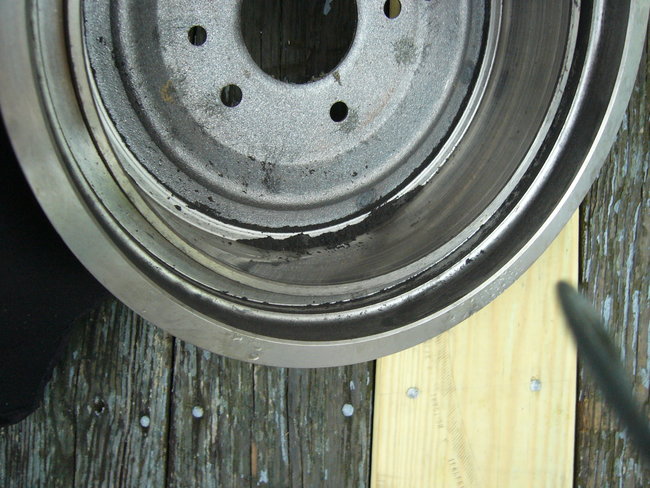

Ok, it finally stopped raining for a bit. Jacked up car and first thing I noticed taking off rear right hub is a lot of brake dust in the drum! It is the second brand new one and only has about 20 miles on it. Next inspected for leaks, all is dry. Both shoes are pulled up nicely against top pin, and yes there is some slack in that E-brake cross bar, rattle spring nice and solid and seated good. Had helper press parking brake and then release. Was interesting to watch, all worked and released. Now I pulled it apart and the rub points all appear to have been making contact, initially and now regreased with CRC brake grease. I also moved the brake cables in and out by hand with out any issues noted, felt free and smooth. FYI, for first 17 years car was a garage queen and only accumulated 32k miles. When I was doing the bleeding, fluid was very clear, slight gold tint to it and came out nice and strong.
Sunday, July 31st, 2016 AT 2:15 PM
JBUCO315
  • 23 POSTS

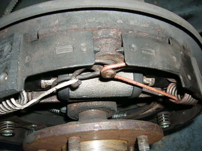

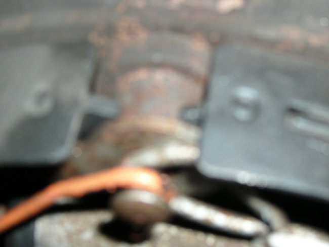

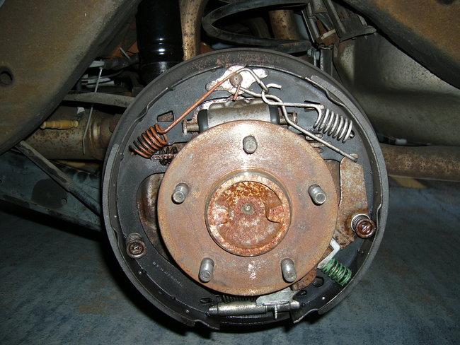

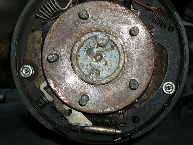

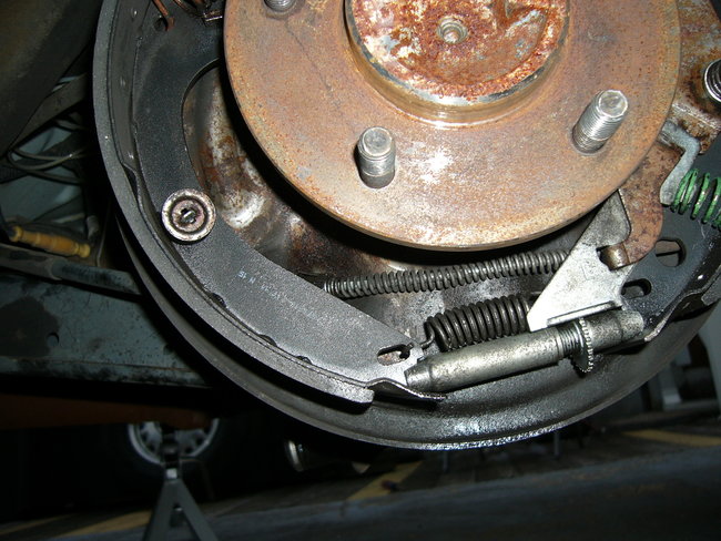

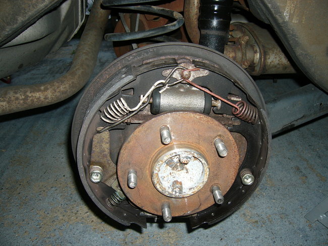

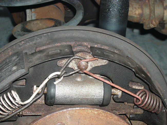

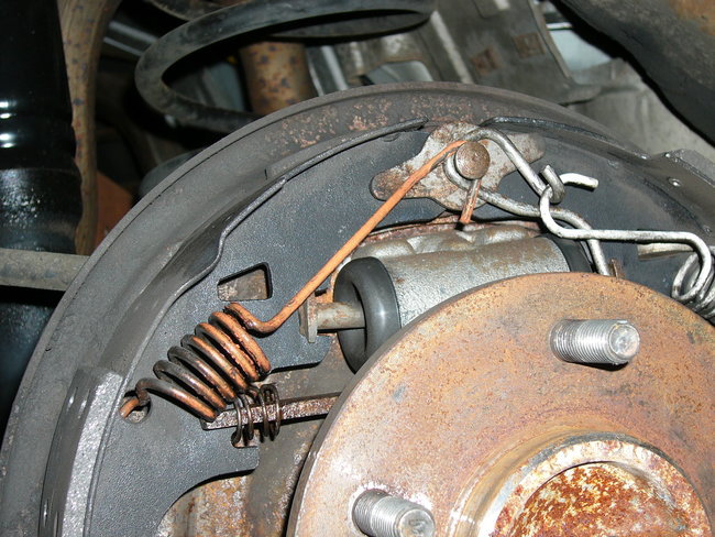

Starting to rain again, so here are some pics, maybe a "pic CAN be worth a 1000 words". 1-4 are left rear, 5-8 RR, and 9 is amount of brake dust from less than 20 miles, both sides are like this.
Sunday, July 31st, 2016 AT 3:00 PM
CARADIODOC
  • 33,916 POSTS
I don't see anything obvious. There's only two other things I can think of. The first is since you replaced the wheel cylinders, did you buy the correct diameter? Did you look at one of the old ones or go by what the person looked up at the auto parts store? On the old one the diameter is molded onto the inside of each rubber lip seal.
The other thing is if there's a height-sensing proportioning valve. Those are used at the rear axle on most pickup trucks and minivans because there can be such a wide variation in weight distribution based on loading and number of passengers. As the rear is loaded more heavily, more braking power goes to the rear brakes. Reducing braking power to the rear when lightly loaded reduces the tendency for the rear brakes to lock up during hard braking.
Cars don't normally use a height-sensing proportioning valve, but you should check to be sure. In the late '80s, Chrysler minivans had an irritating characteristic where the rear brakes would lock up very easily when the road was wet. That was due to slightly sagged rear springs making it falsely appear that the rear was more heavily-loaded. The adjustment for that valve took less than ten seconds, and I carried a 5/16" wrench with me on all my alignment test-drives in case I ran into one doing that.
The springs on all vehicles sag with age, and if your car has this valve, it is almost surely the cause of this problem. The valve is almost always above the left rear axle, bolted to the body, with a linkage connected to the axle housing.

Fixed; I did have the original pistons to compare to however the two replacements are the same diameter. With that said, looking at the new shoes that I had just put on, both L and R sides seem to be falling apart as well as destroying the drums! Best I can describe it is, have you ever seen a board drug across smooth dirt, but when it hits a rock, it creates a gouge that gets progressively worse until something gives. Well this was happening all over these shoes. Took them back and went with a different store and brand as well as another spring kit (although there was nothing wrong with the tension of the these ones I had just put on! Lol). These new shoes do not have as much material on them and kind of resemble several layers of stacked hard pressed gray cardboard but, its been three days now, they have adjusted out and all is fine again.
I hate to throw names out there but the bad ones were: O'Reilly's BrakeBest Select Brake Shoes #462. The replacements are from Advance Auto, Wearever Brake Shoe #S462.
Thought this was funny, when returning them I showed the guy and he said "oh yea, they are shredding on you". I asked if this was a common thing, "no, never seen that before". Okay, never seen that before but you know what it is and you have a name for it, hummm.
