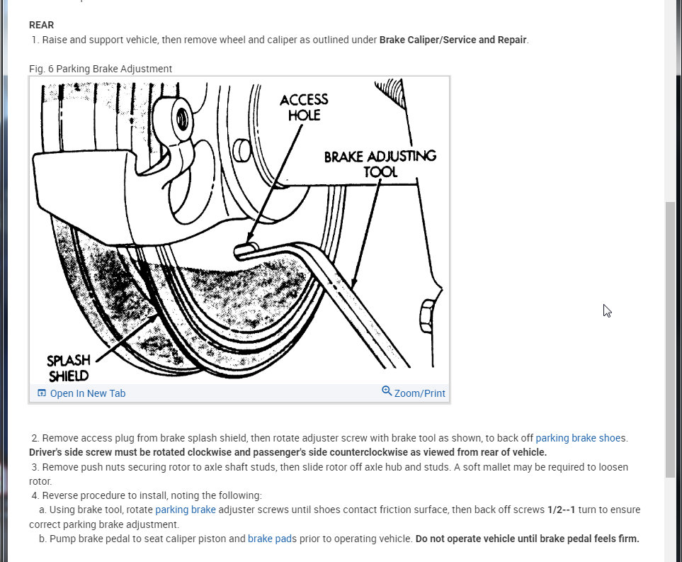

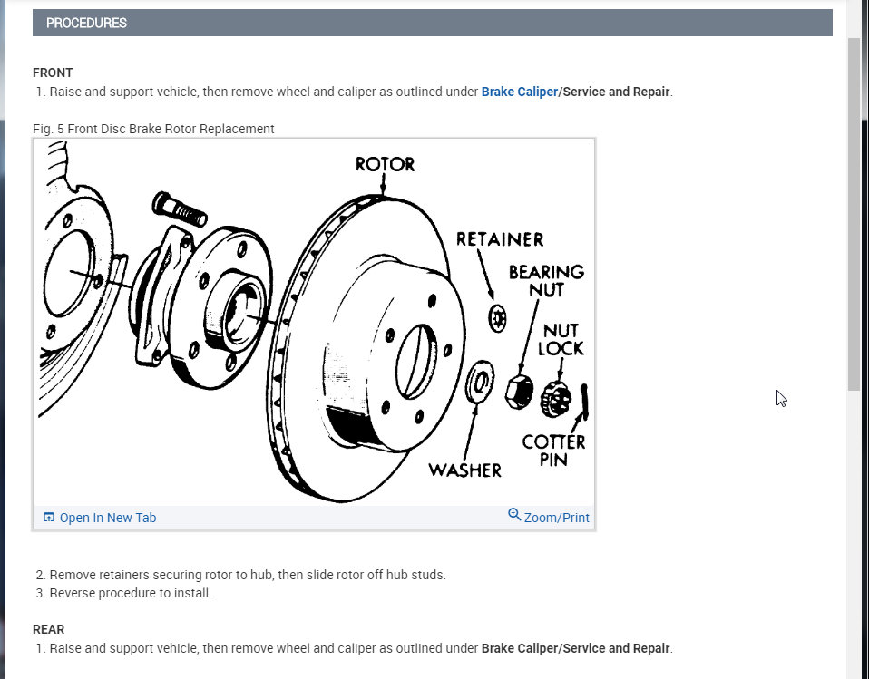

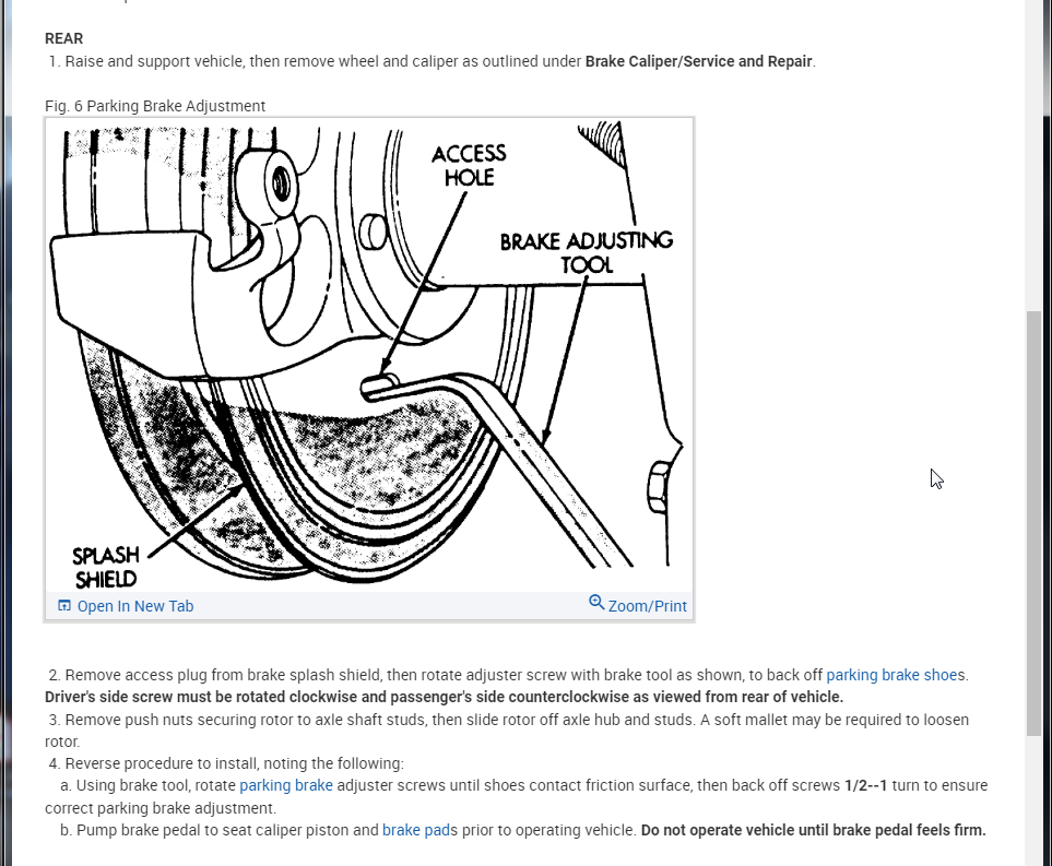

When this happens do you feel the vibration in the steering wheel? If so, the front rotors are most likely warped and require replacing or turning if you have enough rotor left.
Since you replaced all the other components you have replaced, I would just go ahead and replace the front rotors as well.
Let me know if you have questions and we can go from there. Thanks

Thanks for your advice. Changed front rotors vehicle stops smooth again. Thanks
