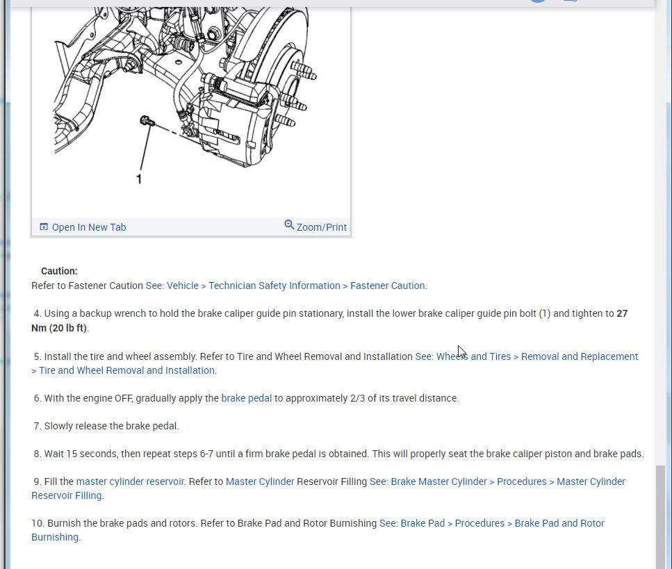

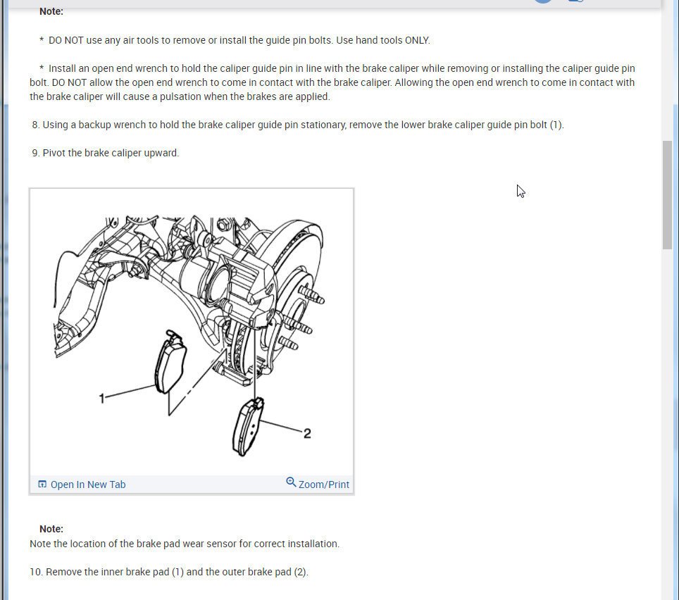

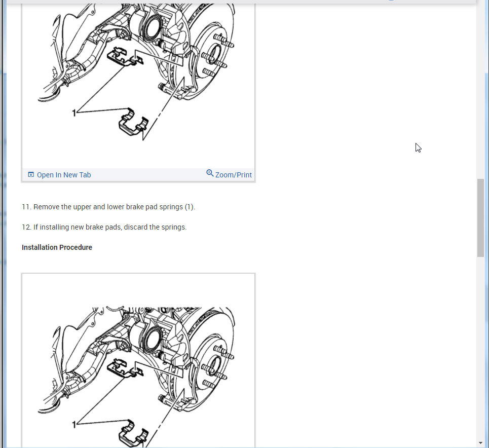

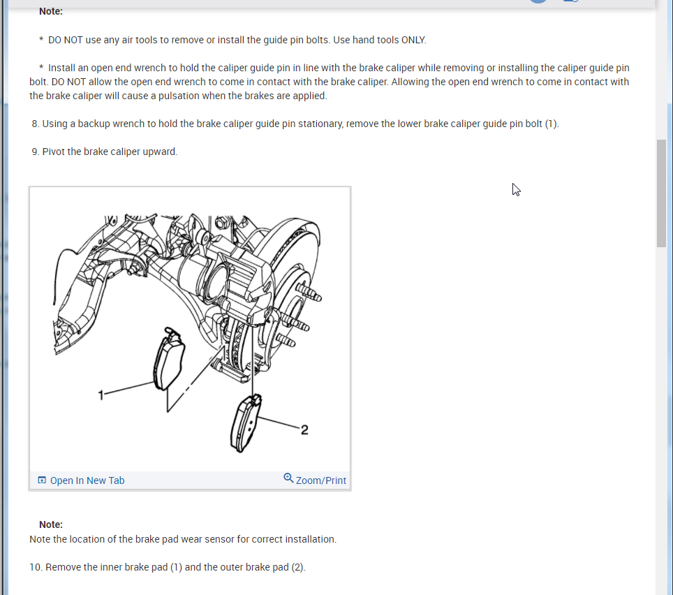

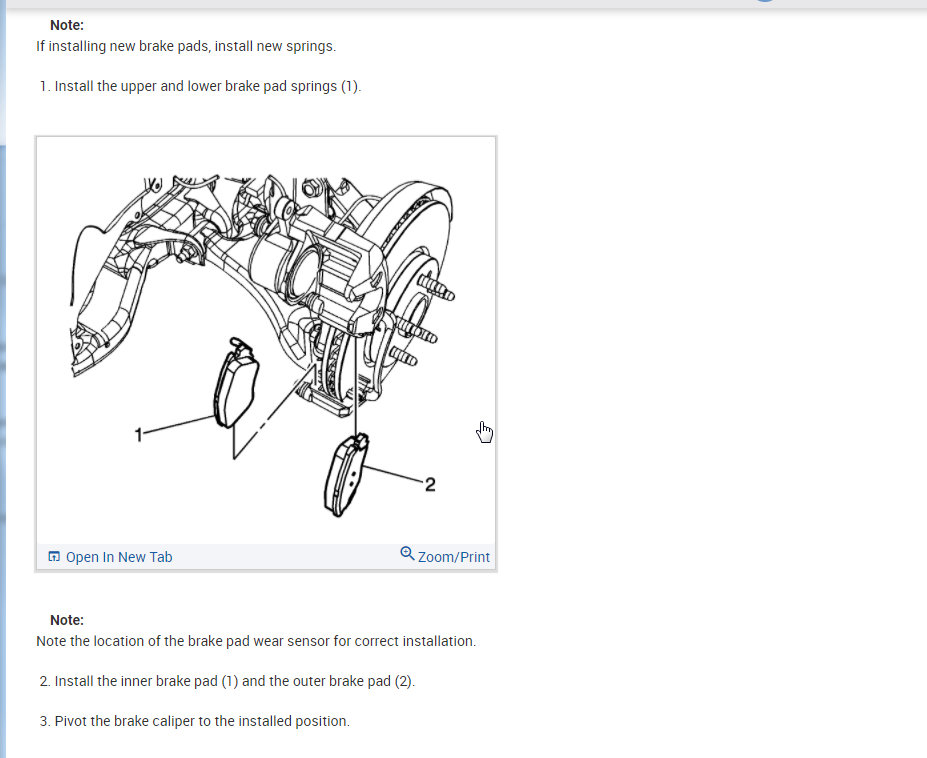

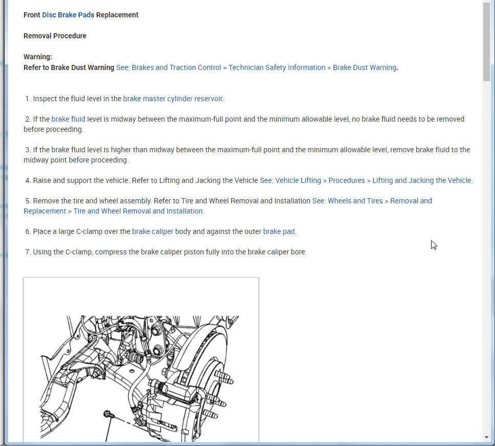

same noise but only braking at low speeds, its grinding I need new front brakes
Sep 3, 2019 at 3:35 PM

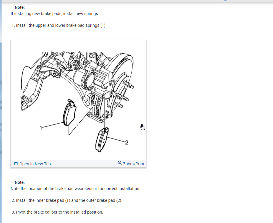

This video shows the job being done on a similar car but the process is the same.
https://youtu.be/9v9Xsx5Wjf8
and here is a guide to help you step by step with instructions in the diagrams below to show you how on your car.
Below are the instructions from the manual on how to replace these brakes which will show you what you need.
