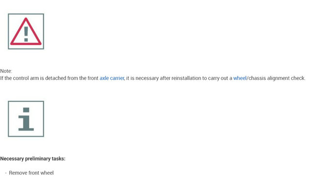

Not really, I would rotate the tires front to back and then take it for a test drive, let me know. If that does fix it look for lower ball joints and control arm bushings.

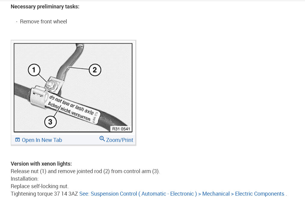

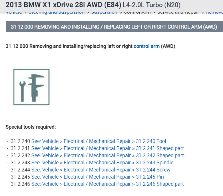

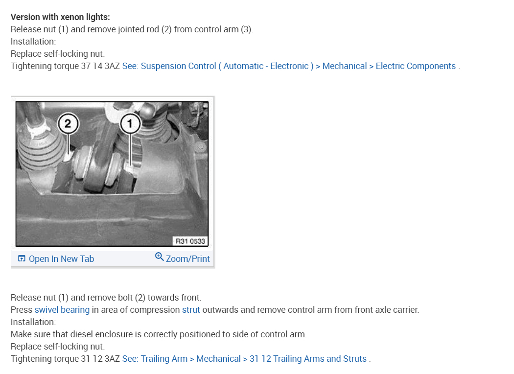

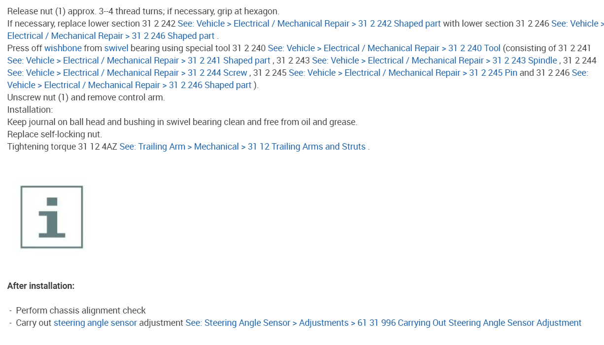

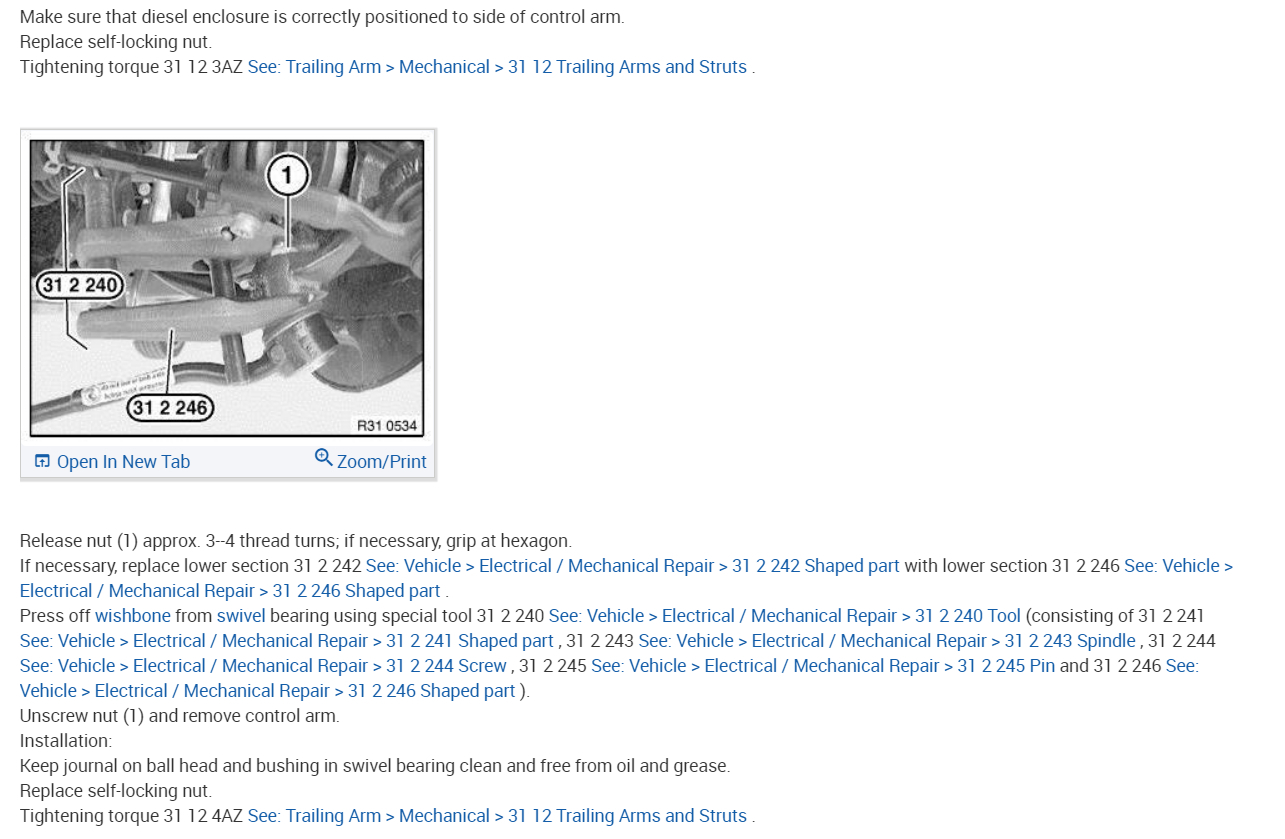

I removed the two bolts holding the lower control arm from wheel and other end, but the thing is super stuck to the ball joint. I sprayed it with rust blaster and hammered it and nothing. Too tight to put any type of puller on it.

Yep, sometimes you need to put it up on the rack to see better. Upload videos if you have any troubles.
