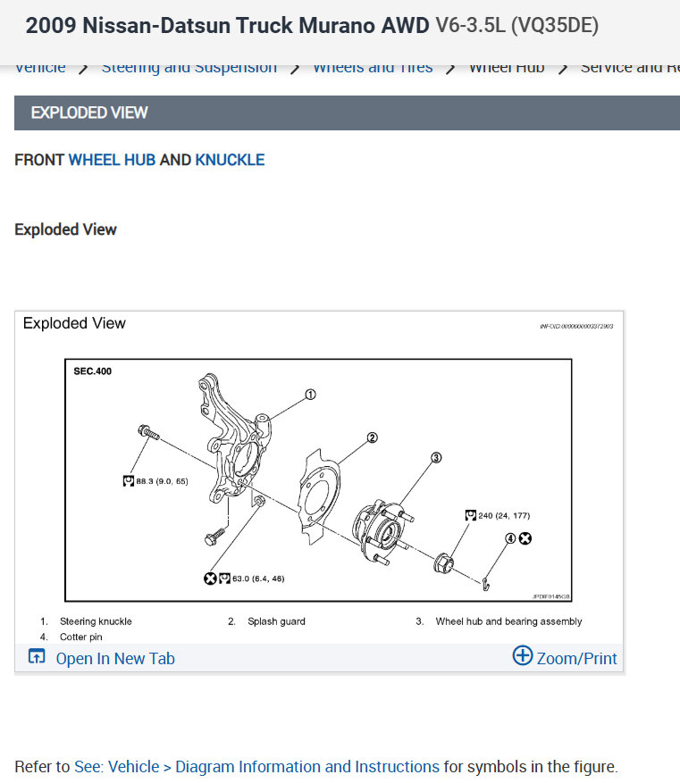

Okay, let's raise the front of the car to check the bearing hub, grasp the tire and try to move it back and forth, up and down to see if there is play in the bearing. If so, here is the part that needs to be replaced.
Check out the images (below). Let us know what you find.
