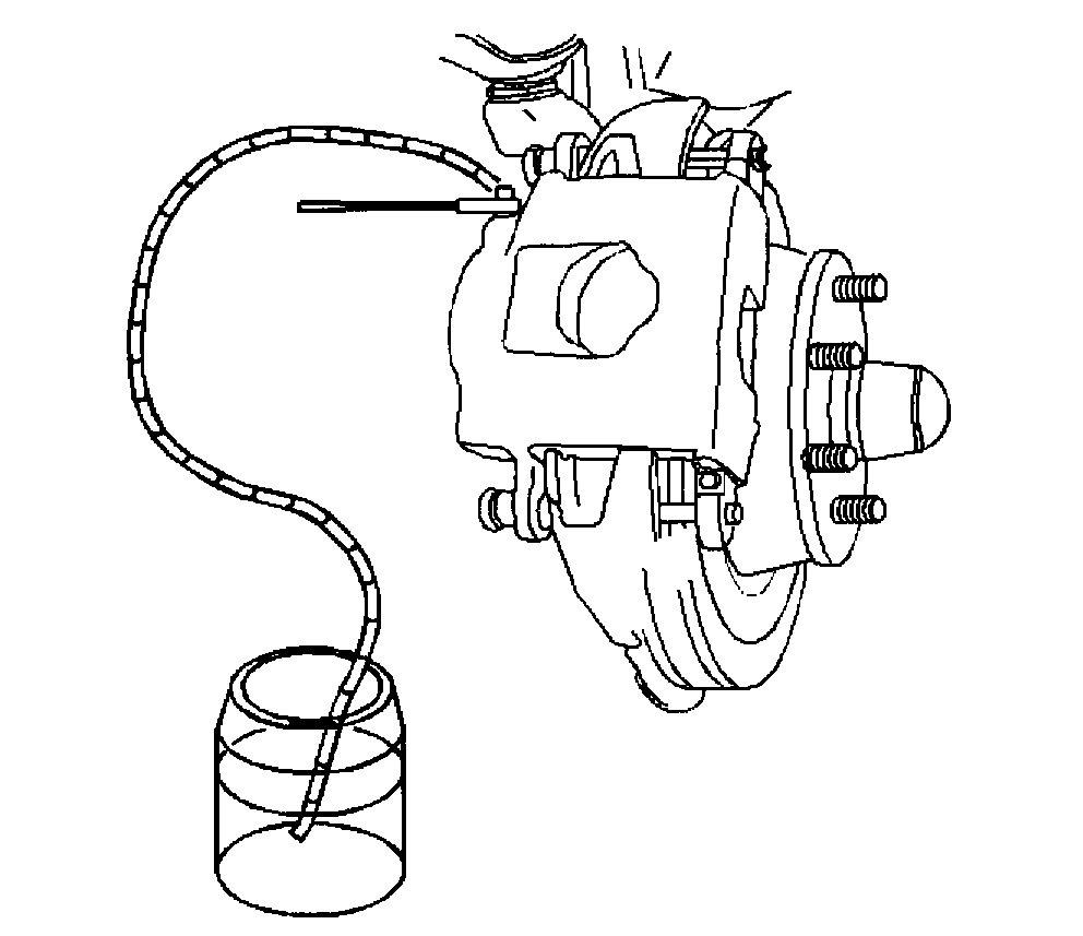

So I have the vehicle listed above k1500, 4wd, LT. I cannot get the brakes to bleed out. as soon as I pulled into work I hit the brakes and my pedal grabbed then went to the floor. made me curious. got off work had an employee hit the brake pedal and found that I had blown a hole through the brake line due to being rusted. so no one had a brake line. so I had to go old school and get plugs to plug out the line then found the brake reservoir to be bad. replaced it I cannot get the brakes to bleed out so I have brakes. anyone that could help please. it has ABS. I got new brake lines for both sides finally. Been frustrating. thanks in advance.

6. Attach a hose to the wheel cylinder/caliper bleeder valve.
7. Immerse the opposite end of the hose into a container partially filled with clean brake fluid.
8. Slowly apply the brake pedal one time and hold.
9. Loosen the bleeder valve in order to purge the air from the wheel cylinder/caliper.

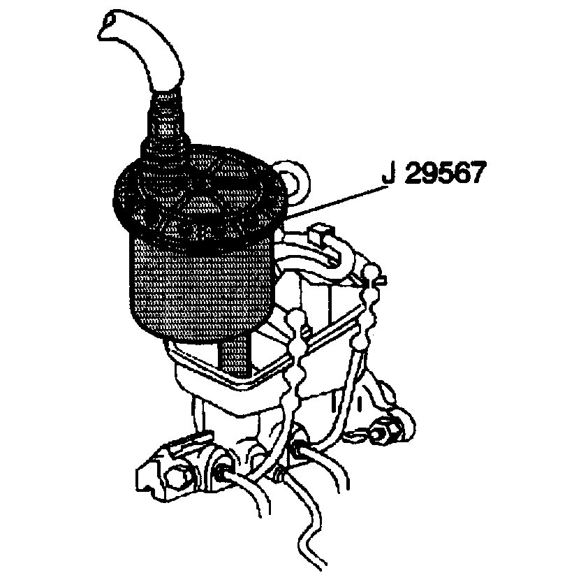

Use a diaphragm-type pressure bleeder. The pressure bleeder must have a rubber diaphragm between the air supply and the brake fluid. This prevents air, moisture, oil and other contaminants from entering the brake hydraulic system.
1. Fill the pressure tank at least 2/3 full of brake fluid.
2. Charge the pressure bleeder to 140 - 170 kPa (20 - 25 psi).
3. Bleed the pressure bleeder each time you add fluid.
4. Install the J 29567 Brake Bleeder Adapter to the master cylinder.
5. If the Brake Pressure Modulator Valve of the 4WAL system is replaced, or if you suspect that air is trapped inside, bleed the Brake Pressure Modulator Valve first.

7. Connect the hose from the bleeder to the adapter at the master cylinder.
8. Open the tank valve.
