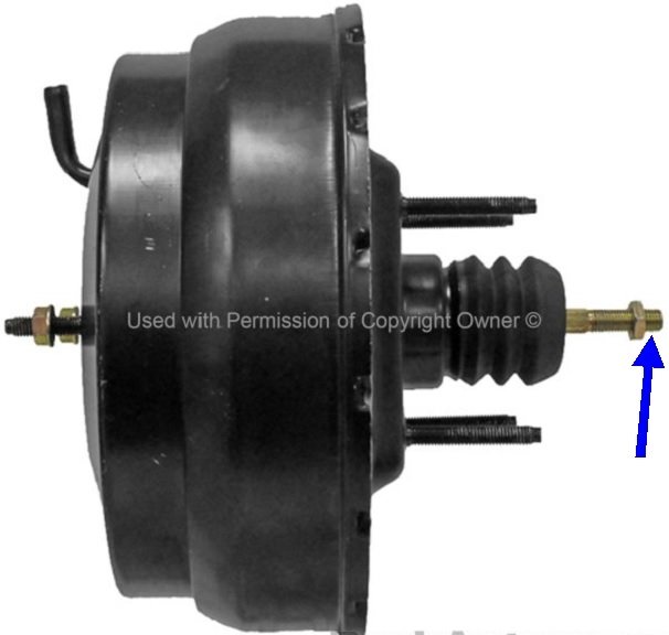

Your dandy description of the symptoms points to this not being caused by contaminated fluid. The next place to look is at the new booster and push rod. Import models commonly have an adjustable push rod as shown by the blue arrow below. The starting point is to adjust it to match the one you're removing unless the instruction sheet tells you it was already adjusted during reassembly. When the brake system is working properly, that adjustment doesn't change on its own or need to be checked. This would be the place to look if the locking problem only started right after the new booster was installed.
The better suspect now is the brake light switch is out of adjustment and is holding the brake pedal down a little. It only takes an inch of pedal travel to run the rubber lip seals in the master cylinder past the fluid return ports. That blocks brake fluid from returning to the reservoir. The dragging brakes heat up, then that heat migrates into the brake fluid, causing it to expand. Since it can't flow into the reservoir, it applies the brakes even harder. The cold winter weather might reduce how bad the symptoms are.
A good clue to verifying this is to park on a slight grade when the problem is occurring, place a block about a foot downhill of one tire, shift to neutral, then loosen the nits holding the master cylinder to the booster. Slide the master cylinder forward about 1/8". If that lets the brakes release, the cause is either the push rod in front of the booster, or the push rod going into it from the brake pedal. You can also try pulling up on the brake pedal with your foot. If the brakes release when you do that, the brake light switch is holding the pedal down a little.

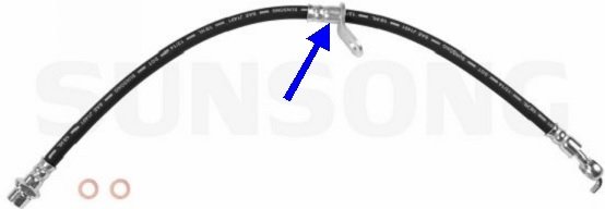

You said the rubber flex hoses were already replaced so I kind of skipped over that. This is still a good suspect if the brakes release when you open the bleeder screw on the caliper. Two defects can occur. One has to do with any model that uses a metal bracket crimped around the middle of the hose, as shown by my blue arrow. Rust can develop inside that crimp and constrict the hose. You can force brake fluid through that restriction with your foot, but the fluid can't release freely to return to the caliper. This is where its being trapped keeps the brakes dragging which builds more heat. That heat migrates into the fluid causing it to expand and apply the brake even harder.
The second defect occurs when the caliper is allowed to fall or hang freely on the hose while a brake job is being performed. That can tear the inner liner causing it to form a one-way check valve. The passage through the hose isn't very big, so it doesn't take much to block it. The best place to verify this is to loosen the soft metal line nut where the steel line connects to the rubber hose. If that is rusted tight, the next best place is where that steel line comes out of the anti-lock brake hydraulic controller.
