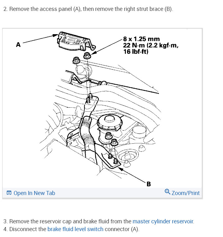

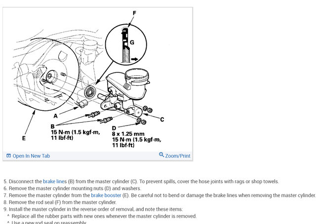

I had driven about a block and a half when all of a sudden the brakes were barely working. The brake light and ABS light lit up. I managed to inch my way home. It is raining so I can't see if brake fluid is leaking (I assume it's not that). Brakes were working fine just prior to this, no squeaking. If I can provide any other details please ask. It's been one of those years!
Oct 14, 2023 at 4:28 AM
  • 55,399 POSTS
Is the brake fluid empty? If not, it sounds like the brake master cylinder has gone out. Here is a guide to help you be sure and I have included a separate guide for the master cylinder replacement.
https://www.2carpros.com/articles/brake-pedal-goes-to-the-floor
and this guide for the brake master cylinder bleed:
https://youtu.be/WDxvEQrMkBg?si=isVrBSlkw-iN8pgQ
and
https://www.2carpros.com/articles/how-to-replace-a-brake-master-cylinder

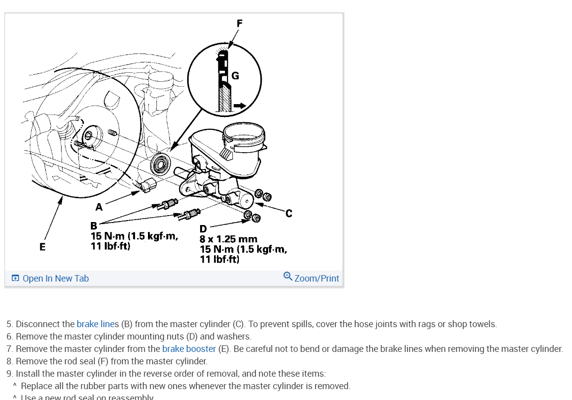

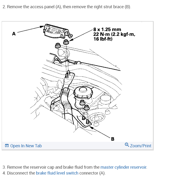

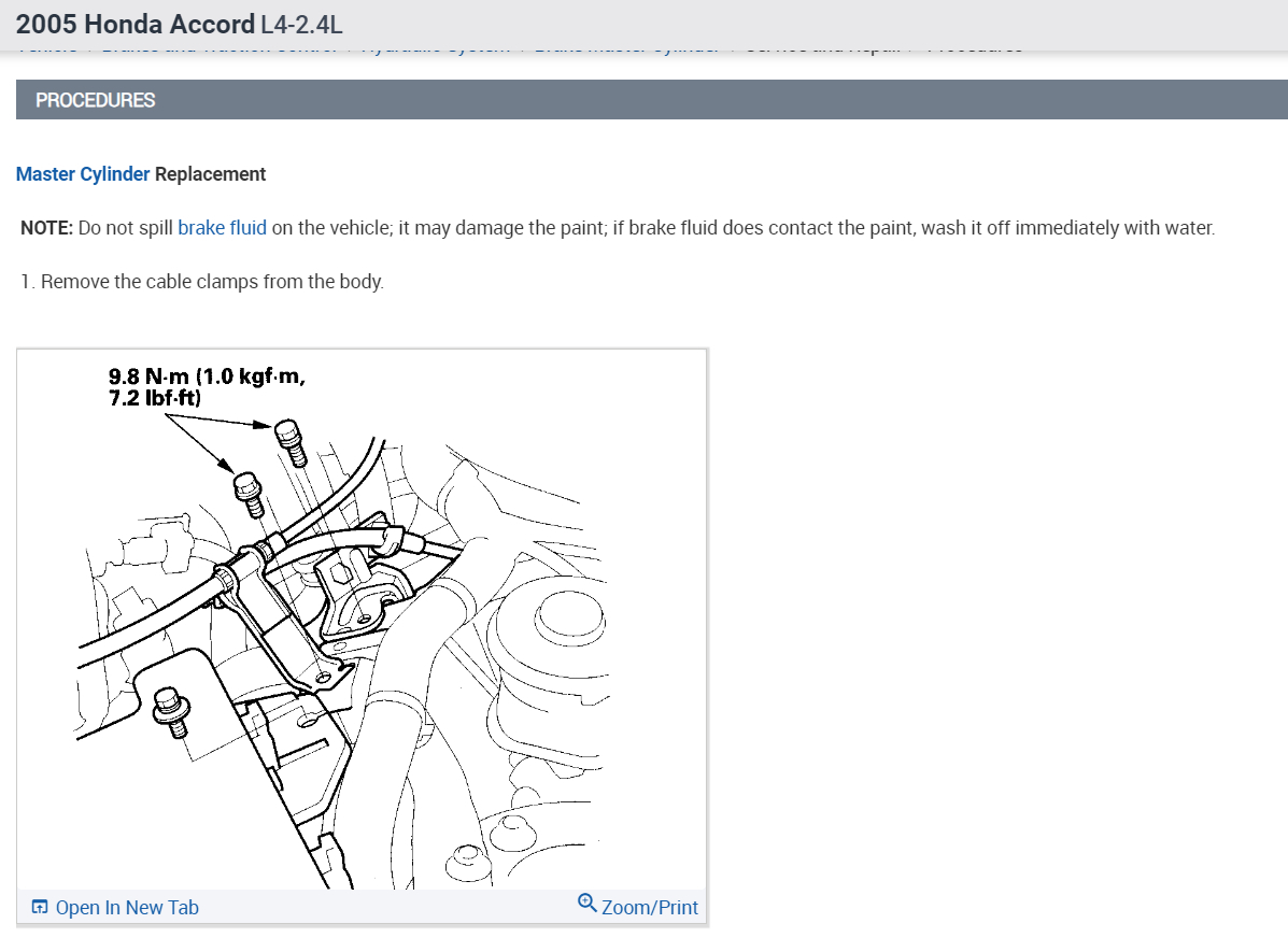

here are the instructions on how to replace the master on your vehicle. Make sure to bleed the system at the wheels when completed. Check out the images (below). Please let us know what you find.
