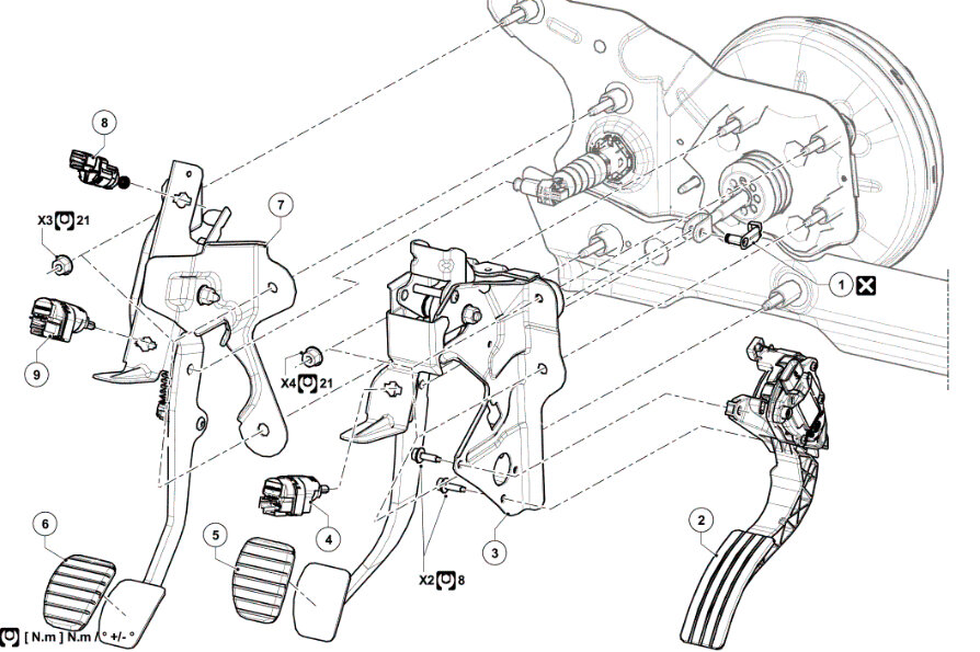

I do not see a relation between the brake pedal becoming hard and the accelerator pedal being lower and having less feel.
The pedals are not linked, except that the accelerator pedal is bolted to the side of the brake pedal bracket. The accelerator pedal is an electronic pedal. See image below.
2 is the accelerator pedal and 5 is the brake pedal

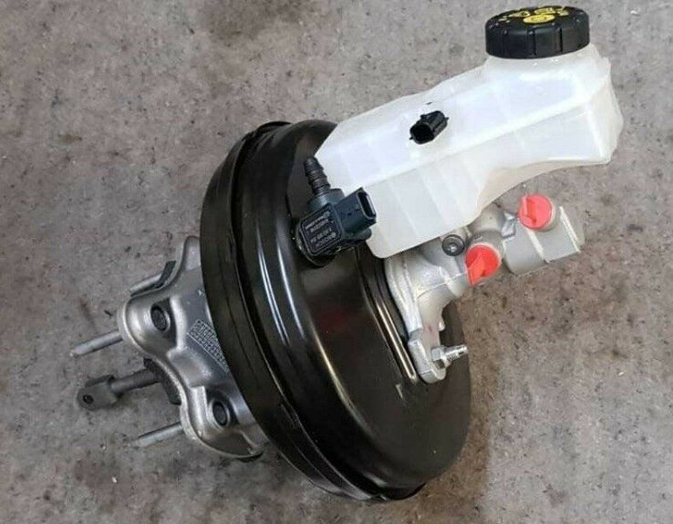

A faulty brake booster or possibly faulty vacuum supply to the brake booster could cause the brake pedal issue. see image 2 below
Also check that the bracket which holds the brake and accelerator pedal is not loose or possibly broken.

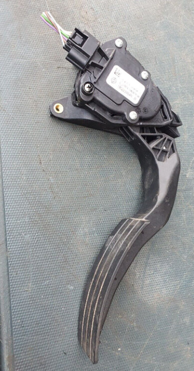

See image 3 below for the accelerator pedal.
