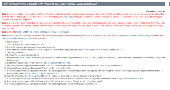

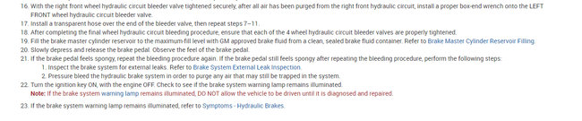

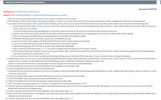

Check out the diagrams (below). follow these bleeding instructions. cheers, Nick
