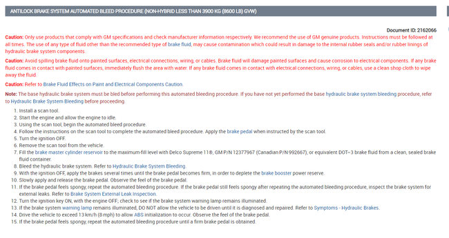

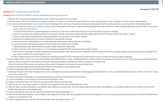

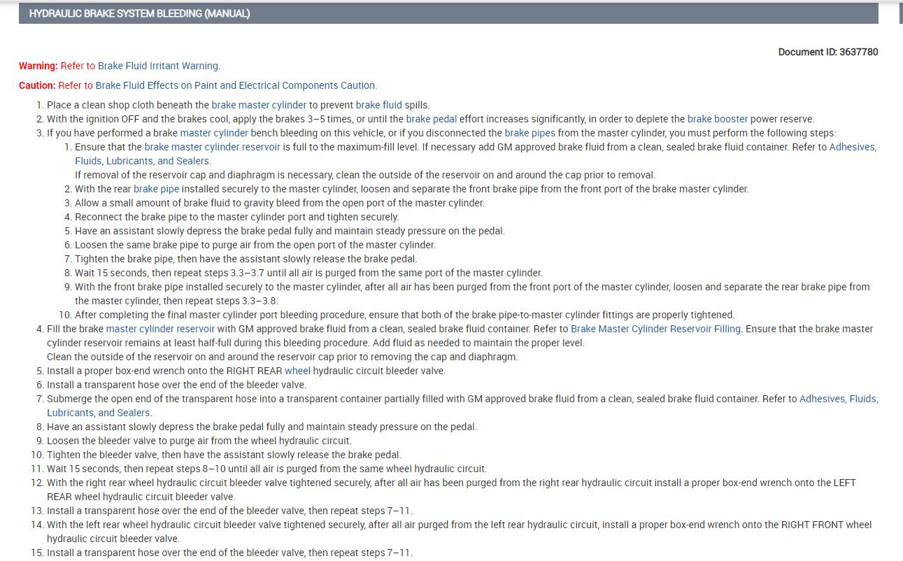

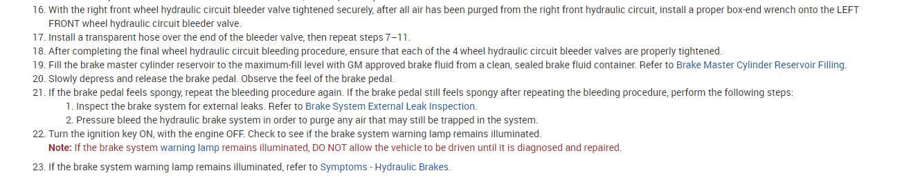

We can help with this information. was there any prior work performed before you replace parts, was it breaking prior? Let us know what happens and please upload pictures or videos of the problem. are both sides breaking,
Check out the diagrams (below). follow these bleeding instructions. cheers, Nick
