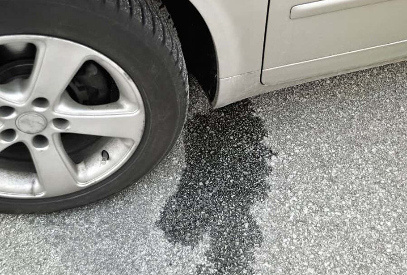

The first thing I would do is check your brake fluid level. A low brake fluid level will cause the light to come on. It's possible your vehicle may be leaking fluid on the brakes making them squeal.
Squealing can also be caused by cheap brake pads and/or rotors, too much heat, rust and others but it would happen all the time if that were the case.
I would start by checking your brake fluid and looking at the back of your wheels for any signs of a leak. Also make sure your emergency brake isn't engaged as this will cause a brake warning light as well.

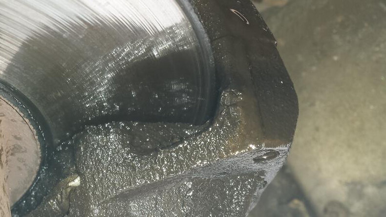

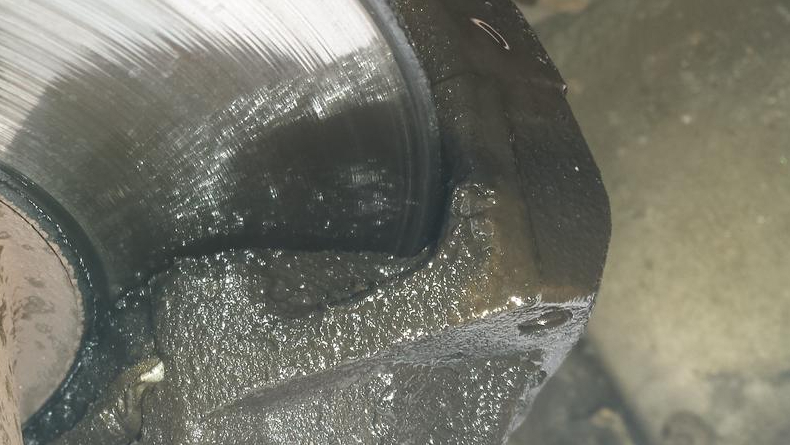

Check the brake rotors, calipers, hoses and I would also look around the inside of the rims. If they are leaking brake fluid could be on the inside of the rim from being thrown off the rotor from centrifugal force as the vehicle moves.

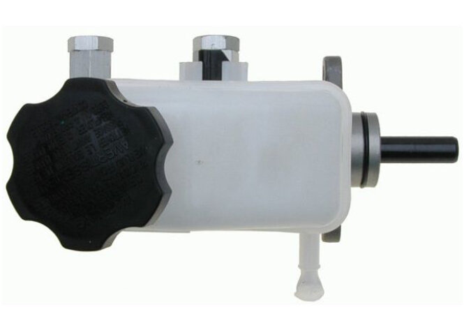

If your brake fluid is low, you can add some more. Your vehicle takes DOT 3 or DOT 4. It should say it right on the cap of the master cylinder. I will add a picture of a typical brake master cylinder for your information. Make sure you buy a new bottle though. Brake fluid attracts moisture and an open bottle of brake fluid that has been sitting around will collect moisture and cause the moisture to turn to a gas in your braking system, which is compressible unlike a fluid. So, using a new bottle of fluid is a must.

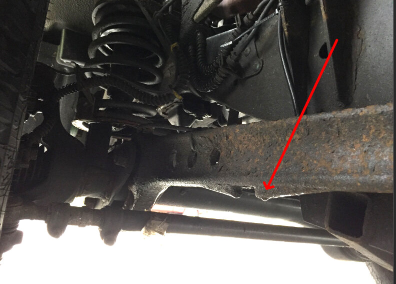

I have added a couple of examples of brake fluid leaks as well as a bottle of brake fluid of the kind I use on my own vehicles.
