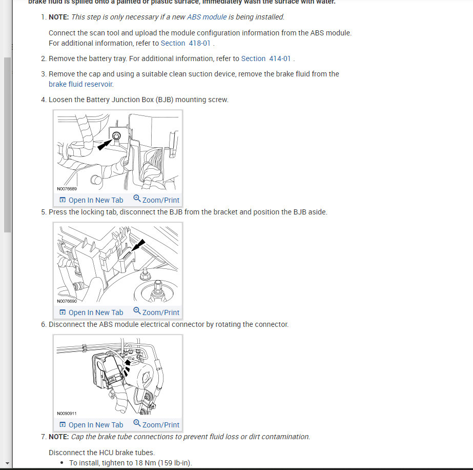

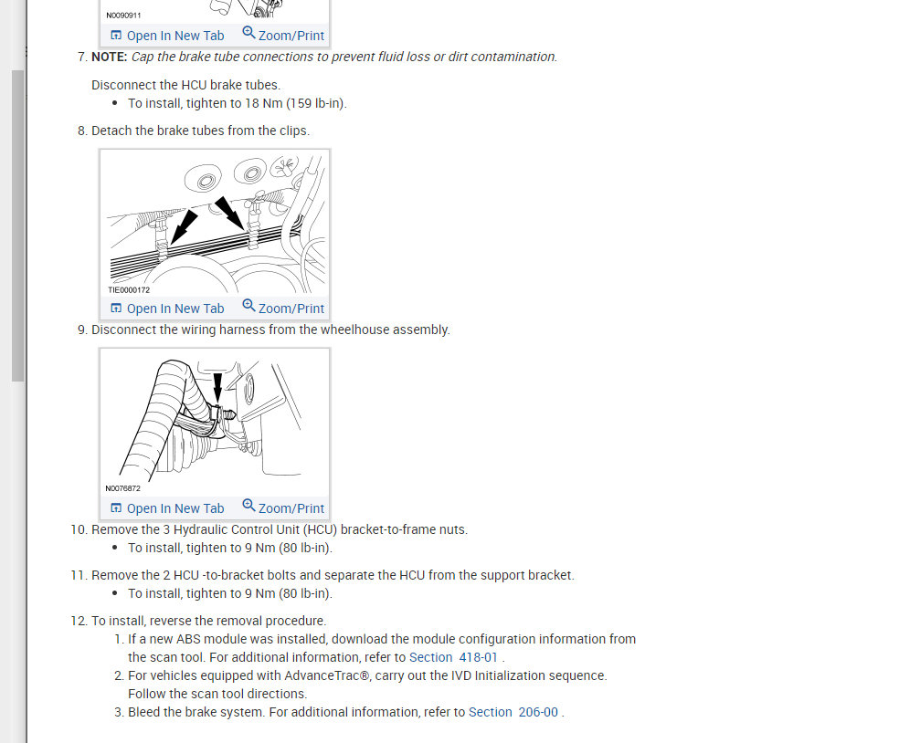

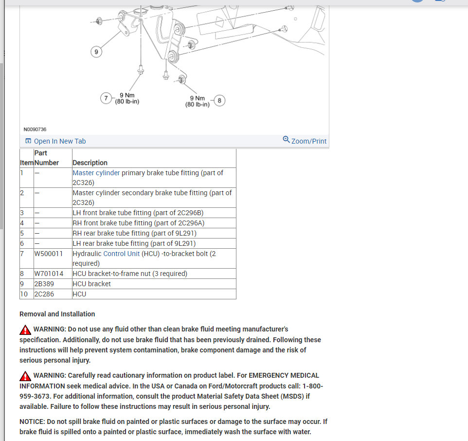

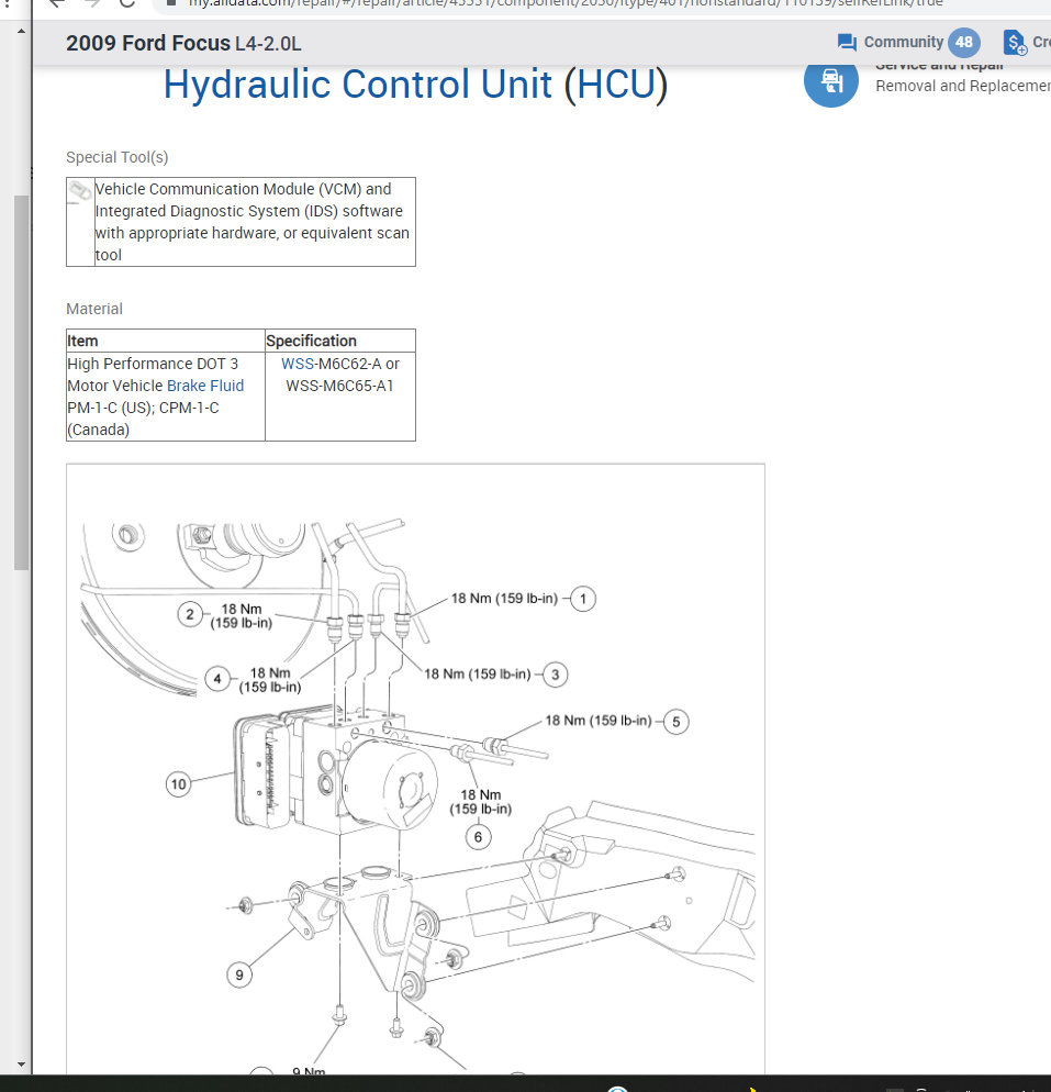

What I would do is unhook the ABS control module connectors and see if this still happens. What I suspect is happening is the ABS is activating as soon as it sees wheel speed input.
If this is the case then unplugging it so that it doesn't see the wheel speed and it should stop. If this is the case then you need to replace the control unit. Here is a guide that will help with this:
https://www.2carpros.com/articles/how-to-replace-a-abs-controller
Below you will find the process from the manual on how to replace this. Please run through this and let us know what you find.
