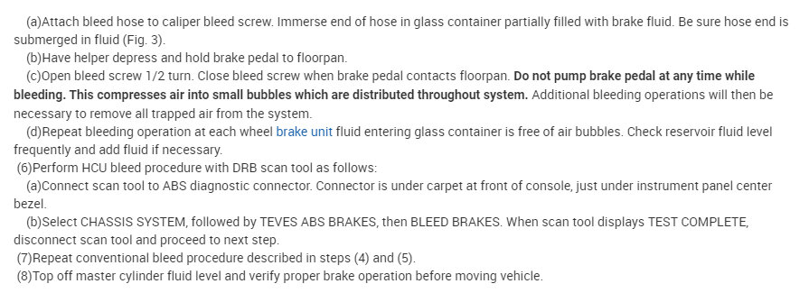

I recently had to replace all brake pads, calipers, and rotors on my vehicle. Since doing so, I’ve tried bleeding my brakes a few times and each time, when the car is off my brakes seem to have pressure but as soon as the car starts, all pressure is lost, and the pedal becomes incredibly soft/spongy. I don’t understand how to fix this issue. Thank you

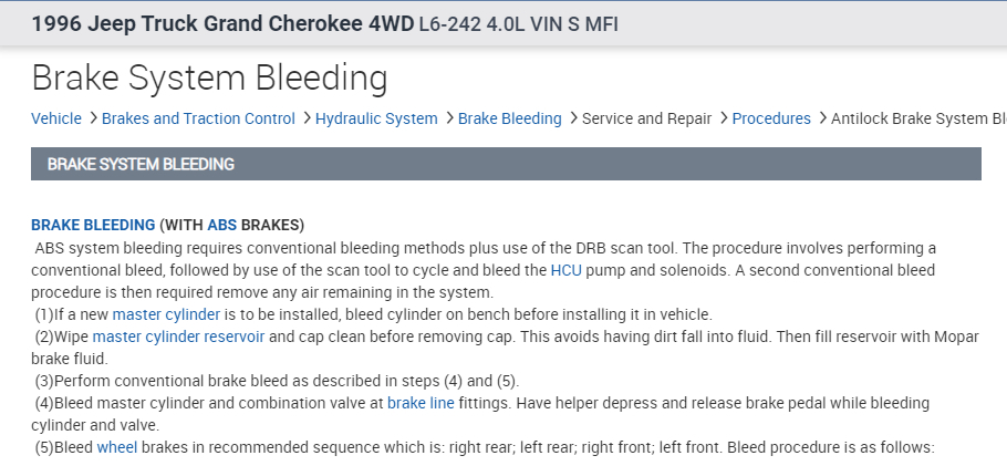

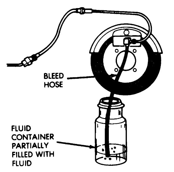

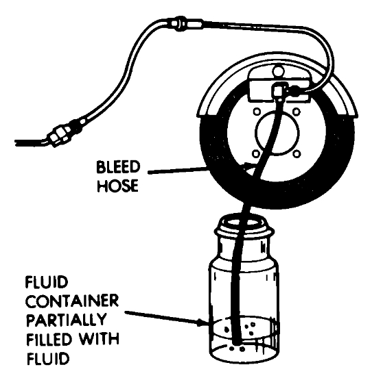

Also, when you bleed the brakes, make sure to start with the right rear, to the left rear, to the right front, and end with the left front. If you look below, I attached the directions from my manual. This is a traditional bleeding procedure.
If the vehicle has abs, then we need a scan tool that can actuate the ABS module to bleed air from the system. That is mentioned in pic 1
