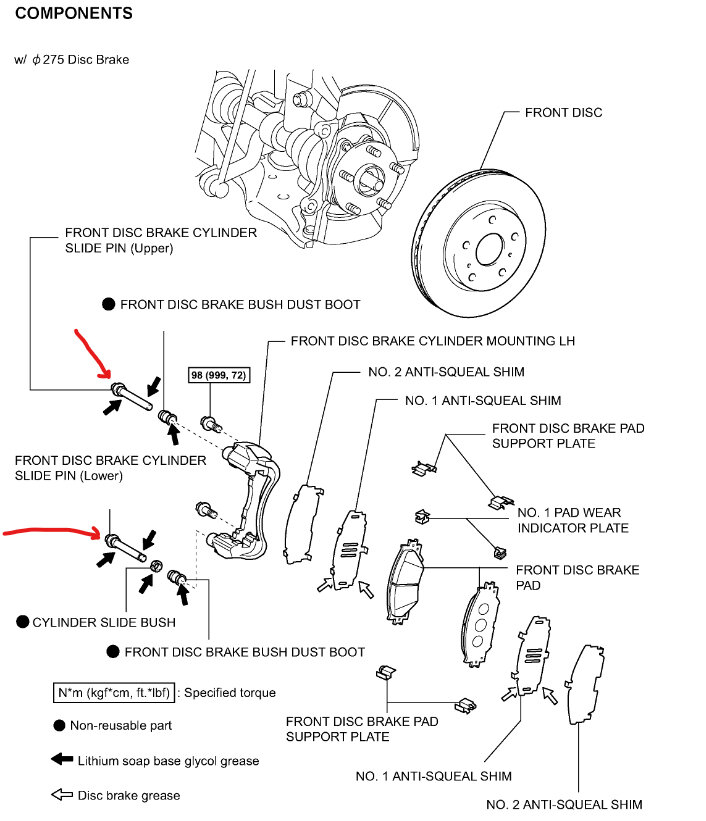

Can I ask what type/manufacturer of brake pads you are using, the reason I ask is inexpensive lifetime brake pads sometime can be super hard and not stop the car well. If this is the case, I would swap out the pads for OEM units. Here is the correct way to install the pads.
Also, I have seen seized brake caliper slides cause this issue as well. Let remove the brake calipers to check them. Can you please shoot a quick video with your phone, that way I can tell for sure what's going on. You can upload it here with your response. Check out the images (below). Let us know how it goes.

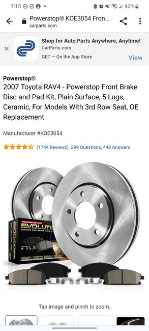

Thanks for the quick response. The brake pad and rotor were from Carparts.com and the brand is Powerstop.
Dec 27, 2023 at 8:53 AM
  • 55,104 POSTS
Yep, ceramic brakes are known to be hard and not stop as well. I would get semi metallic, also, I would get a name brand set. OEM would be best. Be sure to check the caliper slides.

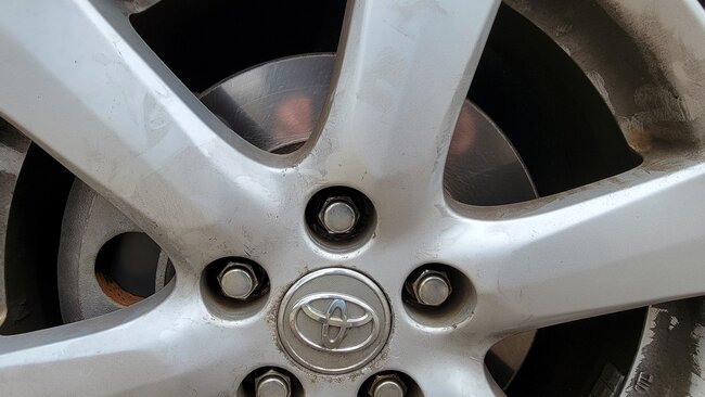

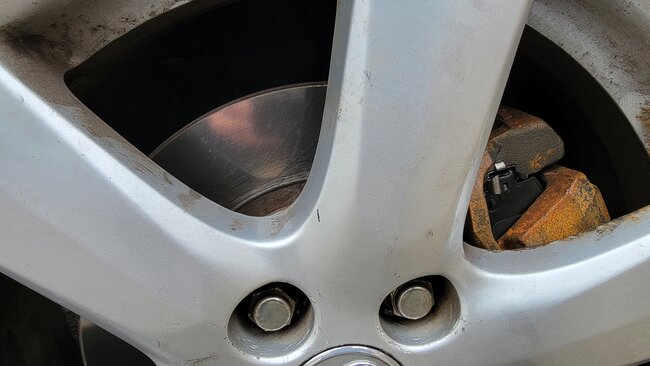

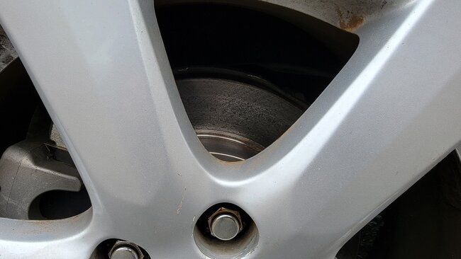

I noticed that my front brakes are wearing much faster than my rear brakes. These rotors are new, less than a week. I attached the front and rear pictures for comparison.
Dec 30, 2023 at 1:10 AM
THANVAS
  • 46 POSTS

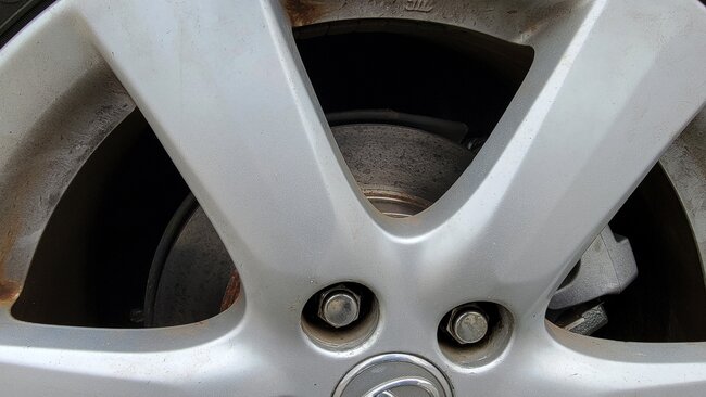

Sorry the images from the previous post are both the front brakes. These are the rear. There's also a lot of rust already on one of the calipers.
Dec 30, 2023 at 1:31 AM
  • 55,104 POSTS
Thanks for the images, those rotors don't look good at all. I would get all new rotors and pads from Rockauto.com
They have name brand parts. This should fix the problem.

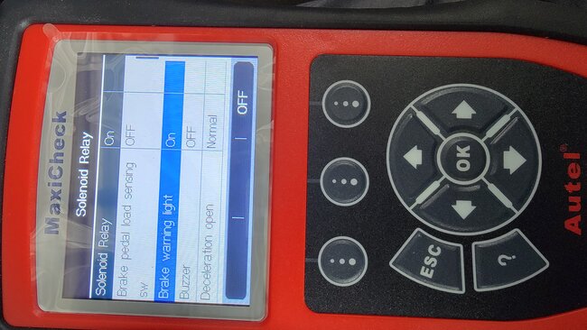

When I turn on the ABS Solenoid relay with the scanner and when the warning light is on, the ABS light on the dash turns on.
Jan 19, 2024 at 1:08 AM
  • 55,104 POSTS
That is normal for the ABS light to come on with a scanner command. Also, I would check the brake fluid level which can make the brake warning light come on. Please let me know, also if you have a different problem please start a new thread.
