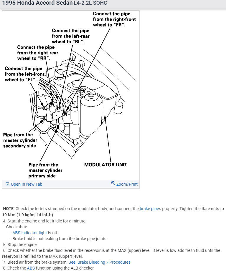

brakes seem to be locking up
1995 HONDA ACCORD
300,000 MILES • 2.4L • 2WD • MANUAL
ALAN FLEMON

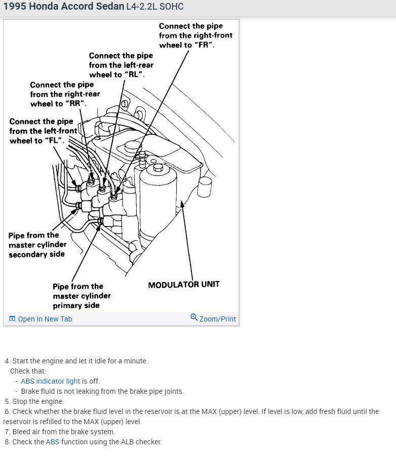

replace line, caliper, pads and front brakes are locking up.
Mar 6, 2017 at 5:21 PM
SQM
  • 6,383 POSTS

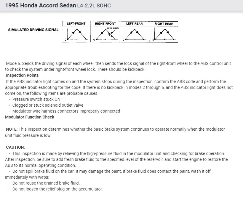

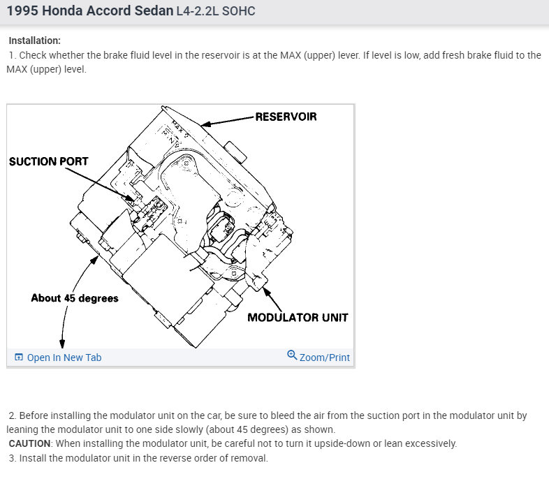

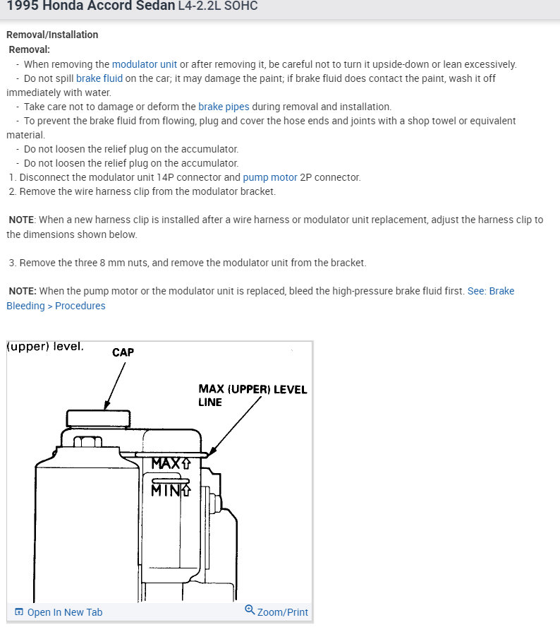

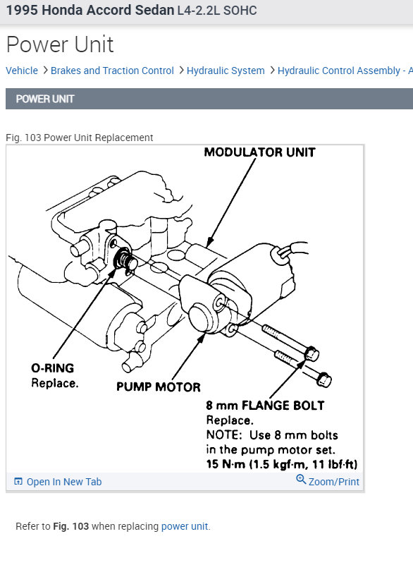

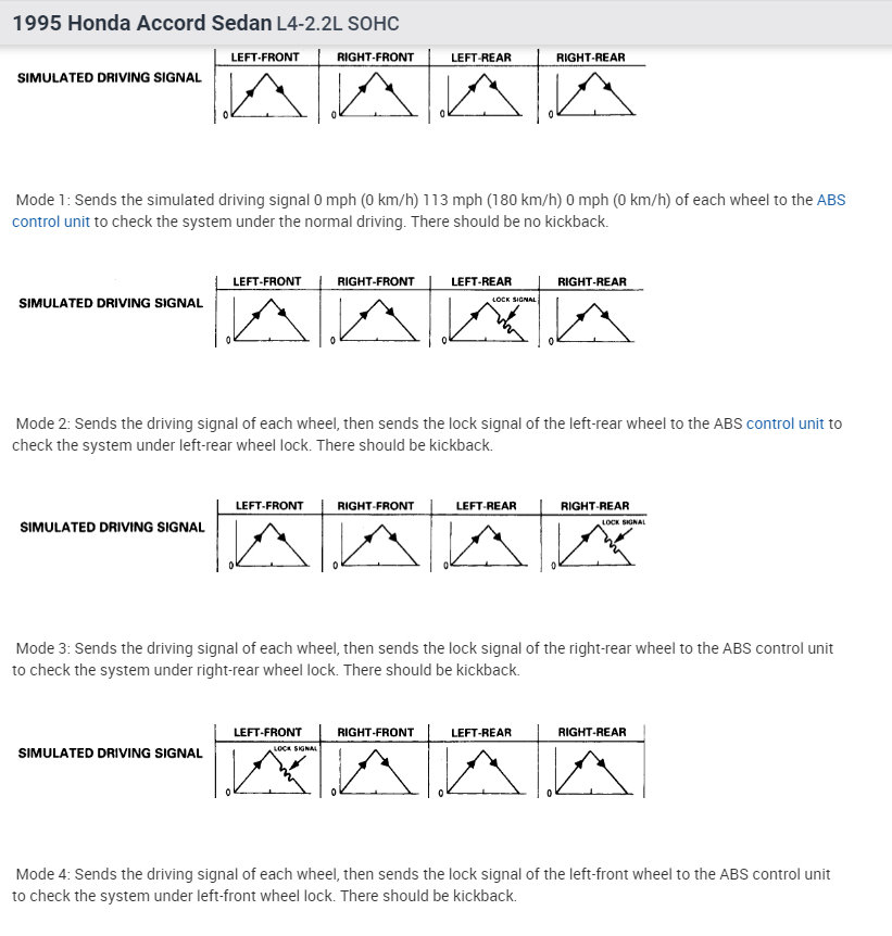

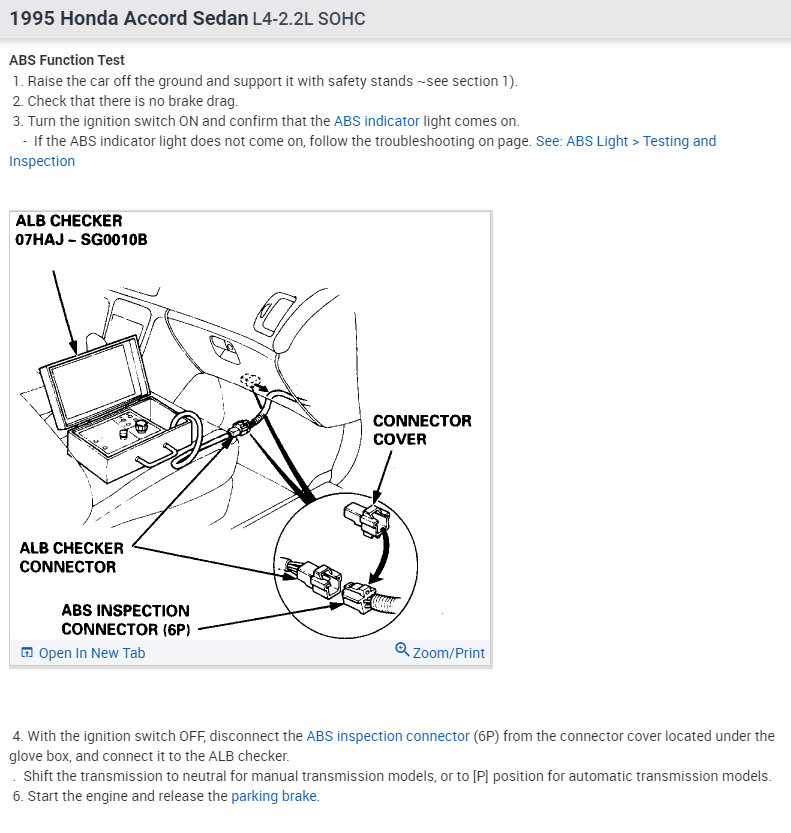

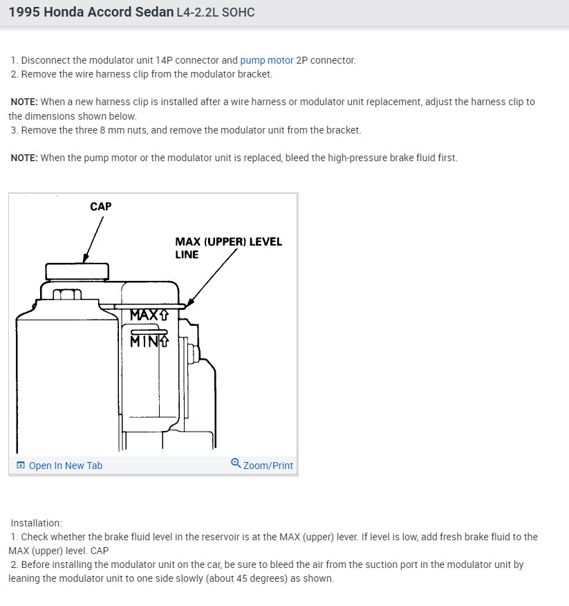

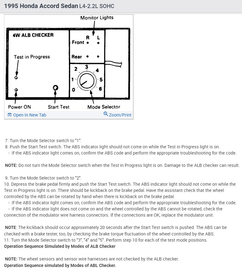

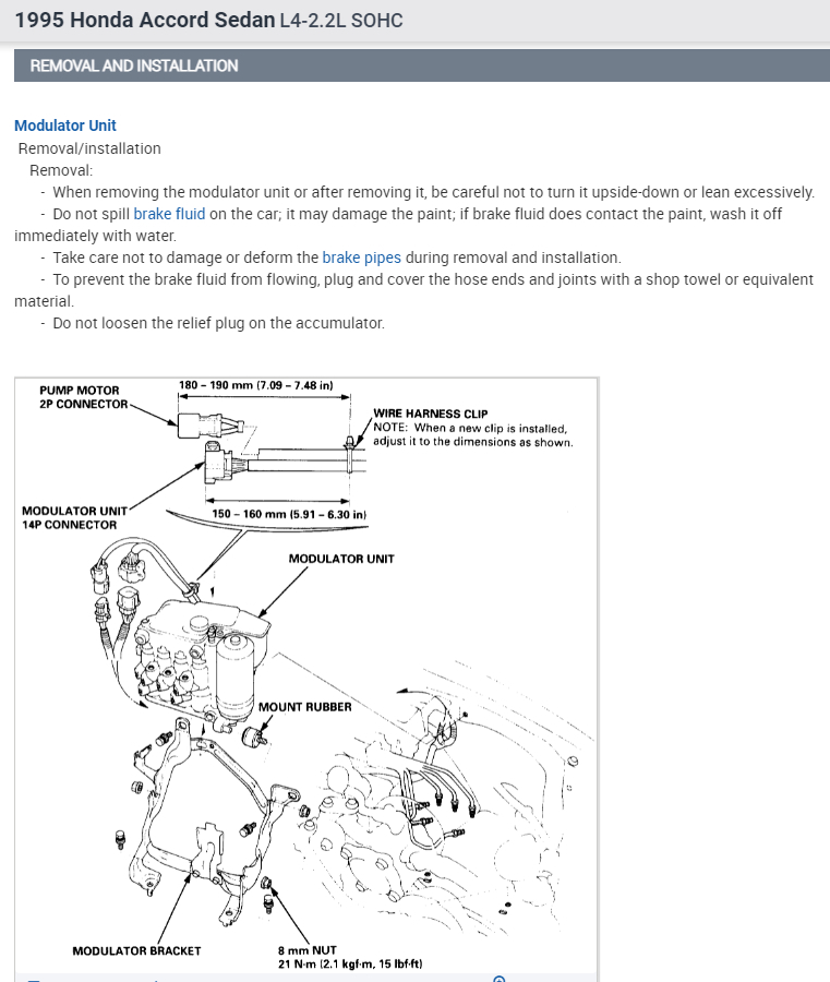

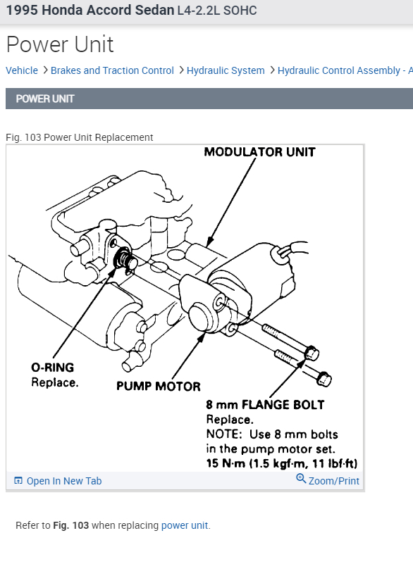

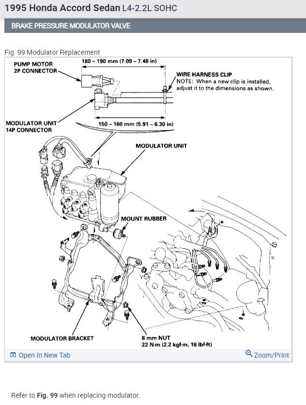

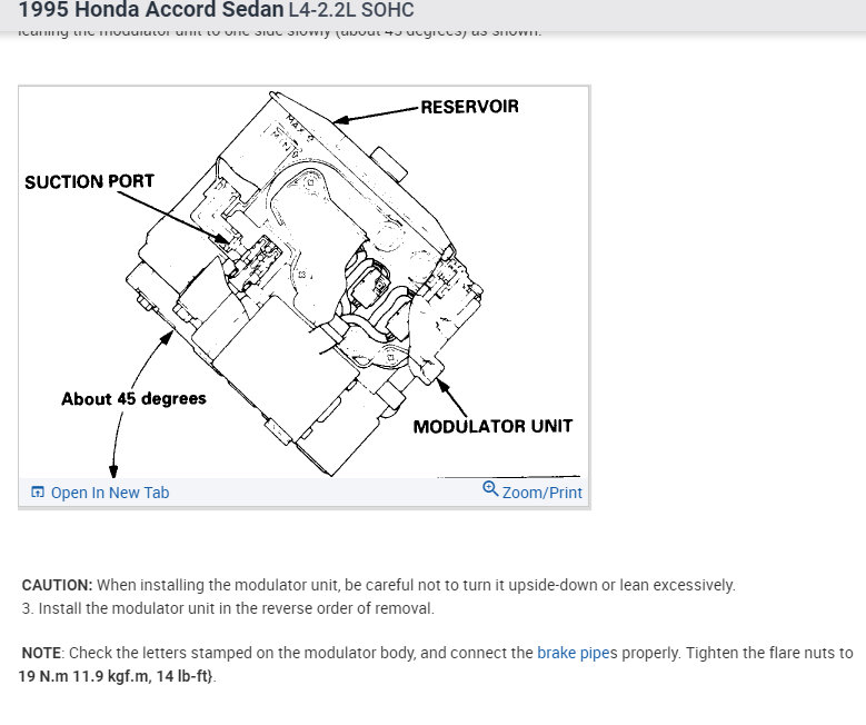

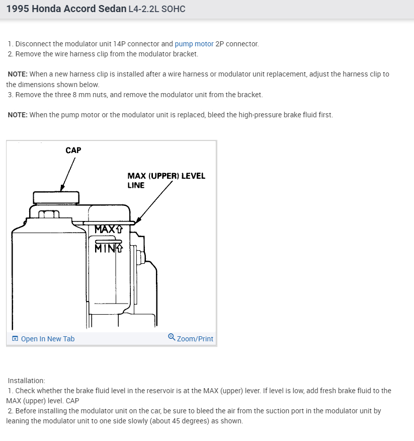

This could be due to a faulty brake modulator unit.
That unit controls brake pressure to each wheel.
Internal malfunction like a seized valve can cause brake lockup to any given wheel.
https://www.2carpros.com/articles/how-to-replace-a-abs-controller

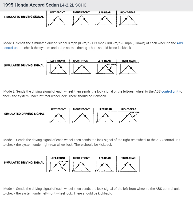

I have attached the diagrams for your reference. Also included the testing procedure for that control unit.
