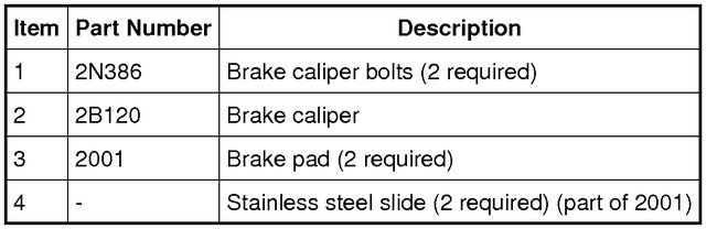

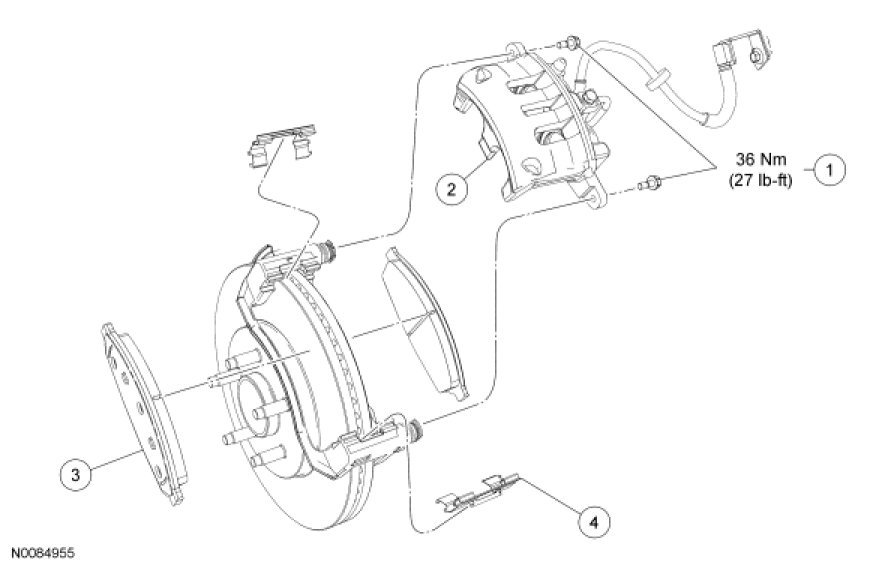

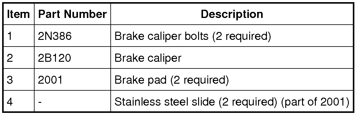

Here are the directions specific to your vehicle. The attached pics correlate with the directions.

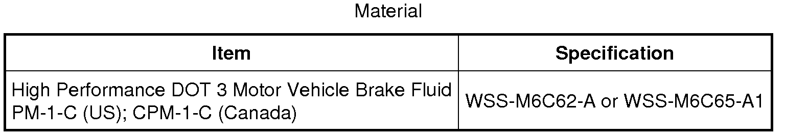

WARNING: Do not use any fluid other than clean brake fluid meeting manufacturer's specification. Additionally, do not use brake fluid that has been previously drained. Following these instructions will help prevent system contamination, brake component damage and the risk of serious personal injury.

1. Check the brake fluid level in the brake master cylinder reservoir.
- If required, remove the fluid until the brake master cylinder reservoir is half full.
2. WARNING: Before servicing a vehicle equipped with a fire suppression system, depower the system by following the procedure in Vehicle Jacking and Lifting. Failure to follow the instructions may result in serious personal injury.
Remove the wheel and tire. For additional information, refer to Wheels and Tires.
3. NOTICE: Do not pry in the caliper sight hole to retract the pistons, as this can damage the pistons and boots.
NOTICE: Do not allow the brake caliper to hang from the brake hose or damage to the hose may occur.
Remove the 2 brake caliper guide pin bolts and position the caliper aside.
- To install, tighten to 36 Nm (27 lb-ft).
- Support the caliper using mechanic's wire.
4. Remove the pads and stainless steel slides from the anchor plate.
- Discard the slides.
5. NOTICE: Protect the piston and boots when pushing the caliper piston into the caliper piston bores or damage to components may occur.
If installing new brake pads, using a suitable tool and a worn brake pad, compress the disc brake caliper pistons into the caliper.
6. To install, reverse the removal procedure.

- Fill the brake master cylinder reservoir with clean specified brake fluid. Install the brake master cylinder filler cap.
