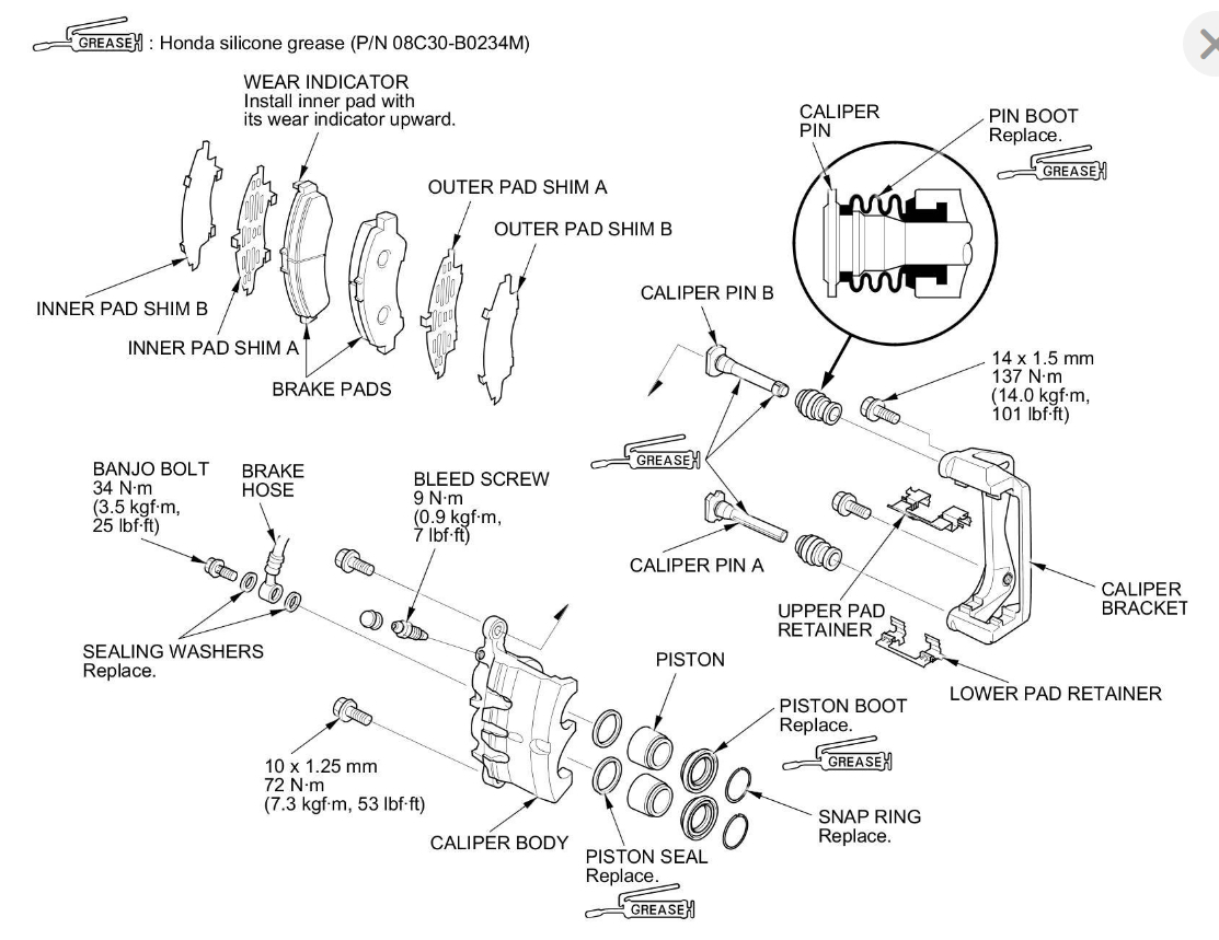

Brakes pulling
2012 ACURA MDX
96,000 MILES • 6 CYL • 4WD
JTIANO
brakes right and left when applying pressure and turning.
Sep 28, 2021 at 9:35 AM
SQM
  • 6,383 POSTS
There are few reasons why you could have brake pull.
It could be due to seized brake calipers or failure of the brake hose that does not allow even pressure to the calipers.
It can also happen due to ball joint wear or faulty control arm.
Here is a helpful article that covers the typical reasons and goes over the steps:
https://www.2carpros.com/articles/car-pulls-right-or-left-when-driving-or-braking
Run thru this and let me know what you find.
