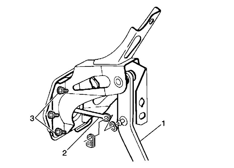

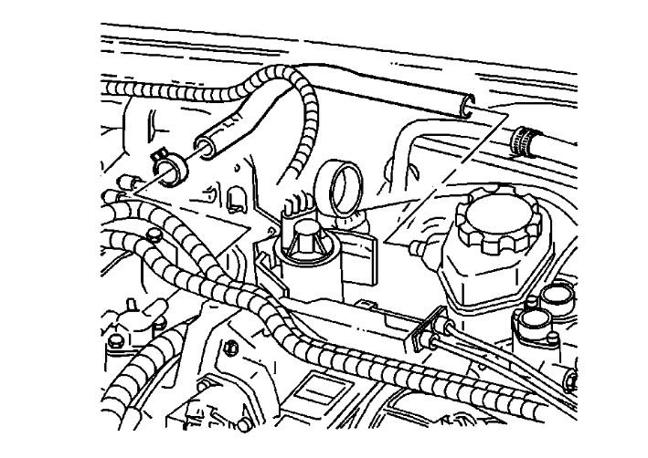

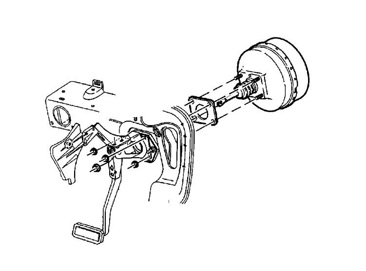

Had hard brake pedal. After master cylinder was replaced this fixed the problem. While I was trouble shooting the hard brake problem, I noticed that depressing the brake pedal would result in a whooshing air sound coming from the pedal area. After the master cylinder was replaced, the whooshing sound was still there. You can only hear it when pressing the pedal hard/fast and when you stop pressing the pedal it stops and the pedal holds. I am trying to figure out if this is of concern or not. i have read that it could be and I have also read that it is not. The brakes seem to work fine but my other vehicles do not make this sound. is this a problem or not?
Feb 13, 2019 at 7:16 AM
Good evening,
The booster has a vacuum leak and it is leaking out the shaft at the pedal.
I would replace the booster assembly.
Procedure
Power Vacuum Brake Booster Replacement
Removal Procedure
Caution: Refer to Brake Fluid Irritant Caution (See: Brakes and Traction Control > Technician Safety Information > Brake Fluid Irritant Caution).

9. Remove the heater hose from the coolant cross over pipe and reposition out of the way. Refer to Heater Inlet Hose/Pipe and Heater Outlet Hose/Pipe Replacement (See: Heater Hose > Removal and Replacement > Heater Inlet Hose/Pipe and Heater Outlet Hose/Pipe Replacement).
10. Release the fuel lines from the shock tower for easier access to the brake pipes.
11. Disconnect the fluid level sensor switch from the brake master cylinder.
12. Disconnect the brake lines from the master cylinder and remove the master cylinder. Refer to Master Cylinder Replacement (See: Brake Master Cylinder > Removal and Replacement > Master Cylinder Replacement).
13. Remove the brake pressure modulator valve (BPMV) assembly and bracket. Refer to Brake Pressure Modulator Valve Replacement (See: Hydraulic Control Assembly - Antilock Brakes > Removal and Replacement).
