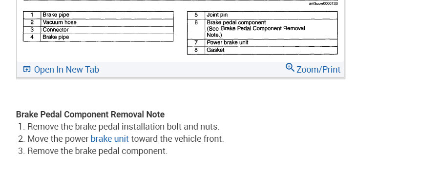

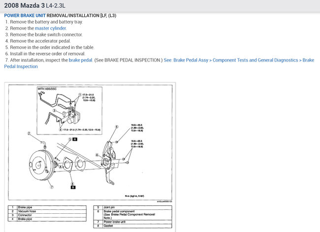

Yes, the booster is most likely the problem, here is a guide to help and instructions in the images below to help you change it out:
https://www.2carpros.com/articles/a-comprehensive-guide-to-fixing-automotive-brakes-locking-up
There are two primary components you might want to focus on: the master cylinder and the brake booster.
Check out the images (below). Please let us know if you need anything else to get the problem fixed.

There really isn't an adjustment. I attached the directions for the pedal inspection below for you. That is the only thing I have in my manual as far as inspect/adjust.
