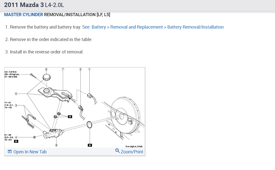

Yep, it sounds like the master cylinder is defective and the internal plunger is not returning fully which causes the brakes to lock up. Here is a guide to help explain the problem.
https://www.2carpros.com/articles/a-comprehensive-guide-to-fixing-automotive-brakes-locking-up
Here are the instructions on how to change the brake master out correctly and a video to show you how to bench bleed it.
https://youtu.be/WDxvEQrMkBg
