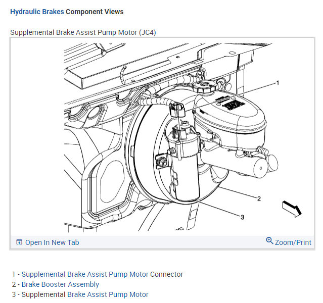

This is common when the brake booster push rod needs to be adjusted inward. When the brakes are locked please loosen the brake master mounting bolts if this is the problem the truck will roll once again. Please let us know.

The booster's push rod is of an unusual design and it's recessed to where you can't get at it. Adjustable push rods like Ken mentioned used to be common on import vehicles, but the suggestion is still sound as for loosening the master cylinder's mounting nuts a few turns. Along with GM's uncommon designs comes some unusual problems too. Some of their boosters actually have two separate diaphragms inside, and both are needed to get the proper power assist, and either one can develop a problem that might hold the master cylinder partially-applied. This is where it will release if the mounting nuts are loosened.

I loosened the mounting bolts from 5 threads showing to 3 threads showing and I took it for a ride the brake light came on for about a minute then went off. but my trip was shortened when the left front tire started to shake out of control so I turned around but the brakes did not lock up.

I would second the brake booster there is a technical service bulletin( #PIT3665J: Brake Pedal Moves or Self Applies at Full Turns - (Jun 26, 2020))
Condition / Concern
On vehicles with a Hydro-Boost System, customers may notice during full lock turns or near full lock turns that the brake pedal will move down or self apply. This can be caused by the internal dump valve of the hydro-boost not seating properly due to contamination in the steering system. The hydro boost assembly is not tolerant to certain types of contaminates that may be present in the steering system.
Recommendations / Instructions
The Hydro-Boost System is not serviceable and must be replaced.
Important: —Before replacement of the Hydro-Boost System, the entire steering system (including power steering pump, lines, cooler, and gear box) must be flushed to avoid a reoccurrence.
