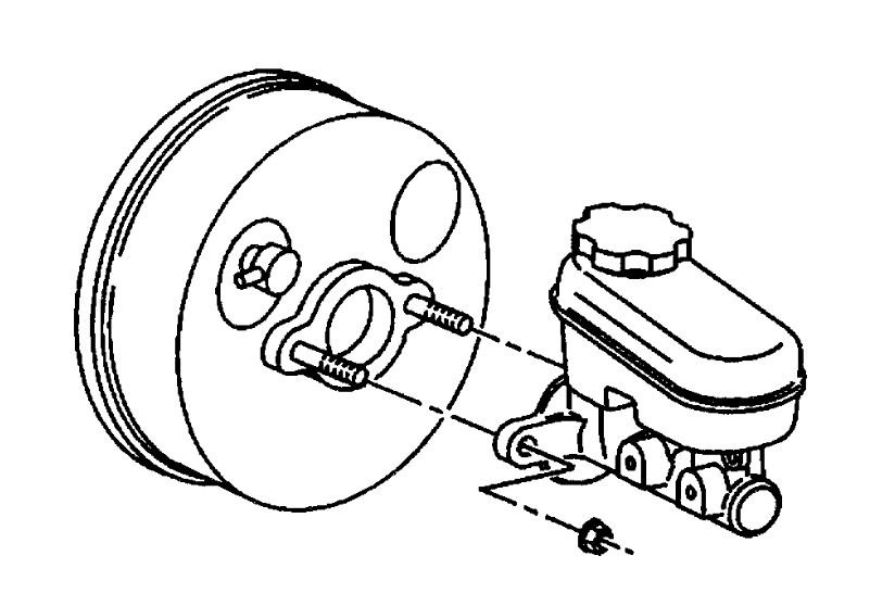

Had rear brakes done about a month ago and have had no trouble until today. Except my parking brake hasn't worked in a month. So today I notice my brake pedal is going all the way to the floor almost not stopping my truck at all. I have a friend look at it an he tries bleeding the brakes. That worked great for about 20 minutes then back to the floor and the Brake light comes on but if you tap the brakes again it will go off. Oh and now the parking brake is working. I have no clue what's going on but would love any advice? TIA
Jun 11, 2020 at 4:49 PM
Good morning,

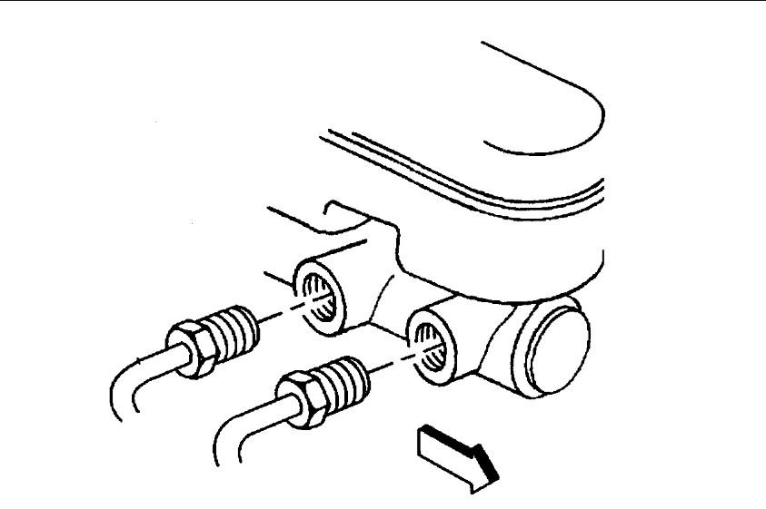

This sounds like you need a master cylinder for the brakes. The seals internally are not holding pressure at all.
https://www.2carpros.com/articles/how-to-replace-a-brake-master-cylinder
https://www.2carpros.com/articles/how-to-bleed-or-flush-a-car-brake-system
https://www.2carpros.com/articles/brake-pedal-goes-to-the-floor
I attached the bleeding process for you below as well.
As far as the parking brake, I bet they adjusted the rear brakes and that took care of the parking brake issue.
