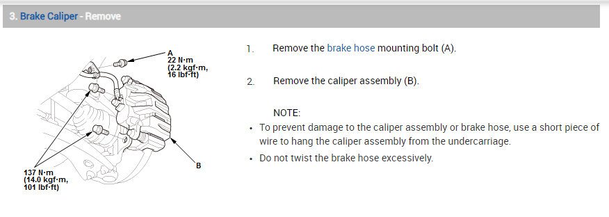

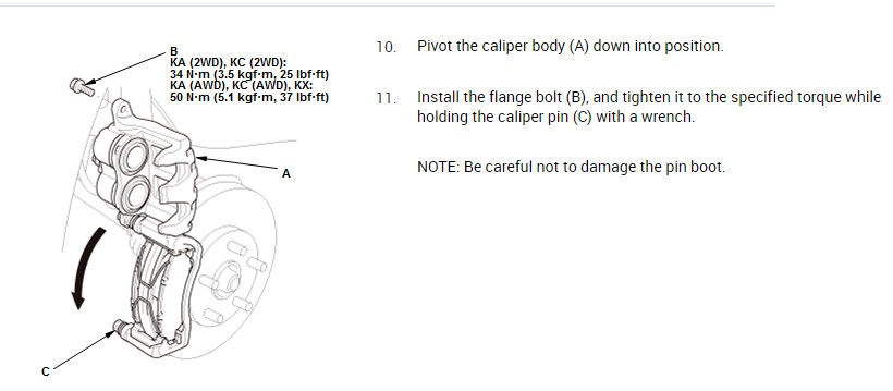

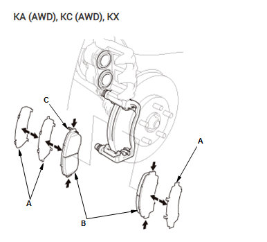

Hello: We just purchased the vehicle listed above EXL model. It is still under a 90 day warranty. The brakes work, however after traveling for 20 miles or so the brakes will still work but push to the floor. The dealership says that is fine and not problem after inspection but I think I need new front brake can you help me please?

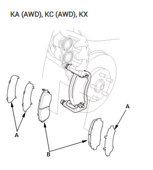

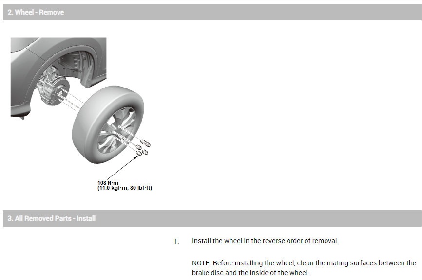

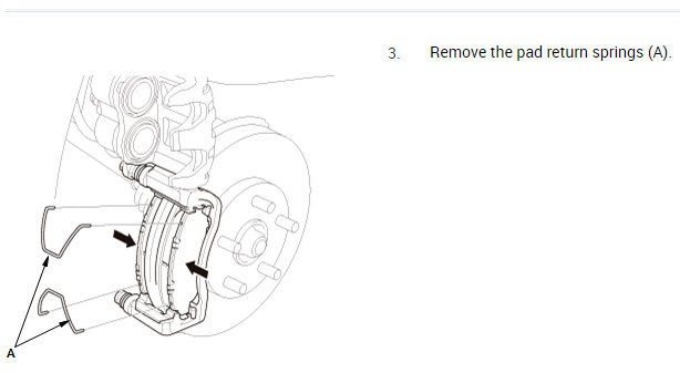

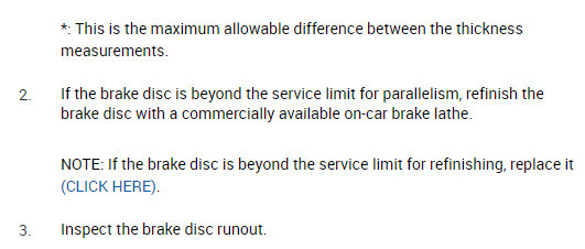

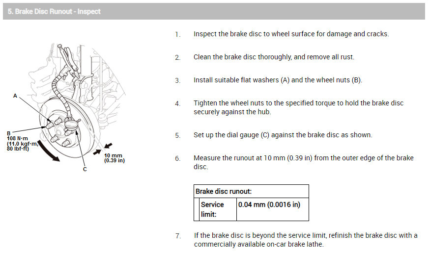

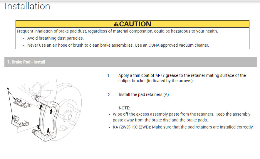

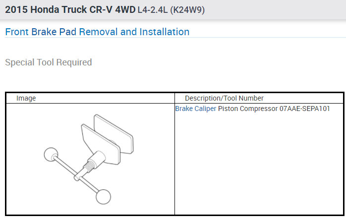

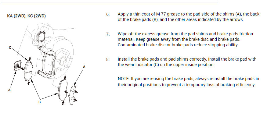

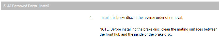

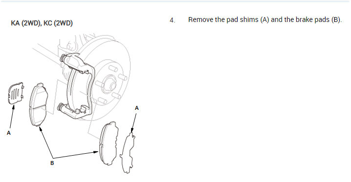

Hello, I'm Danny.

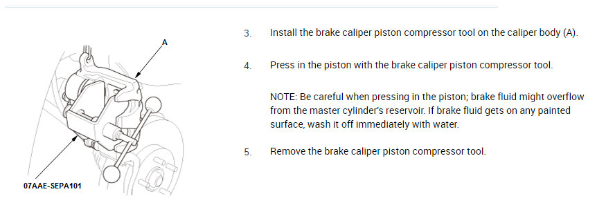

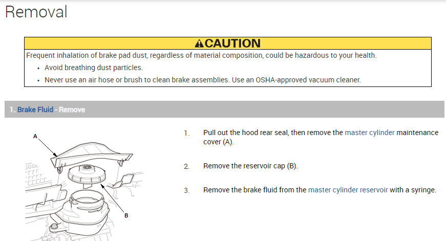

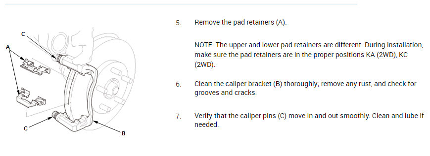

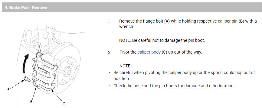

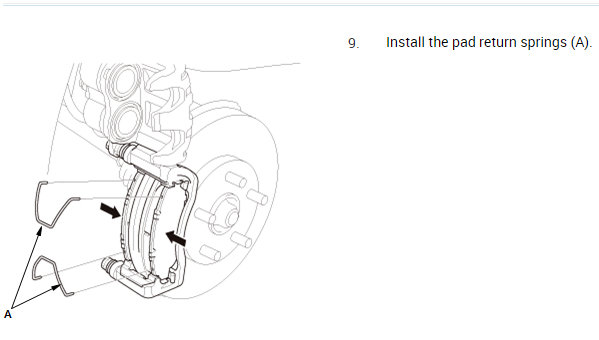

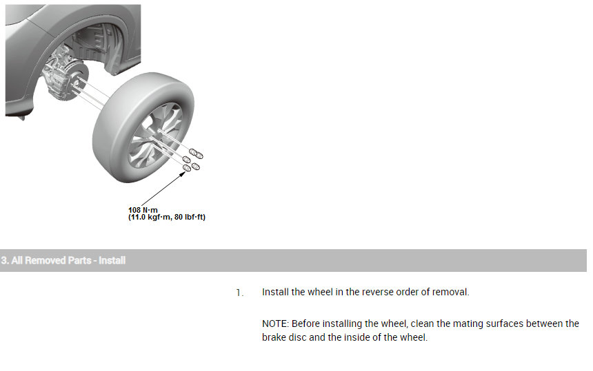

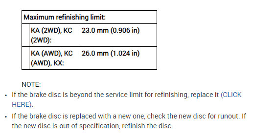

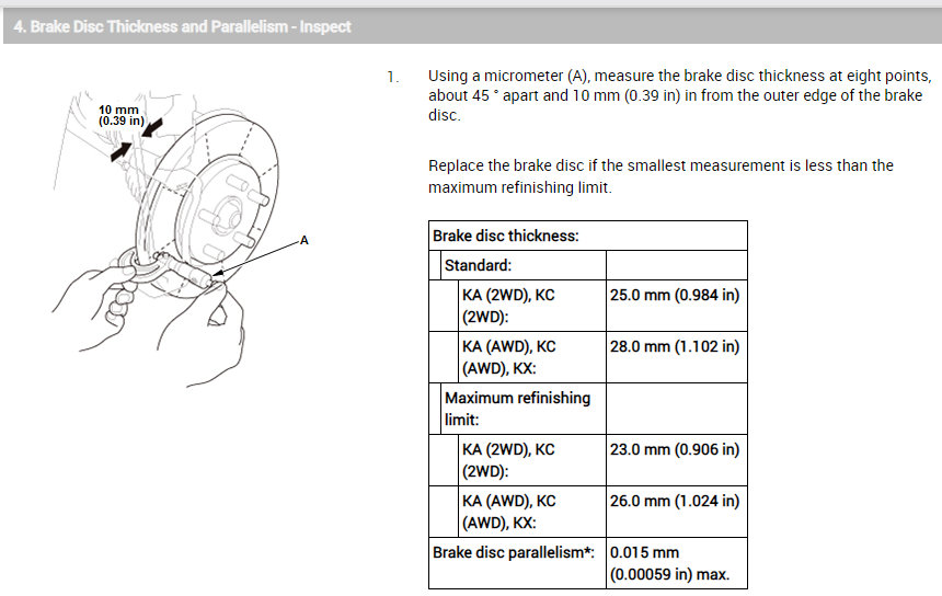

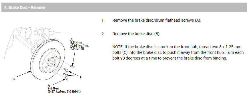

Here is the information you requested. This is a tutorial showing what is involved on how to change front brake pads and brake rotors:
I've attached picture steps below on how to change the front brake pads and rotors on your car. Hope this helps and thanks for using 2CarPros.
