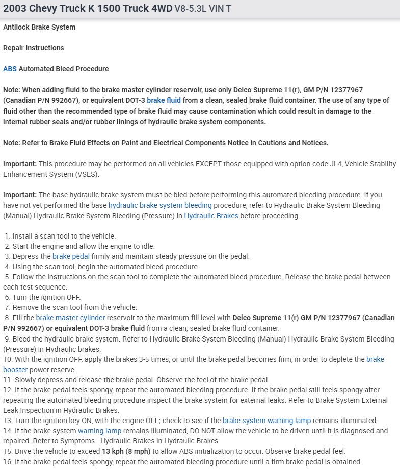

I put new calipers and lining on rear bleed lines but pedal went to floor
I see no leaks fluid full but no pedal. It stops truck but seems soft pedal.

Did you use the ABS brake bleeding when you performed the bleeding?
These ABS systems require different procedures in order to bleed properly and have the proper brake pedal pressure.
Here is a helpful video on ABS brake bleeding:
https://youtu.be/nQRnKyVyMuQ
I have attached the procedure below.
Let me know of any questions.

Had the ABS bled, but the pedal went to the floor. no leaks. what the next move?

If you bled the ABS system with the scan tool but still getting soft pedal, then master cylinder or the ABS module could be the culprit.
Did you have soft pedal before replacing the caliper and lines?

No, discovered caliper bad when changing rear brake pads. Put new calipers rear brake pads
Blead all 4 wheels pedal went to floor. I put a new master cylinder on today but still pedal goes to floor after bleeding all 4 wheels. I am thinking of replacing the brake booster tomorrow.
Any ideas what’s wrong?

The only other component that is left would be the Hydraulic module. But it does not explain why this would happen after the replacement of the components. You are not losing any fluid are you?
