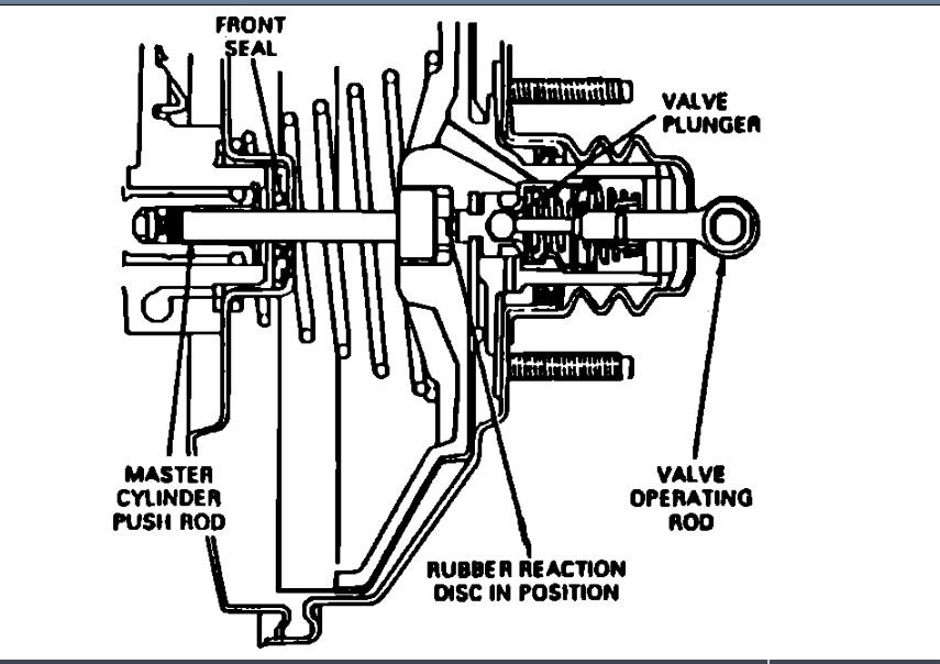

Push brakes and they barely work. They go straight to floor with ease. Fluid level drops very fast to nearly empty within short period. When finding where the leak was coming from, it doesn't leak until the pressure is released from pumping brakes and seems to be leaking from bottom of break booster. what do I need to do?

Sounds like the master cylinder is leaking into the booster.
I would replace the master and the booster and bleed the lines.
Master
WITH POWER BRAKES
1. With engine off, depress brake pedal to expel vacuum from brake booster system.
2. Disconnect hydraulic lines from master cylinder.
3. Remove brake booster to master cylinder retaining nuts and remove master cylinder from brake booster.
4. Reverse procedure to install and perform system brake bleeding procedures, then refill master cylinder and bleed it.
