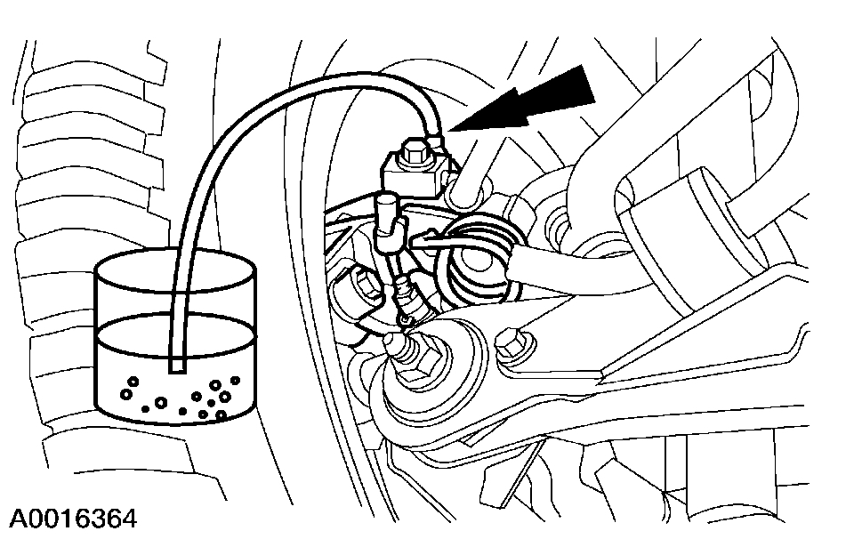

I installed a new master cylinder and wheel cylinders bleed the master and the entire brake system. I can pump the brakes with the car off and they get hard. But once I start it the pedal goes to the floor. I checked for leaks or bad rubber lines and nothing is leaking. No abs light or brake light on in the dash. Any ideas?

I am going to provide the directions for bleeding the entire system. See if it is what you have already done. Also, what you are describing sounds like a bad master cylinder, but I realize you just replaced it. Is it a new unit or re-manufactured?

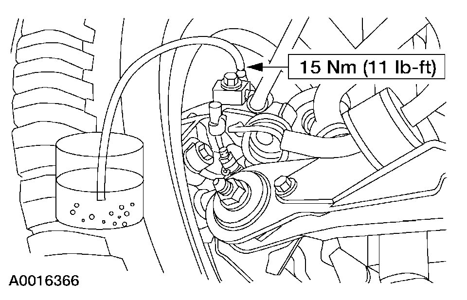

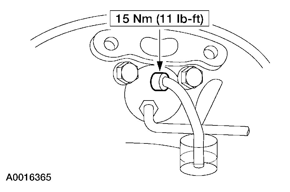

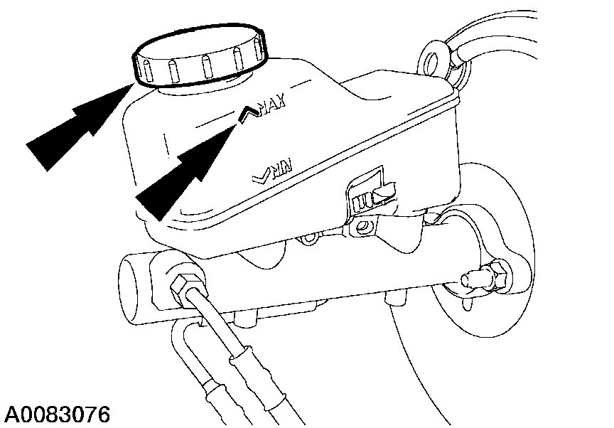

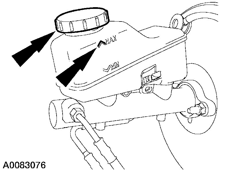

1. Clean the area then remove the brake master cylinder filler cap and fill the brake master cylinder reservoir with the specified brake fluid.
Vehicles with rear drum brakes

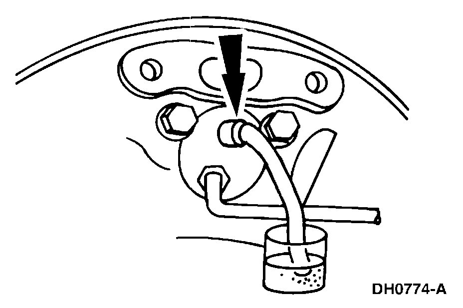

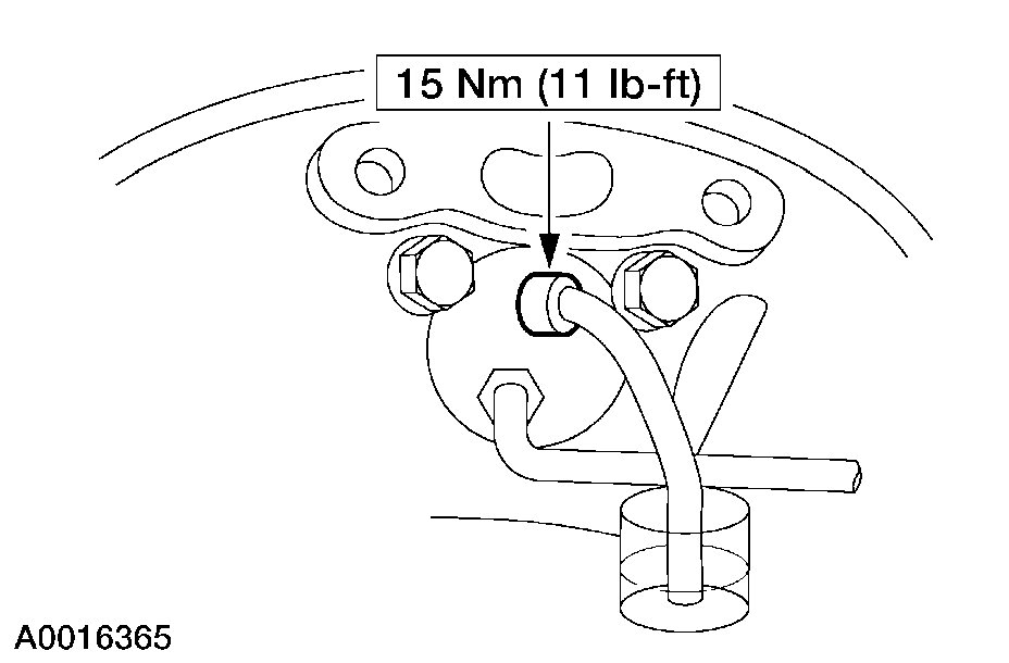

2. Place a box-end wrench on the RH rear bleeder screw. Attach a rubber drain tube to the RH rear bleeder screw and submerge the free end of the tube in a container partially filled with clean DOT 3 motor vehicle brake fluid.
Vehicles with rear disc brakes

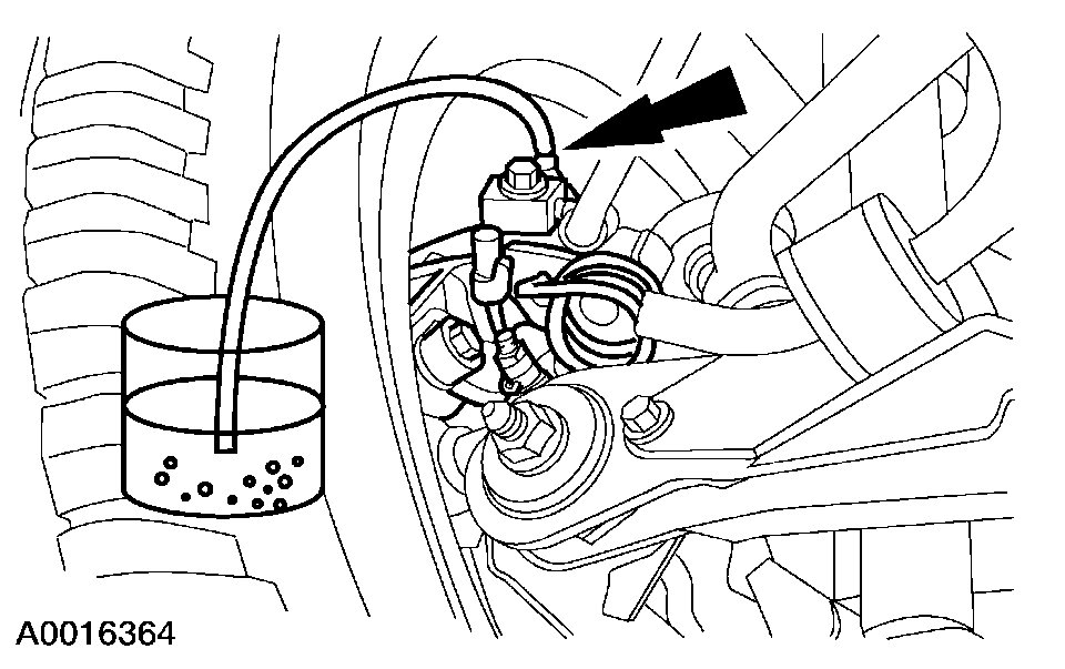

3. Place a box-end wrench on the RH rear bleeder screw. Attach a rubber drain tube to the RH rear bleeder screw and submerge the free end of the tube in a container partially filled with clean brake fluid.
All vehicles
4. Have an assistant pump, and then hold firm pressure on, the brake pedal.
5. Loosen the RH rear bleeder screw until a stream of brake fluid comes out. While an assistant maintains pressure on the brake pedal, tighten the RH rear bleeder screw.
^ Repeat until clear, bubble-free fluid comes out.
^ Refill the brake master cylinder reservoir as necessary.
6. Tighten the RH rear bleeder screw.
7. Tighten the RH rear bleeder screw.
All vehicles
8. Repeat Steps 2 through 7 for the LH rear bleeder screw.

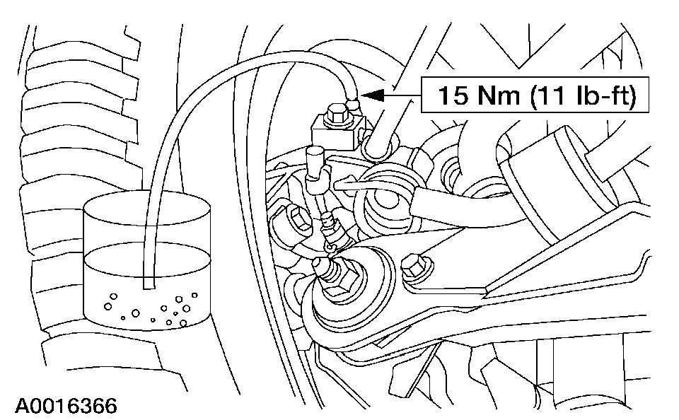

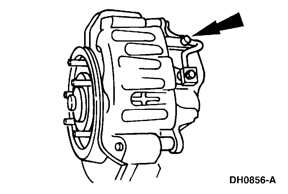

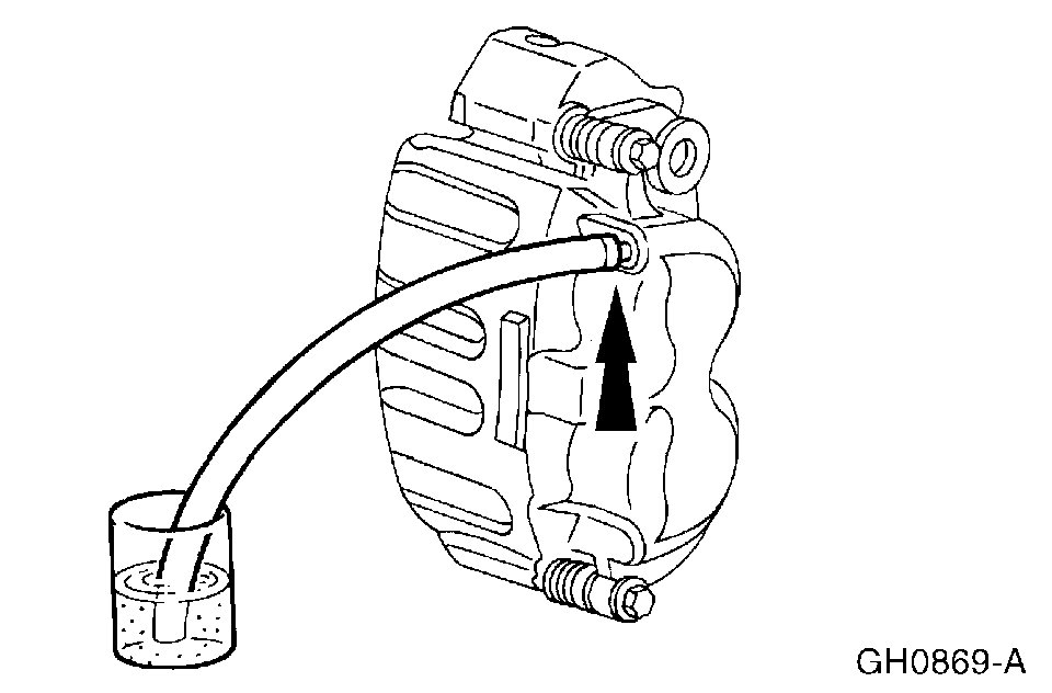

9. Place a box-end wrench on the RH front disc brake caliper bleeder screw. Attach a rubber drain tube to the RH front disc brake caliper bleeder screw, and submerge the free end of the tube in a container partially filled with clean brake fluid.
10. Have an assistant pump, and then hold firm pressure on, the brake pedal.
11. Loosen the RH front disc brake caliper bleeder screw until a stream of brake fluid comes out. While an assistant maintains pressure on the brake pedal, tighten the RH front disc brake caliper bleeder screw.
12. Tighten the RH front disc brake caliper bleeder screw.
13. Repeat Steps 9 through 12 for the LH front disc brake caliper bleeder screw.
2. NOTE: Master cylinder pressure bleeder adapter tools are available from various manufacturers of pressure bleeding equipment. Follow the instructions of the manufacturer when installing the adapter.
Install the bleeder adapter to the brake master cylinder reservoir, and attach the bleeder tank hose to the fitting on the adapter.
