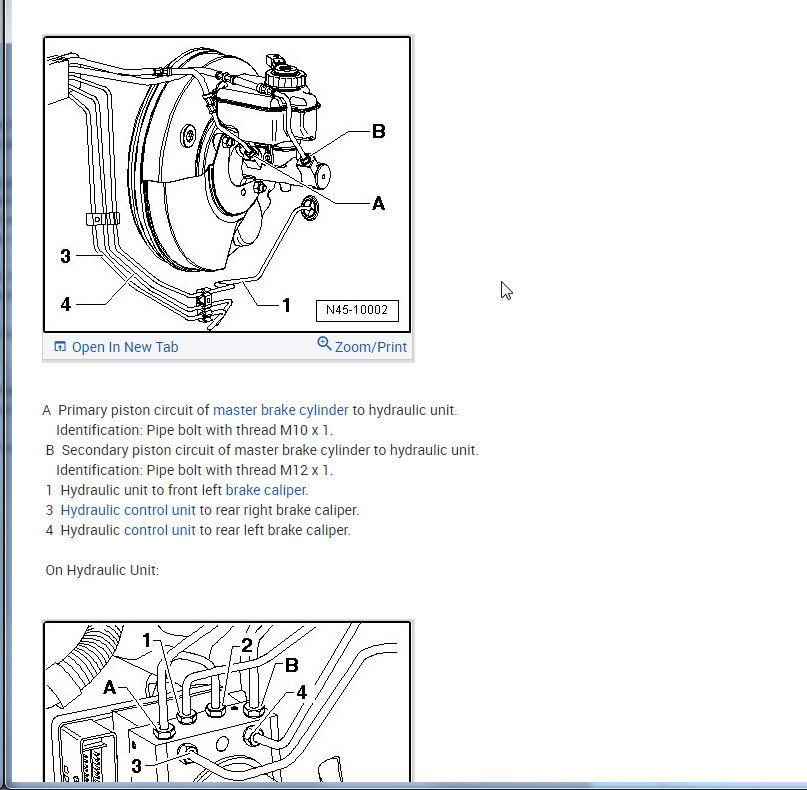

Was driving to work one morning when brake wear light came on decides to stop and investigate to find that front brake hose was leaking
Mar 18, 2020 at 3:29 AM
Here is a video that will help with this:
https://www.youtube.com/watch?v=xMS8Xy4Xz1U

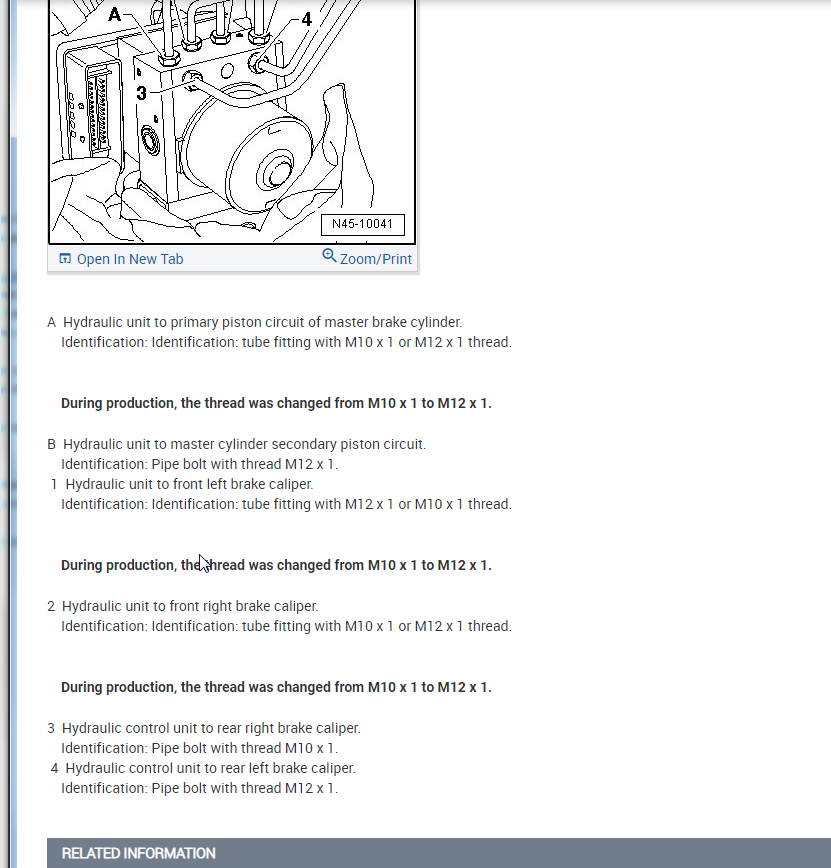

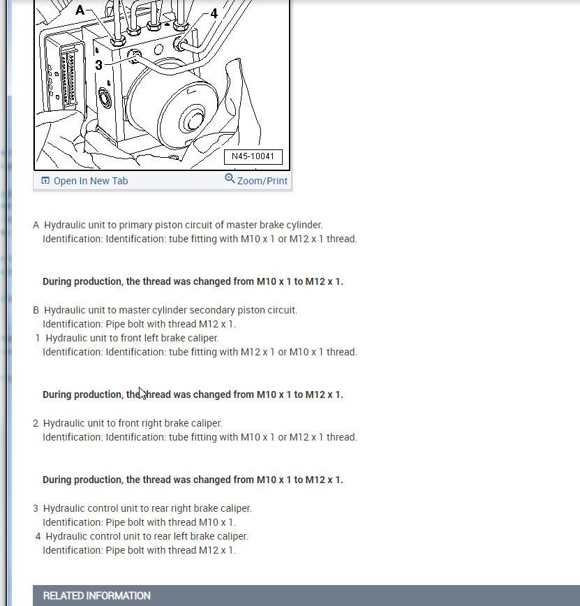

Plus below is the process from the manual that will help with this as well. Please let us know if you have other questions. Thanks
