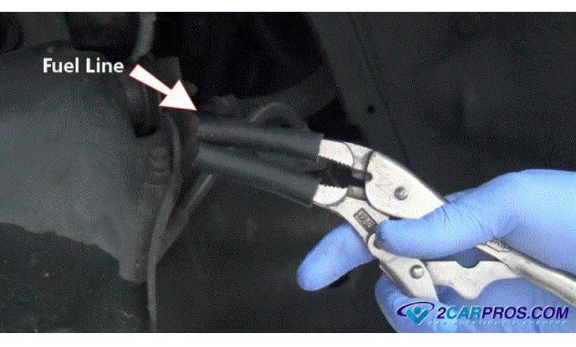

Let me know if that helps. Also, since the vehicle likely has ABS, make sure when you work on it not to allow the master cylinder to empty. If you look at the pic below, it shows needle nose pliers with fuel line over the jaws. Gently pinch the brake hose as shown to prevent brake fluid loss. If the system empties, you will need to perform an automated bleed on the ABS module which requires a scan tool that can communicate with the module.
Let me know how things turn out for you.
